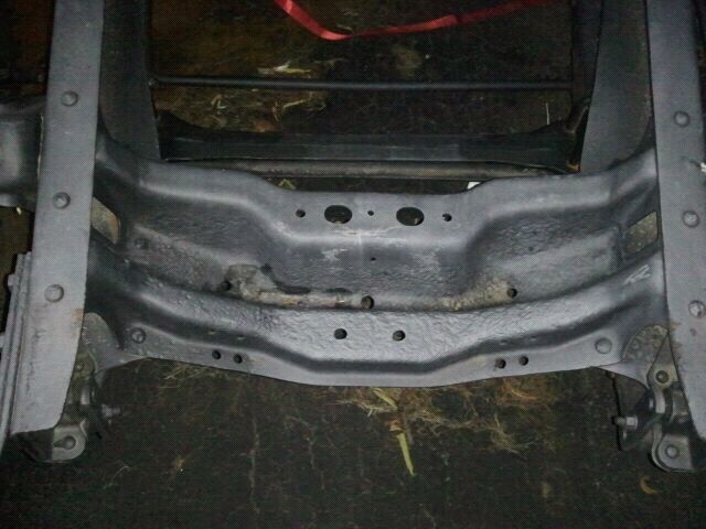

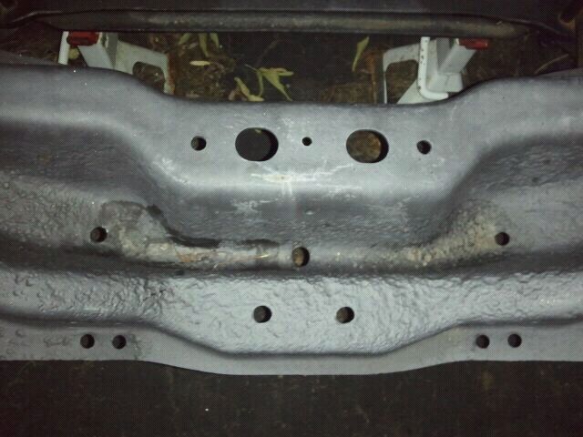

    OK Here is what I have one picture of the bottom of the radiator support, two pictures of the frame crossmember at the front of my truck. What have I got??????

    The first picture looks like a surround from some other vehicle. The u shaped bolt should go through from side rail to side rail, not front to back like the one you show seems to be set up for.
    I'll get pictures of mine tonight and show you how mine mounts.

    Hard to tell by the picture of your radiator support but, it looks like you have a Chevy radiator support & the GMC support is completely different.... they will not interchange.
    If you do not have the correct GMC support... you will be needing everthing that is GMC specific ....circled on the schematic.
    Here is the complete GMC radiator support assembly with the correct mount.

    Tom, you are absolutely correct. These pictures definitely show....I have the wrong support. So DeadZone I am sending a PM your way. Thanks guys!!!
