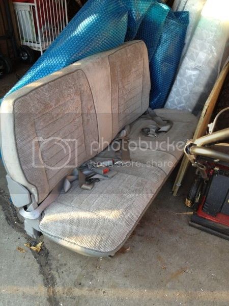

    The good news is that I can finally get rid of those 64 Impala SS bucket seats. The back rests are too thick and push me into the stearing wheel. Today I snagged a 1991 Astro van rear seat for $20 off craigs list. I know it will fit, its got a thin back that tilts, and the foam is in great shape. I think that once I upholster it I will have a really nice seat.

    Seats & SAFETY !!
    Looks nice , remember : some one wants to give you well over $100 each for those old SS chairs.....
    I suggest having your Trimmer replace the current foam with black foam from an Upholstery Supply house , it can be very thin , like 3/4" as black foam is really firm and makes the best vehicle seats .
    Also ,DO NOT use seat belts anchored to the seat frame ! they will KILL YOU :eek: .
    Always use seat belts anchored to the floor .

    Thanks Guys. I need to replace those seat belts anyways because they won't match the interior colors that I plan on using. When I put in new ones I'll get the ones that attach to the floor.
    Nate, thanks for the black foam tip. I was thinking of trying my hand at doing the upholstery myself. My mother in law used to do upholstery so if all else fails I'll have her do it.. All this is if I can find a sewing machine that can handle sewing leather and that isn't a ton of cash.

    Cool ! I say do it your self , the satisfaction of that will increase your driving pleasure....
    Anyways , Auto Trim Supply Houses don't carry the black firm foam ~ you'll have to look up " Upholstery Supply " in The Yellow Pages , it pays BIG TIME to shop around ~ the foam place in Burbank , Ca. on Burbank Blvd. , wanted more than three times what the other , smaller foam place in West LA wanted and , the WLA guy was happy to trim it to suit for me no charge....
    Vehicle seats that look and feel pillowy , do not give good support and over longer drives , tend to bunch up and sort of pinch your skin , right where it hurts the most .
    A super firm seat will always be more comfortable the longer you're sitting in it .
    You can also make the bottom edge of the back rest slightly wider for better Lumbar Support .

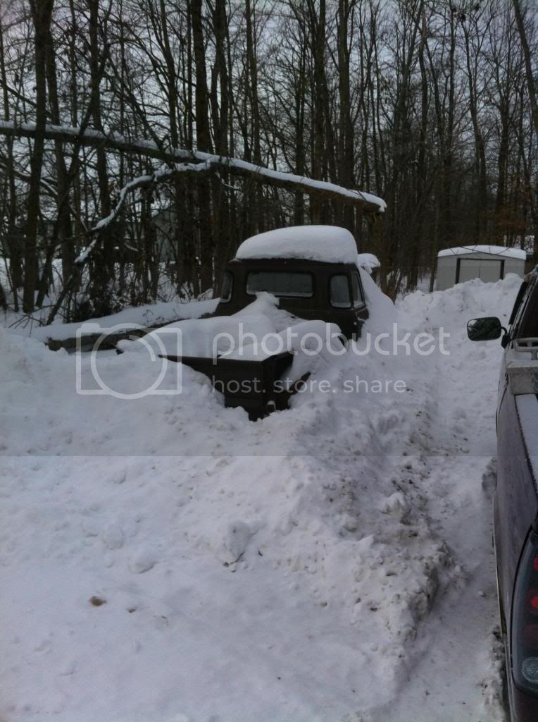

    Well, the weather has not cooperated with getting my truck drug home. Repeated snow storms buried it and then my dad finished the job with his plow. Haha

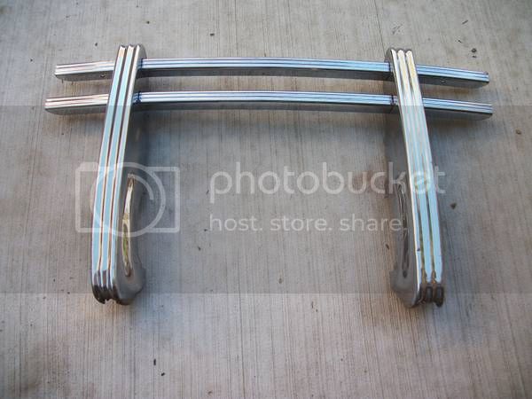

    The truck is still buried up to the roof in snow but that didn't stop me from going parts hunting. Made a good haul today but the best score was this grill guard for only $50. Pretty stoked about it and I can't wait to get it on the truck.
    I'm hoping to start the real progress once the snow melts but until then I'll settle for the thrill of the hunt.

    THAT is AWESOME!!!!! Lucky you!!!
  19. Bill Hanlon
    2,791
    Morris Ranch TX
    Don't wait. Mount it on the Ninja!
