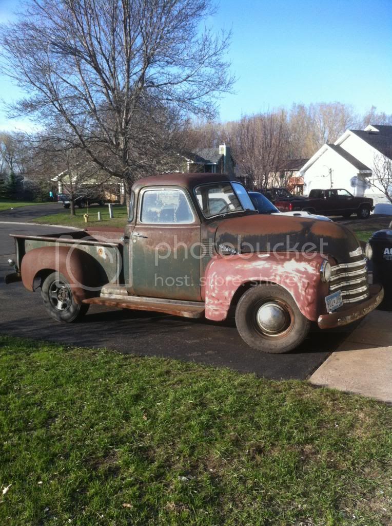

At long last she is home. What an eventful trip though. I had to borrow a truck since my ranger doesn't have enough power (4cyl) to tow the 50' 200 miles. Like always the truck fought me every step of the way. It started with the sediment bowl leaking so I couldn't get the truck to start. Lucky for me I had ordered a new gasket this winter from classic parts. Unlucky for me I think someone may have swapped fuel pumps at some point because the gasket was too small. I had to make a temporary gasket with some cork. It worked! Well I had cranked it for a while to try and start before I found the fuel leak and since she hadn't run since October the battery was dead. A quick pull start and she was purring like a kitten and just sat there and idled.

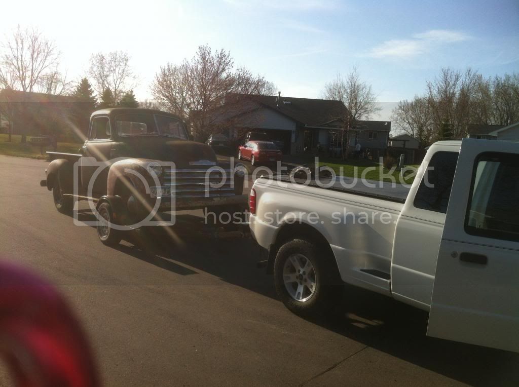

I drove it up on the trailer. I only have a tow dolly so the rear wheels were on the ground. Went 5 miles and luckily I stopped for a burger before I hit the long road and I saw the trailer tire was almost flat. Found some free air at a gas station and on I went. Then things got hairy.....
I forgot one major thing. The 50' has no steering lock like my newer cars. I went around a corner and as the wheels turned the truck almost came off the trailer. She threw one of the wheel straps (the kind that goes over the wheel like a net) and that wheel was almost off the trailer. THANK GOD FOR SAFETY CHAINS!!!! I got her back on the trailer and used some ratchet straps to tie the steering wheel to both doors and now it wouldn't turn. From there on out it was smooth sailing. When I got home it fired right up and drove off the trailer and into my drive way.
Now I need some better tires and to square away the wiring and I can drive! My goal is to be ready for back to the 50's!

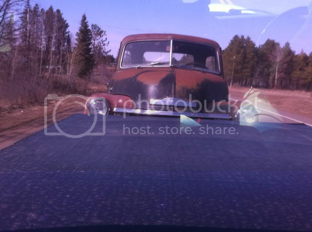

My wife snagged this pic of it being towed behind us.

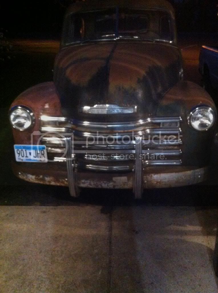

Minor work got done tonight. After fighting the rusty bolts off with PB blaster and then some heat I was about to mount my grill guard. Its a minor accomplishment but it felt good to do something on the truck. It was dark outside so it didn't look like it stood out but I hope it looks better in the light. And yes it is crooked. The truck was hit in the passenger front side so the bumper brackets are twisted. If the bumper was straight then the grill guard would be too.

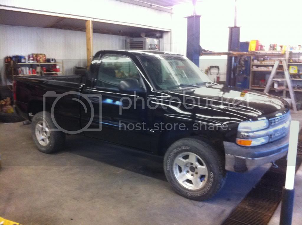

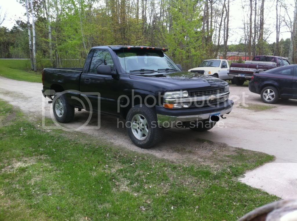

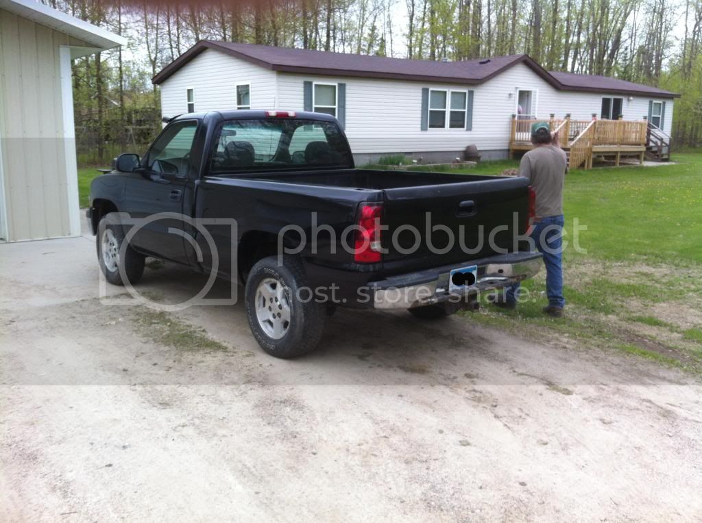

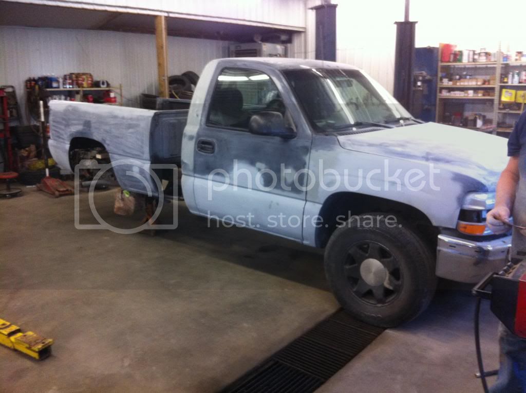

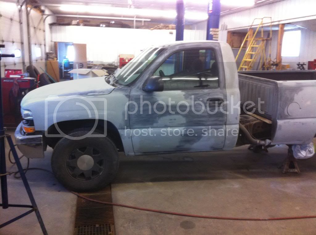

Last summer my dad needed a new truck to haul things and do a lot of parts runs for his auto repair shop. I ended up picking up a 2000 Silverado for $1800 for him. Its only a v6 but it is still a 4x4 and get about 20 mpg so its perfect for the job. The big problem was that it had more dents than a golf ball thanks to a rough life as a landscaper's truck and the rockers were rusted out. It took a lot of work and a new box but my dad did a great job on the body work over the winter. This weekend I helped him finish the job.
Where the weekend started. Prepping for sealer.
And here is some with color and most of the assembly done.(Notice the nicer rims. They came off an 06 but look way better than the black ones.)

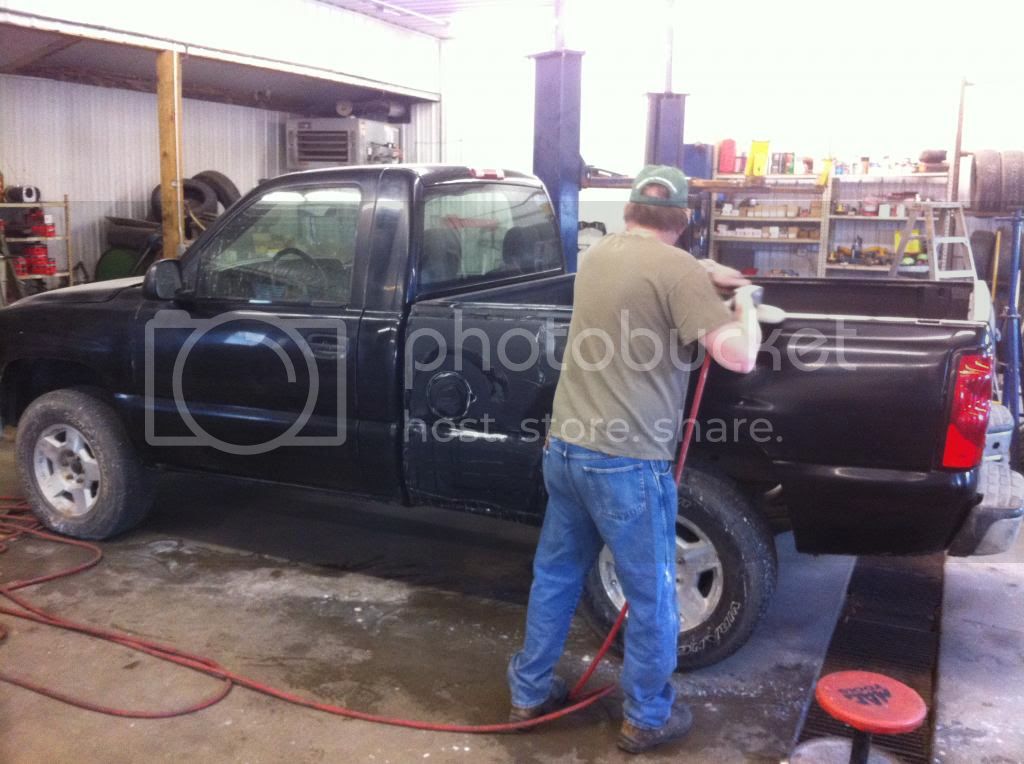

There was a little too much orange peal so I did the wet sanding and my dad followed me with the buffer.

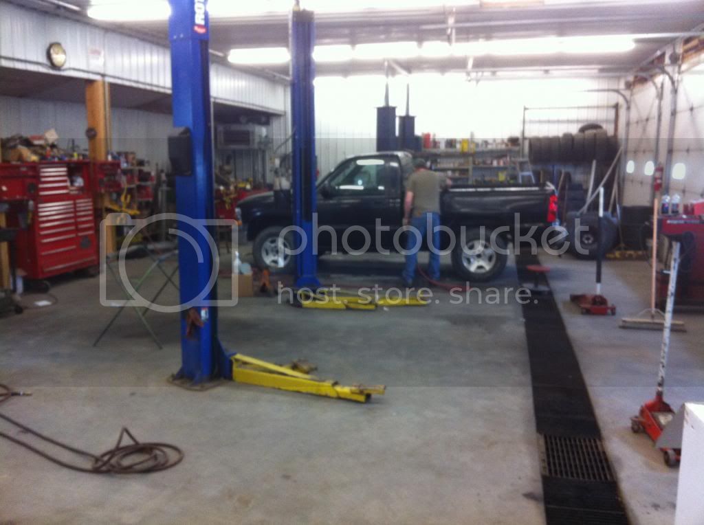

And a nice shot of the shop.
Home and finished. We were pleased.
