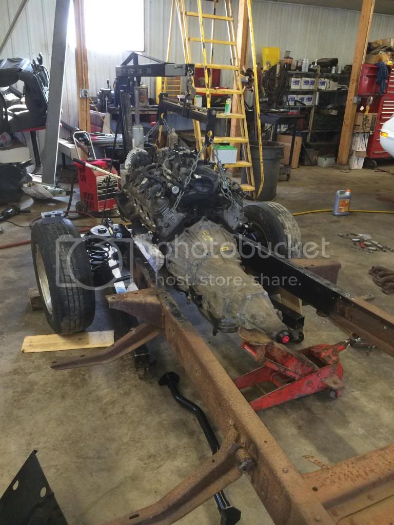

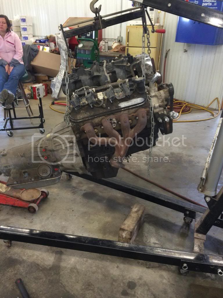

    This weekend was a mile stone. The 5.3LS and 4l60e found its home between the frame rails! I used the dirty dingo adjustable mounts to give me the ability to fine tune the engine placement when the body goes on. For now I used a measurements for the firewall from the assembly manual, a new floor pan, and the core support to get in the ballpark. I have over and inch adjustment front and back so I should be fine. I am going to have to make a little clearance in the boxing plates for the bottom flange on my corvette exhaust manifolds to get them to fit.
    I'll be back able to work on it in about 2 weeks. I plan to finish the tranny cross member and do a compression test on the engine. After that is complete disassembly for finish welding, sand blasting, and painting.

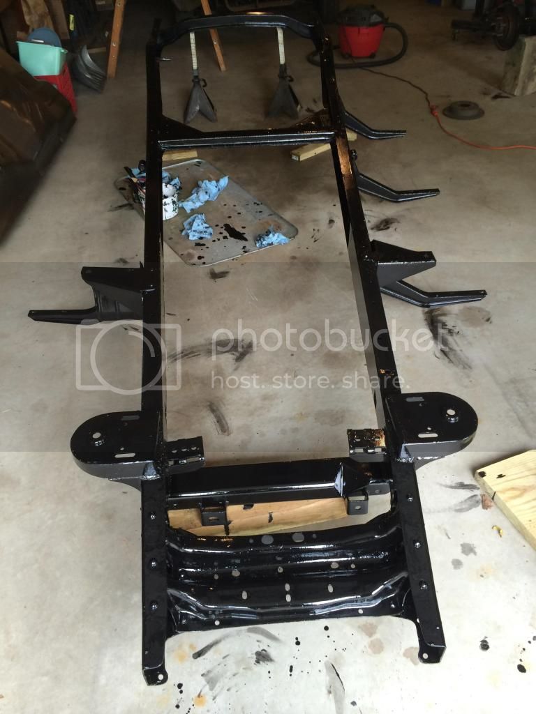

    Progress has been slow but I'm back on track. 7 weeks ago I had my first child. My little girl has been great but it took a while to be able to get up north to work on my project.
    For those of you just joining... I have been building an extra chassis so that my truck didn't have to be torn apart as long and I'll just swap the body later.

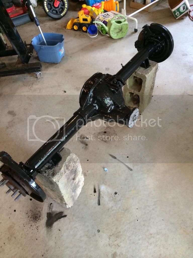

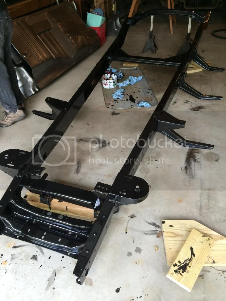

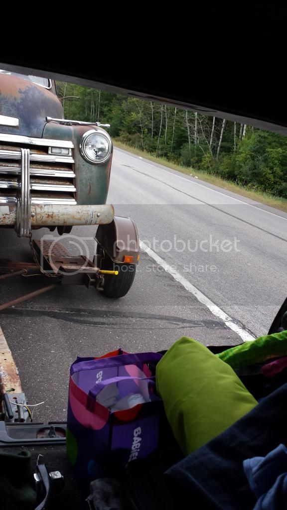

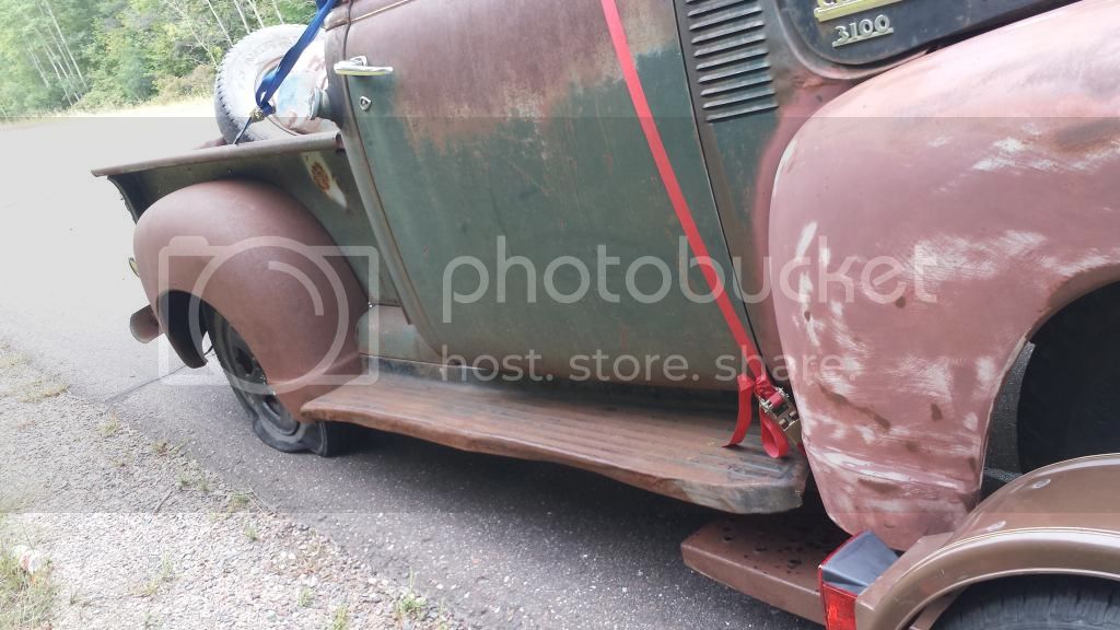

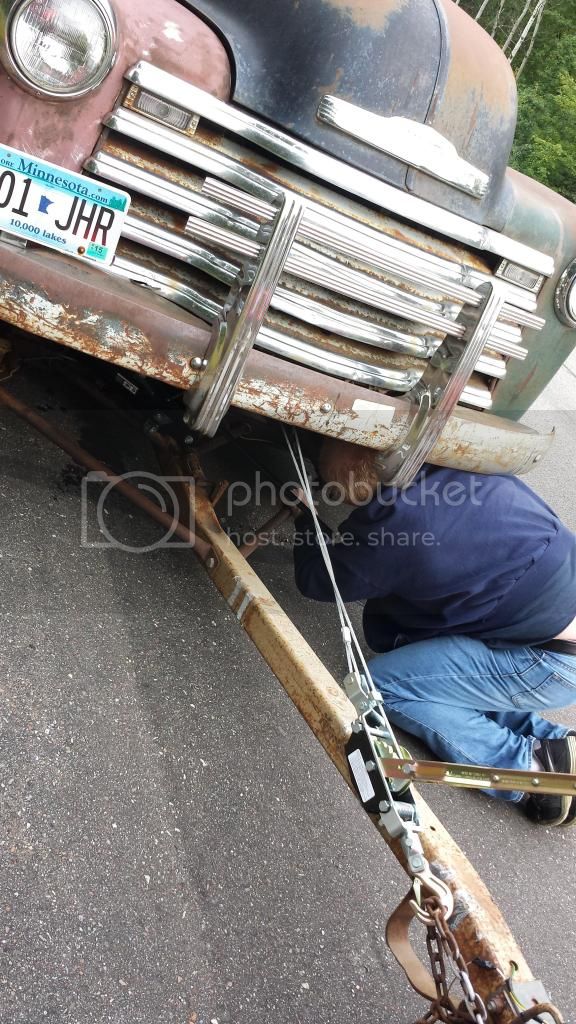

    Anyhow, I loaded up my truck to head up north because my modified chassis had just came back from the sand blasters. My daily driver (a 2000 GMC jimmy) barely had the balls to haul the truck/trailer but it got the job done. Unfortunately I got a flat on my 1950 chevy and had no spare. I have one of those 2 wheel tow dollys so it took two hours to swap a tire from the front to the back and put the flat on the front. Here are some pics of my misery.
    We finally made it and I got to start painting the frame and rear end. I have some more parts to paint next time I go up there again but I'm happy with the progress so far. Once I paint the suspension parts I can bolt them back on. My motor is currently getting built so I am happy with where I am at. Here are some pics of the frame. (I used KBC coating its similar to POR15)
    Yes I am missing some running board brackets but I'll snag those off my other frame.
