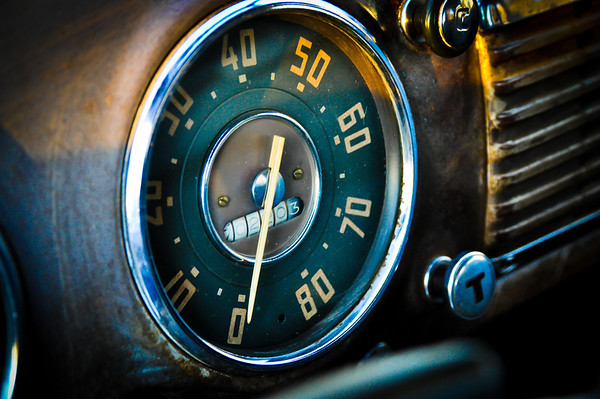

    Really happy my stockers are 100% functional!!

    They do look better than aftermkt coach529!

  15. Zig
    Another outstanding photo! Love the lighting!
  16. Coach529
    Coach529 Member
    Oct 2, 2012
    585
    Jamestown, ND
    Thank you!
  17. vwnate1
    11,643
    Outstanding Photo
    It really is ~ in fact , this is Calendar materiel .
    Keep up the good works .
