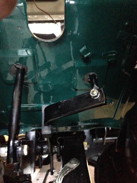

    Currently working on pedals through the firewall. Why would the pedals not align centered in their holes in the floor, left to right?
    Finally worked it out with washers between the pedals on the pedal shaft. The washers are called "industrial washers". They are thinner and the ratio between the inner and outer sections is much less than an standard fastener washer.

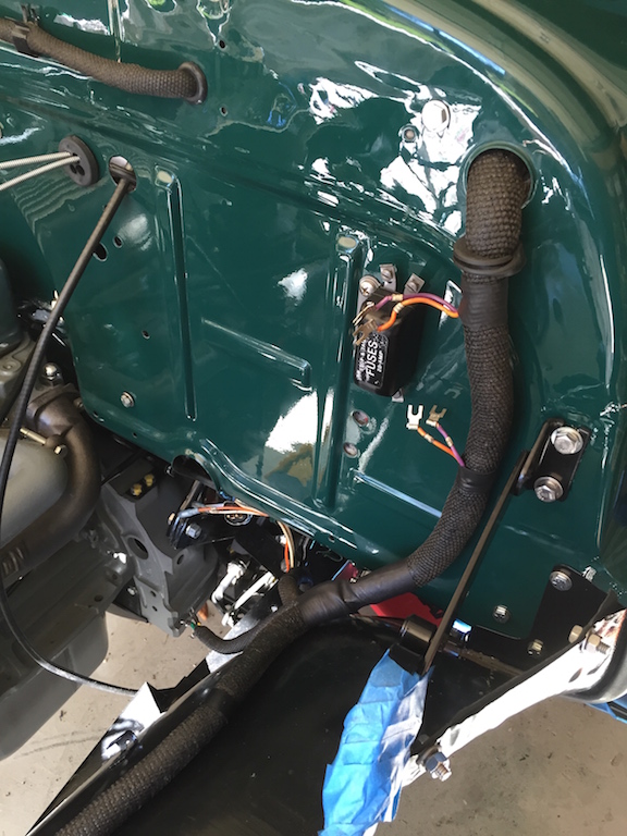

    Back at it again. Almost done with the wiring.
    I decided to cover the new wiring harness that was wrapped in plastic electrical tape in a fabric loom. I used heat shrink tubing to close off the ends.

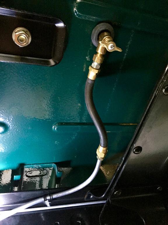

    I installed the fuel tank, lines and electricals to the sending unit.
    Following Nate's and other's advice, I put this fuel shut-off under the tank this week.

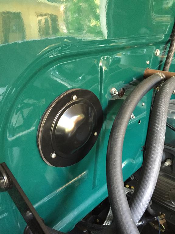

    interior heater motor cover
    Here's another little project on the truck that ended up quite good, but threw me for months ... The interior heater motor end that protrudes through the firewall.
    After rebuilding the heater assembly and replacing the motor, I spent a lot of time looking at pictures and saw that a seal secures and locates it typically. After seeing all the moisture/water damage from weak seals from the firewall I decided to try and completely cover the end of the motor. (Much easier said than done)

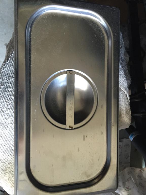

    I looked for months to find a piece of metal I could form and shape. After many failed attempts I stumbled across a piece of restaurant equipment that caught my eye. Here's what I started with:

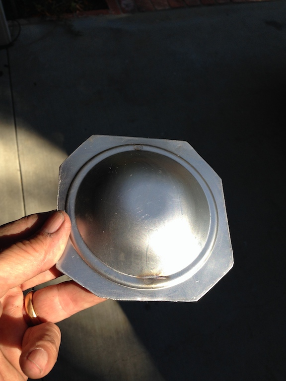

    I then had to "work on it":
    I then keep working the edges to be round, then cleaned it up and had it powder coated at a friends place. Next because I didn't have enough clearance from the firewall to the cover, I bought a piece of 1/4" thick rubber. Perfect! Cut it out to match the cover.
    And finally, here it is installed. I think it looks great!
