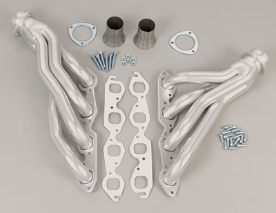

These are Hedman as listed at Summit Racing
Val

With the motor forward, shortie street rod headers will not work, ( ask me how I know ! :o ) Most of those style headers have the collector tube coming straight down and pitch out slightly. That places it way too close to the front crossmember and the control arms.
The 3/4 Camaro header worked perfect for me allowing my exhaust to be tucked up above the frame rail.
Val
