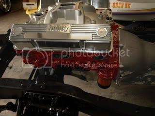

    I'm doing a frame off on a 65, decided on a 350 with a 700R Trans & 2500 stall.
    I got this far and at last minute .... I changed my mind :confused:
    Now I just finished my new BBC 402 it's 30 over
    Should be right at 10.1 compression
    TRW Forged pistons...L2328F30.....319 dome
    Special grind, Comp Cam....Hydraulic Roller
    235/240 @ 50 Duration
    570/578....Lift
    820 Oval port heads 112cc
    Edelbrock Performer Intake
    850 Holley Double Pumper
    But good luck on what ever route ya go !!!!!!!!!!
