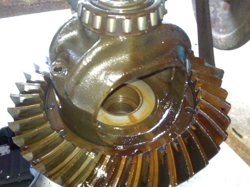

I found a 48 rearend on craigslist and bought it. I took it apart and have one question. Is this the "carrier assembly".The part that the ring gear is attached too?
This is the "carrier assembly" aka spool. I called Patrick's and he confirmed. It has casting # 3652336 on the bolt head side.
