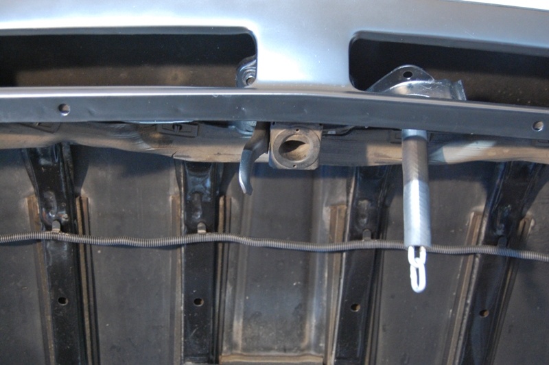

Here?s one way to prevent it. Also keeps anybody from walking off with the battery. It?s pretty simple and cheap. Just pop the hood and there's enough slack to lock or unlock. The bracket has a 90 degree bend that attaches under the nearest striker bolt, which is a 2" long Allen button head with a nyloc nut. If someone wanted to unbolt it they'd be there for a while:
That happened to me on my 65 once before I painted it. that really sucks when it happens, sure wakes you up fast. Sorry to hear it happened to you. The fix picture is a good one.

That's a neat fix Markeb01, I will be installing that one for peace of mind.
