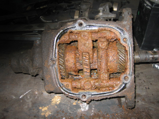

    We did a 40 Pontiac coupe that had never been near a lake but had set in the garage of a high dollar home in Plano for 40 years. Here's what the tranny looked like when we popped it open. Have seen rear ends that everything above the lube is a ball of rust and everything submerged looks factory fresh. Don't have a clue.
  16. vwnate1
    11,643
    The Answer :
    There has to be a confluence of ferrous metal , water and oxygen ~ the <magic> triangle ~ if the parts are submerged in oil , they won't rust .
    If they're submerged in water , they rust very slowly .
    If there's water half filling the tranny (see above) it all goes to heck fairly quickly .
    I've rebuilt a few 1940's English Moto gearboxes that were pretty bad , we got bearings and bushings but no gears were available so it was pretty noisy when finished .

    Looks like that thing was used as a boat anchor..... if not... it will make a good one.
