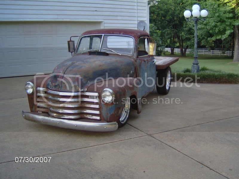

    What backspacing did you use on your wheels? Looks great! I'm planning on doing this swap very soon. Thanks!!
  4. Flipper
    Flipper Member
    Oct 17, 2005
    133
    Mine are 20x8.5 wheels with 5.5 back spacing. They tuck way under the fenders...but I like it that way. I can turn almost lock to lock without rubbing.
    It looks a little funny straight on, but with the bumper on and set down low, you really don't see much of the tires.
  5. coilover
    coilover Member
    Mar 30, 2005
    2,564
    Plano US
    Here is the stock S10 front and rear wheel position with a 2wd rear end; 4wd rear added later. (Also note the turn signals). The first S10 swap we did was before there were after market parts so there is also a pic of a mock-up spacer on the front hub/rotor to get the tire back to it's regular AD position. Note the exotic material used and the skilled machine work. It is 1 1/2" + 3/4"....2 1/4" total so the 2 1/2" spacer is dead on. Are the big truck fenders physically larger than the 1/2 ton? If so, they would be the ticket for one dropped into the weeds because there would be extra tire room.

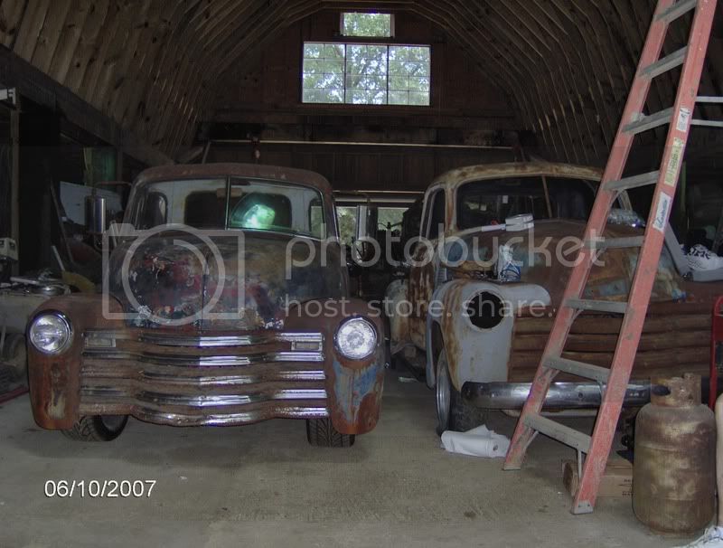

    Flipper your truck is kool I like it, pic two is the better one. The flat bed, and mirror kool look.
    Well that seem true about most year of the GMC I think that why it nice to see a few good ones and to luck out now and then with a part truck or parts some place.
