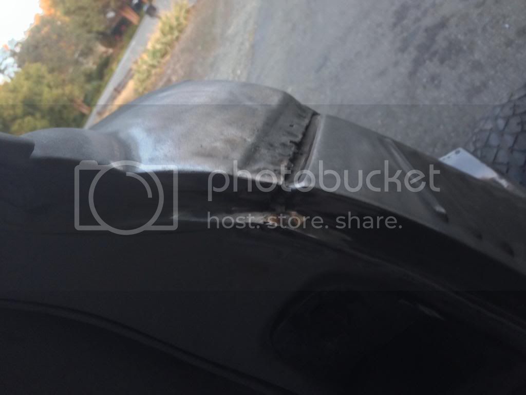

    Does anyone have any pictures of how they welded the new piece to the existing metal where the lead use to be? Also pictures of how they bondo it?
    Having a heck of time trying to figure out how to weld it and what to do with bondo. Just don't want to have a ton of bondo on my truck!

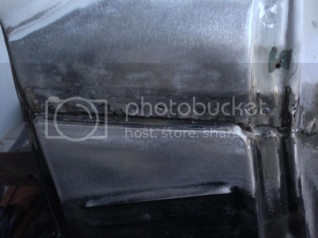

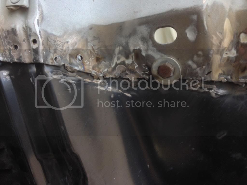

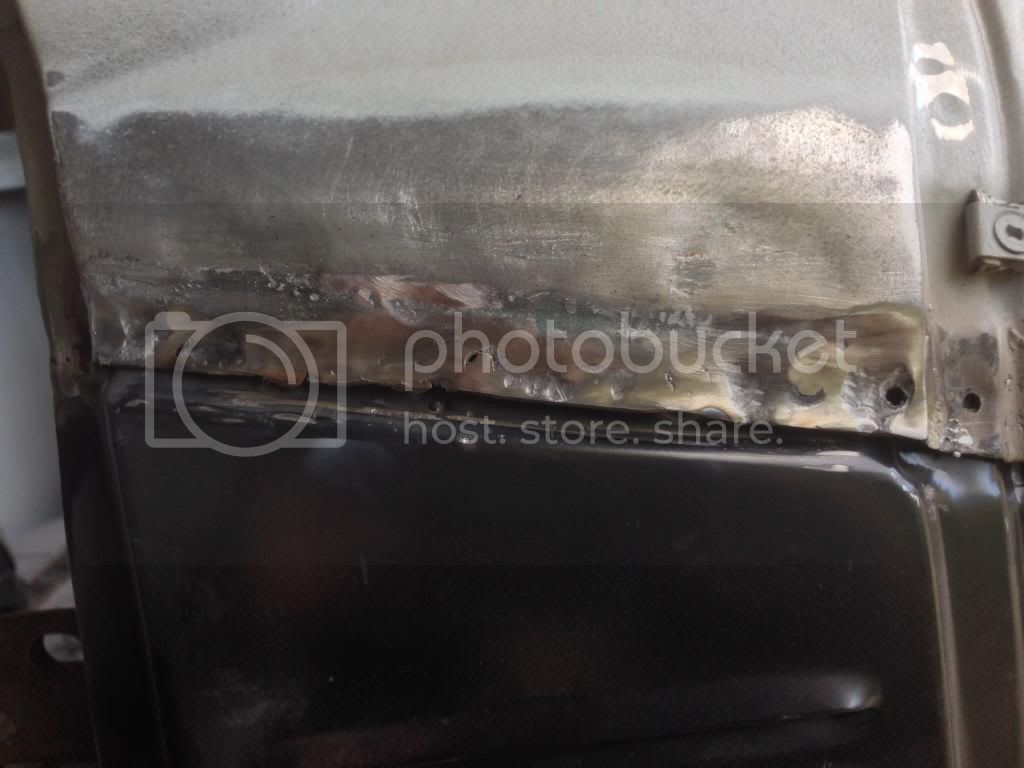

    So I decided to go for it it's welded now. My question is now do I bondo or would it be better to do a fiberglass filler first sand it smooth then go over with bondo?
    OR should I fill the gap in with weld or a small metal to patch so there won't be so much to fill?. HELP,,,PLEASE,, lol

    You removed lead. Use lead instead of bondo or any other filler for that matter. Don't know how to use lead? Find someone that does, or learn. It's a lot easier that what you've accomplished so far.

    If you want to do it right, use tin/lead, as was used by the manufacturer.
    Don?t let people frighten you too much, when talking about tin/lead.
    As long as you don?t use this technique 8 hours/7 days a week year round, it won?t hurt your health. Look for a well ventilated area and wash your hands after the job and you?ll be fine!
    Whenever i do a restoration on a vintage car/truck i use lead to fill gaps like that. Properly done, this will last nearly forever.
    Look on youtube to find some hints, and yes this is still used today, though not as popular as bondo...
