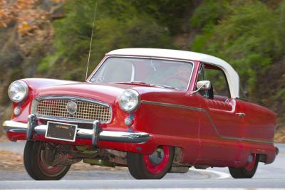

    Small picture of Nate's Metro

    I don't think the passenger side tire is really trying~

    Speedy Met
    LOL ! no , the inner front tire usually lifts off the ground when I'm cornering hard ~ that was the World Famous Mulholland Drive Loop , I was going just shy of 65 MPH as there was a dufus in a freshly restored MGB 100 Roadster in front of me who was afraid to let it out or something else I'd been really moving .
    It has the original 1500 C.C. 'B' series BMC engine with a modified MGA 1622 cylinder head on it , coupled to a Borg Warner M-35 Slushbox from a 1979 Datsun B210 , an a 3.72 final drive pumpkin from a 1979 MG Midget , the only year that ratio was fitted to North American MG's making it hard to find .
    I was able to stuff some Michelin 165SR13" Defender radials under the rear , the front is so close I have 145's under there else they'll rub ~ a bad thing indeed .
    The Sports Car guys I run with , all love this car as it keeps up very well .
    Sadly I keep breaking wheels in it though and nearly flew off a mountain last summer..... :mad: .
