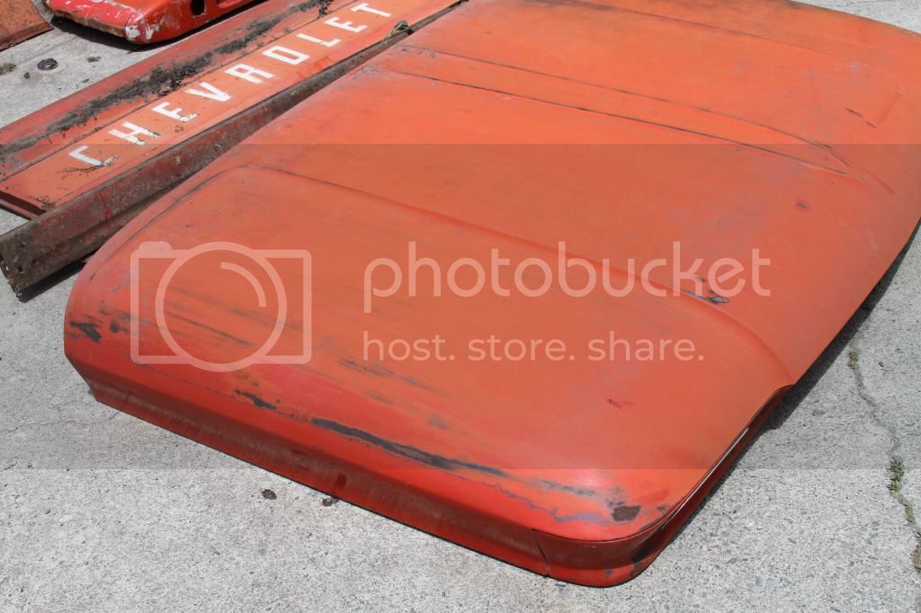

    great build! Just picked up and original paint '66. Pretty darn close :)
    I'm going to need to blend/match some areas on the short bed side panels and will use some of your ideas. Thanks!
