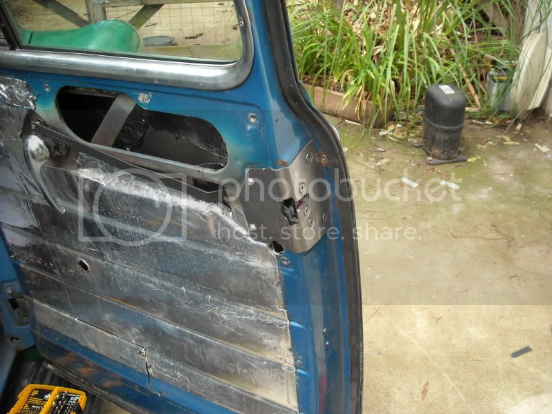

    I'm trying to get the old door latches out and am having trouble taking them out.
    Do I have to completely dis-assemble the entire door, window and window track?
    I tried to take apart the whole door but the glass doesn't want to come out, and the door latch is hitting the window track but I can't get that out either.. Any suggestions?
  4. ol' chebby
    3,167
    Raise the window, take the 2 small screwsin the lower door sill to loosen the window track. Pull it out of the way and rotate the latch out.

    By the way ~ after you've wrestled those window channel run screws out , you have to lift it 1/2" or so as it's hooked in at the top , once it's 1/2" up you should be able to twist / wriggle it out easily .

    Are the two screws under the window jam that screw from the window track to the metal door the ones that I have to loosen so I can wiggle the door latch outta there?
  8. ol' chebby
    3,167
    They are midway down the door jamb below the latch.
    The 2 nearly vertical screws midway down the jamb...

    Thanks for the clarification!
