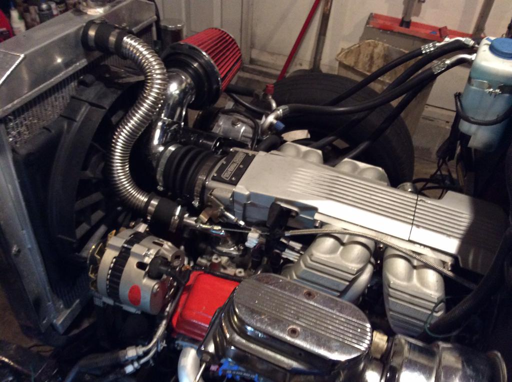

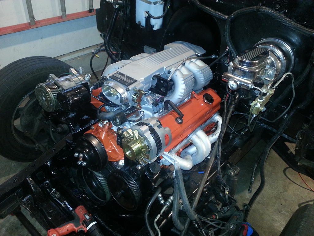

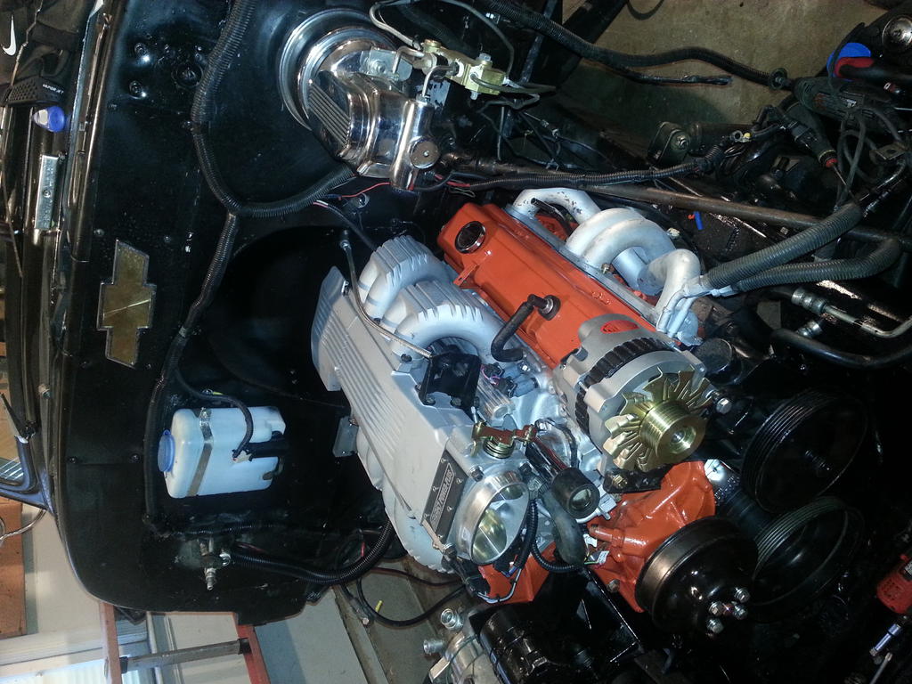

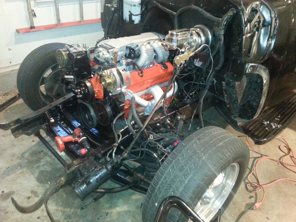

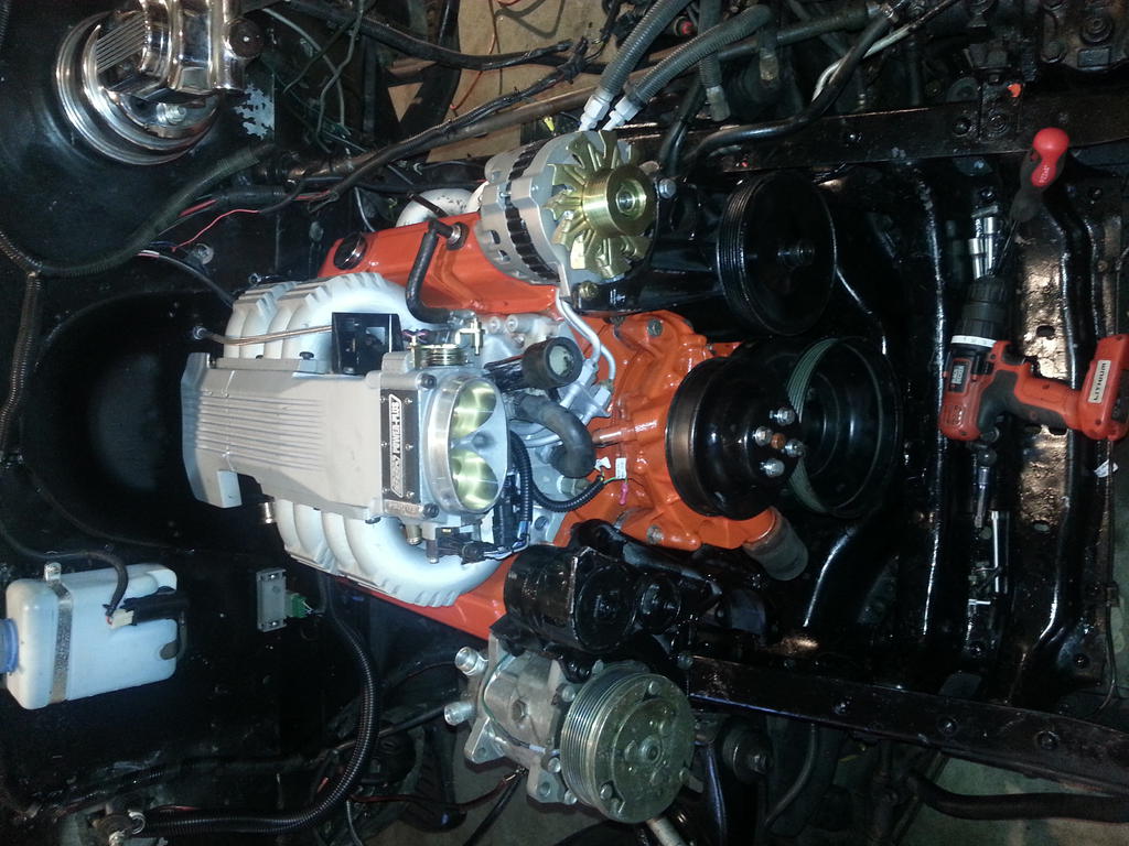

    I'm kinda feeling the orange covers. Besides, from what I've heard, from others who've bought crate engines, they damaged them taking them off because they use some kinda crazy strong glue and it's hard to get them off. Plus, the cost of having them chromed would be ridiculous!

    Your right, orange is good.
    Looks balanced with just the right amount of alum. and Chevy orange.
    Looking good, Robert.

    Tpi=torque
    The TPI setup should give you a nice fat torque curve down low where you use it everyday. IIRC, the total runner length is 22" (you sure don't get that out of a conventional intake). If those runners are siamesed (looks like they are) you get better high-RPM performance, while still retaining fat torque down low. Win-Win!
    We'll still need to see that smoky burnout.

    Looking good as is Robert. Maybe add some period correct decals for a retro contrast to the fuel injection?

    I like those orange covers as well. Looks like one clean beautiful engine. I would drive around in that!!!
