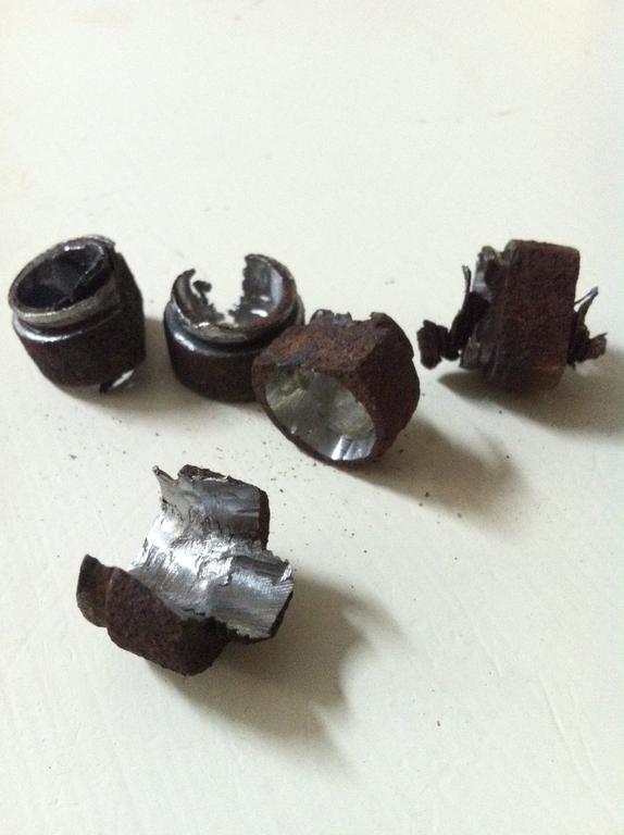

    After drilling out each of the 5 frozen driver's door bolts, I then used a drill bit to enlarge the holes in the spinning cage nuts. I then used a punch and whacked those suckers out. I used a magnet to fish them out the lower drain hole.
    Now to find the correct nutserts and I will be back in business. WHAT A PAIN!

    Installed nutserts or rivet nuts and with a few tweaks worked great.
    Since I didn't have a nutsert tool to lock them down, I used JBWeld around the collar and ridges to secure them, then after 24 hours seated them using a door bolt and a washer.

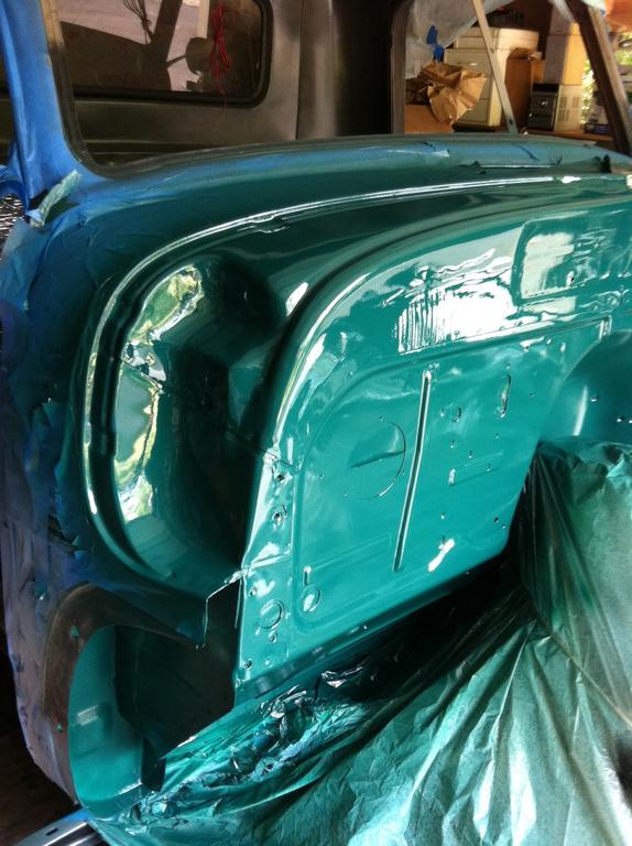

    Finally getting getting to the jobs needed to be done. Finished using POR15 on the cab and firewall. Close to starting reassembly!
