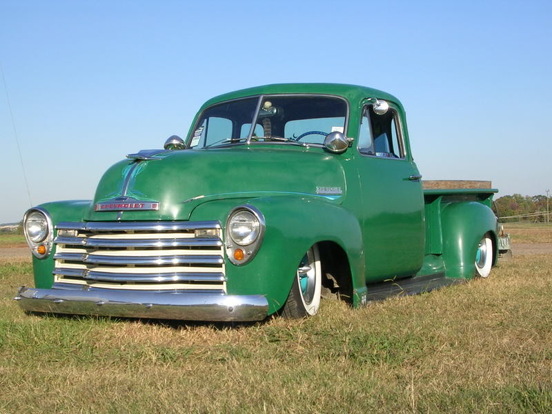

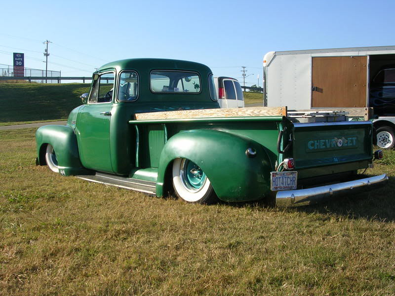

  2. ol' chebby
    3,167
    At Goodguys today...

  7. ol' chebby
    3,167
    Actually, the fab work was minimal. I first boxed the rear of the frame, gthen centered up the carriage that the rear end rides on. I marked and cut the rear of the carriage to fit snug inside the boxed frame. I leveled the input shaft, checked the measurements again, then tacked the rear portion. Next, I cut 2x3 rectangle tubing to locate the front mounts. After checkng again, I welded solid all mounts. The 2x3 is welded to the inside frame rails. Next I cut boxing plates for the front frame section to fit around the 2x3 mounts. I made 2x2 spans to cover the gap over the upper control arms, which makes the whole thing stronger, and gives me mounts for the airbags. now plate and weld everything solid, air it up and go do a nasty burnout.
