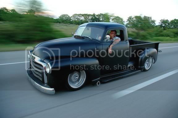

  8. Raz76
    Raz76 Member
    May 14, 2012
    108
    -okc-
    Ive been driving lowered vehicles since I was in high school and that's over 20 years. I don't have any issues driving a lowered car/truck. Ive had some that were an inch off the ground. If people like to restore these beauties, that fine, I don't. Im not building this truck to haul stuff with it. It will look like this when I'm done and it will be driven everywhere.

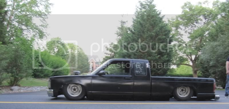

  13. SkeeterBilt
    SkeeterBilt Member
    Aug 10, 2012
    283
    Sierra Vista, AZ
    RAZ that truck is awesome lookin, ive kinda moved on with "minitruckin" but this was my last large biuld
