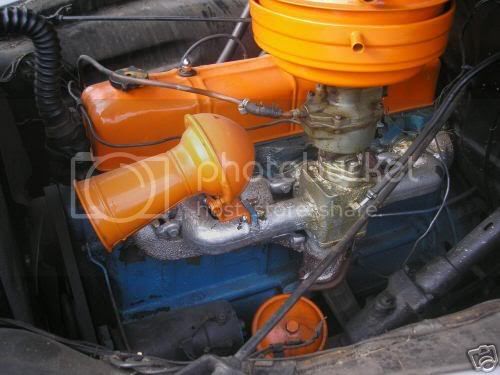

    yeah, like i said the guy i bought it from said he had some work done, but i've never messed with it. guess that'll be another thread, eh? and yeah, the oil lines are overkill, but they look pretty mean, eh? believe it or not i have some brand new ones from cp, but i couldn't find em in the mess of my garage when i was working on the truck, so NAPA came through with what you see there.

    NAPA miscl part number 4755 is an aftermarket spin-on filter mount I used on Thunder when I found a crack in my original canister. It uses a restricted flow spin on filter. I had the oil lines made at a local hydraulic hose shop (braided stainless).

    The restricted flow oil filter has a little bitty hole in it just like the canister filter it replaces. I am told that using a full flow filter wil result in loss of back pressure to the oil filter and will result in a significant loss of oil pressure.
    I trust the NAPA vendor in town, he is an old school parts guy.
    I would rather have full flow myself, but this takes some additional talented tinkering with the block and oil pump from what i have read.
    When found the crack in my canister, I had just gotten Thunder back on the street. I went to the spin on filter becasue I could get back on the street without waiting on time to find, clean-up and paint an old filter canister.
    It only leaked when pressured up on the highway, oiled everything with a fine mist under the hood.

    maybe when it breaks, I'll mess with it, but it works just as well as the by pass filter canister and is much less messy to service.

    ...Of Jon's oily engine , I see it has a passemnger car manifold on it.....
    Just funnin' ya Jon , no need to go hunting for more parts :D .

    yeah, i noticed that there's no where to mount my stock horn on the manifold. maybe i can rig up a bracket or something. i'm guessing this is how it's supposed to mount up??

    Pretty close ~ the bracket isn't supposed to have an 'S' bend in it .
    Someone oughta replace that oil filler cap with one with a hose barb and connect the air filter nipple to it.....
