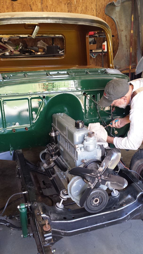

Time to put it back in the frame. Woohoo!
That's my brother giving me a hand. It was much easier having two people to get it into place.

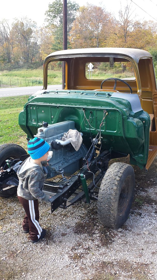

And of course the foreman had to check that we were doing things right

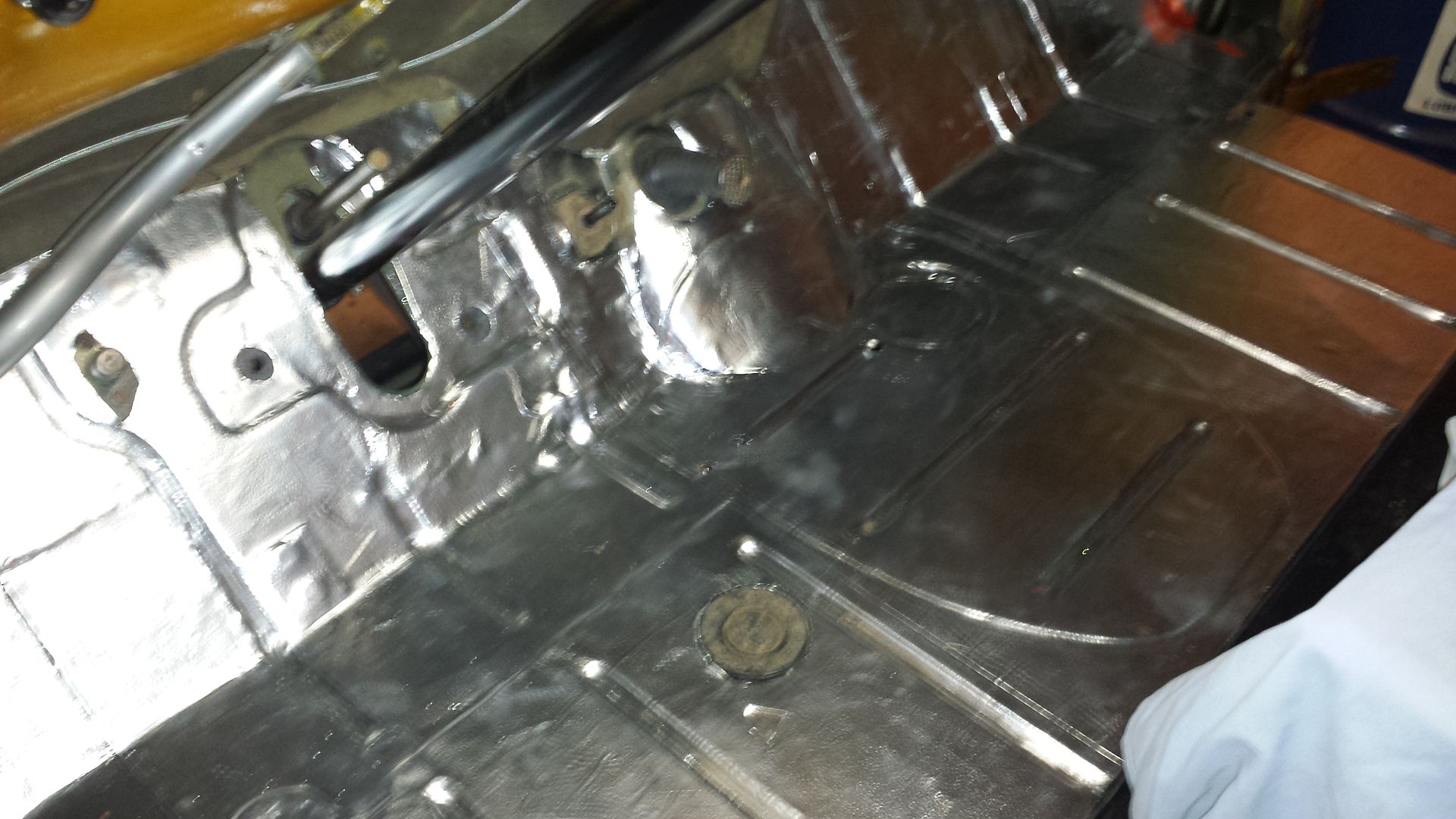

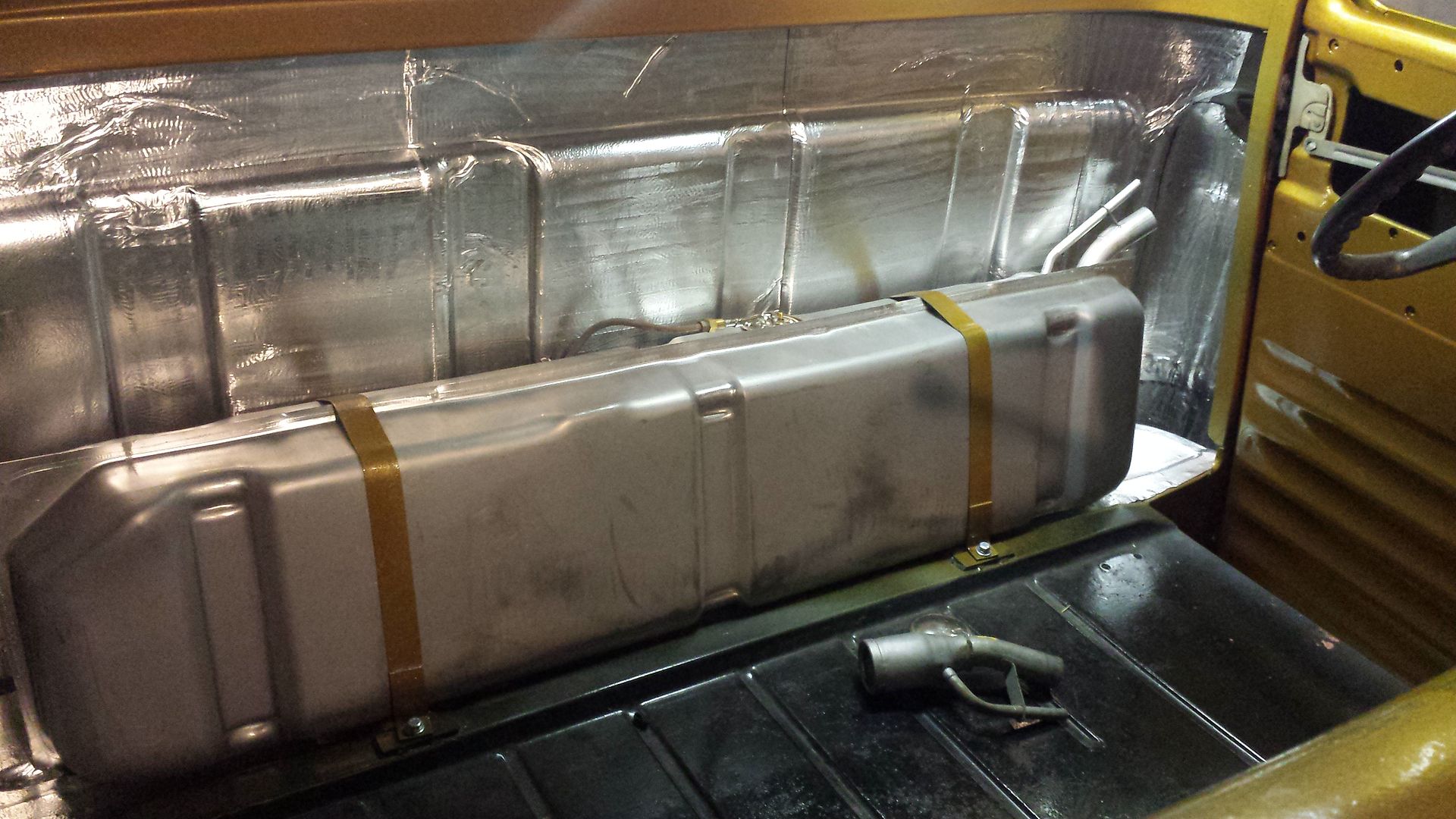

Got some sound deadner off of e-bay. Stuff went down easy and is super sticky.

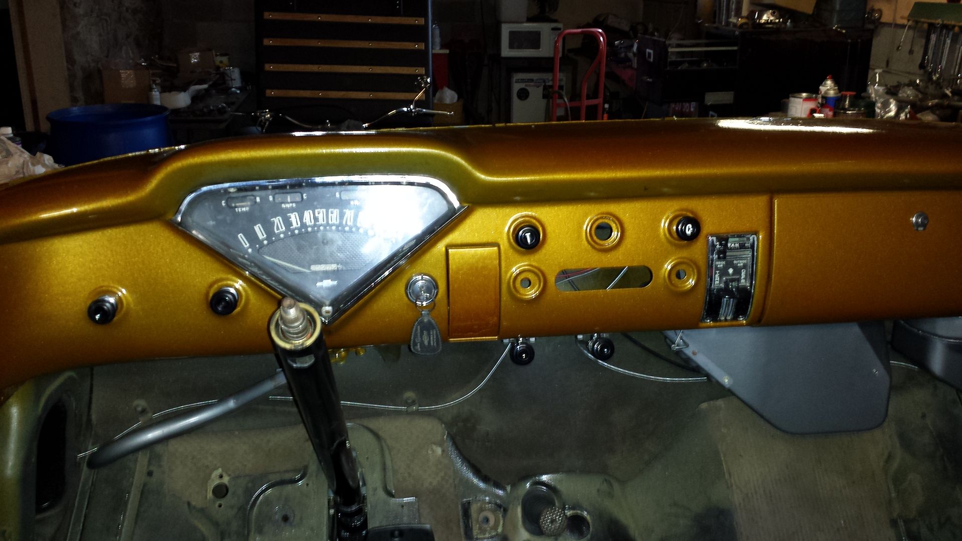

Forgot to mention that we put the steering column back in before reinstalling the motor. Dash looking good with more stuff in there.

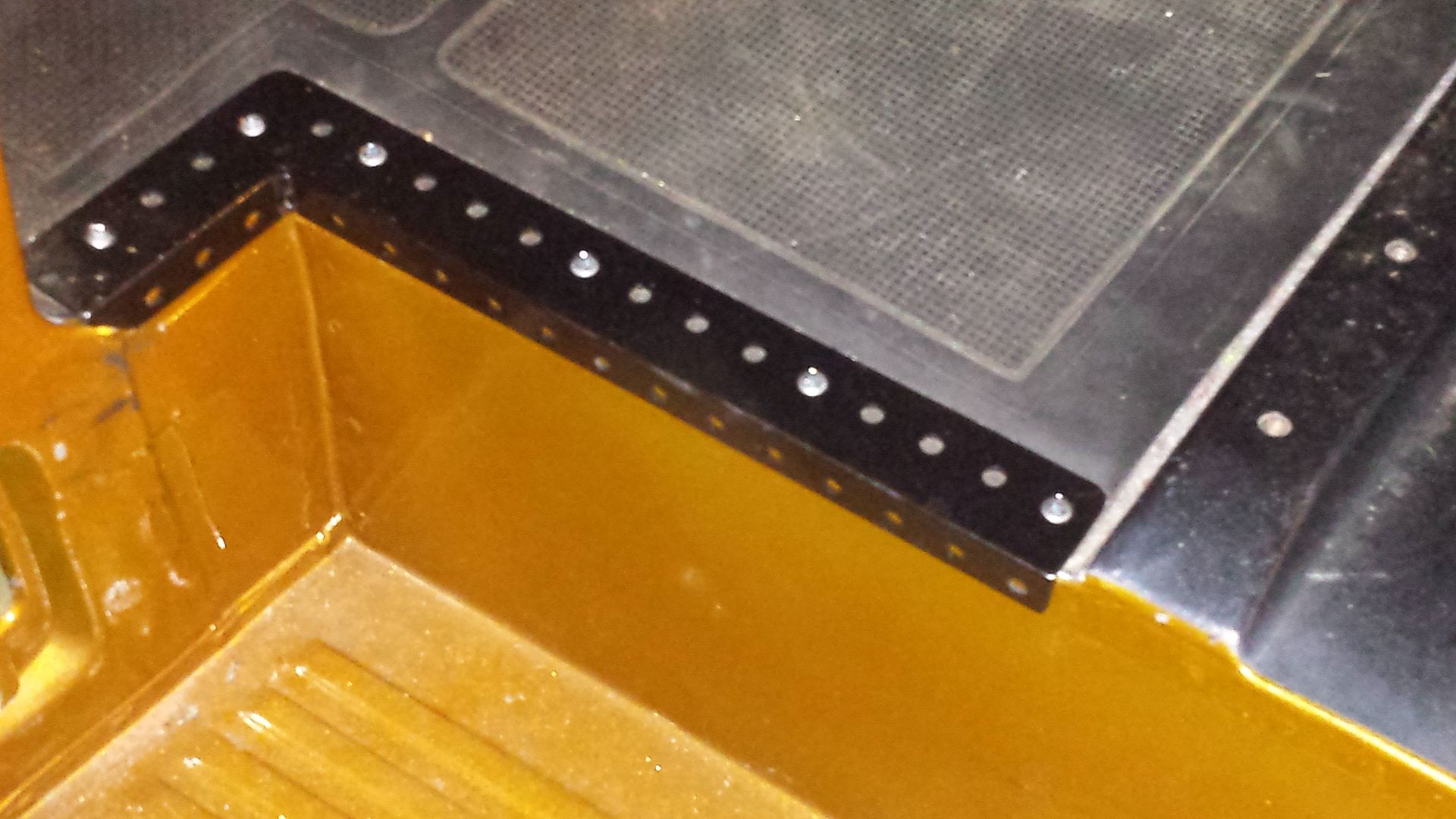

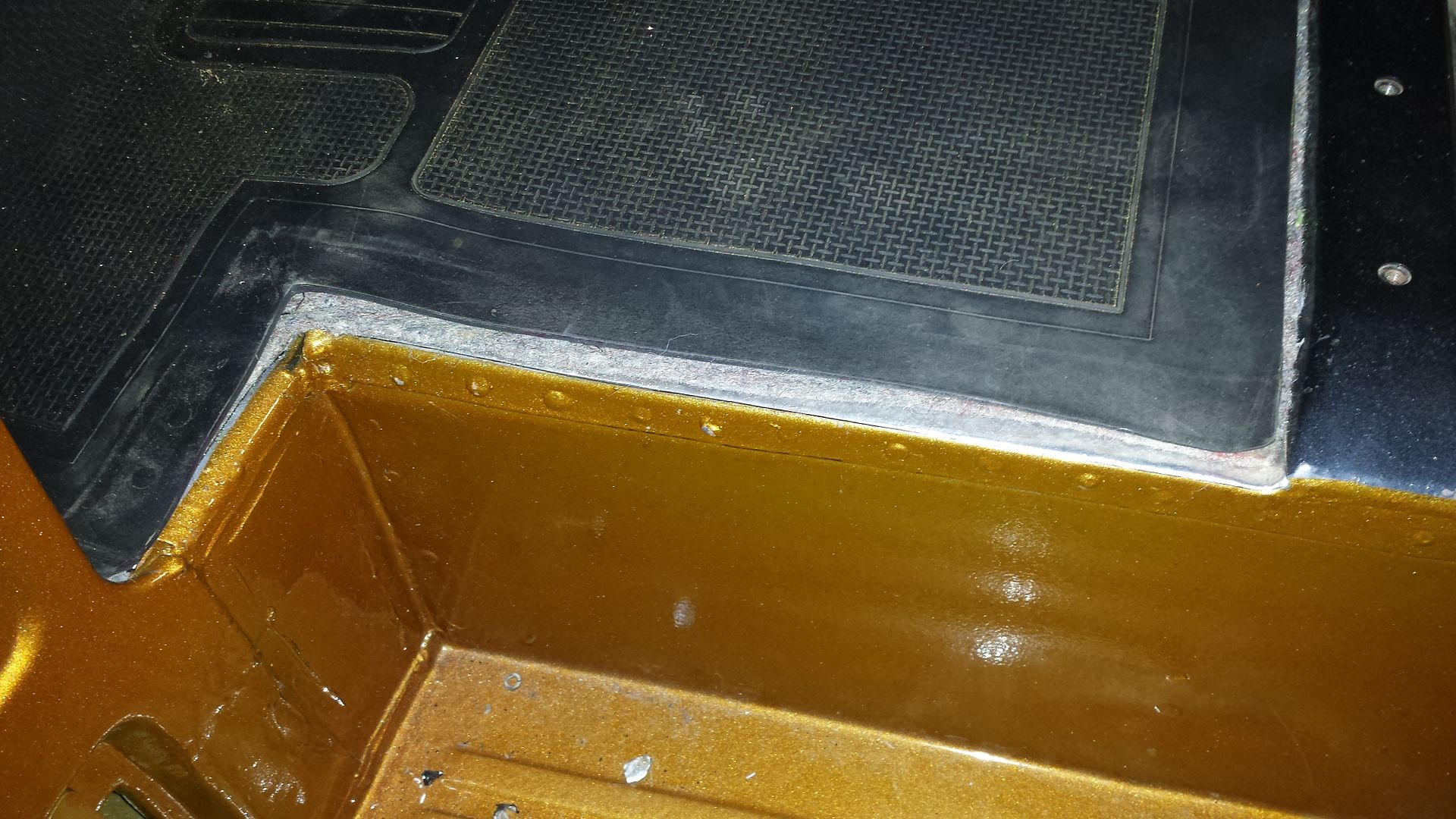

I put in the jute & rubber mat. I'm surprised no one makes a sill plate to hold this edge down, that I could find. Gonna need to make something.

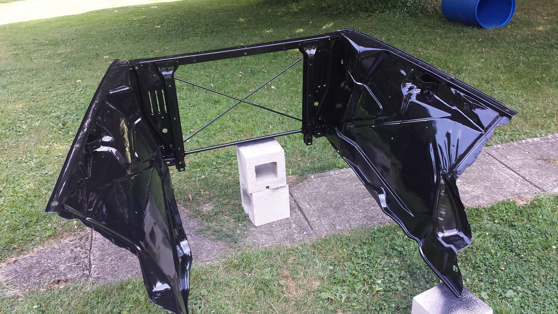

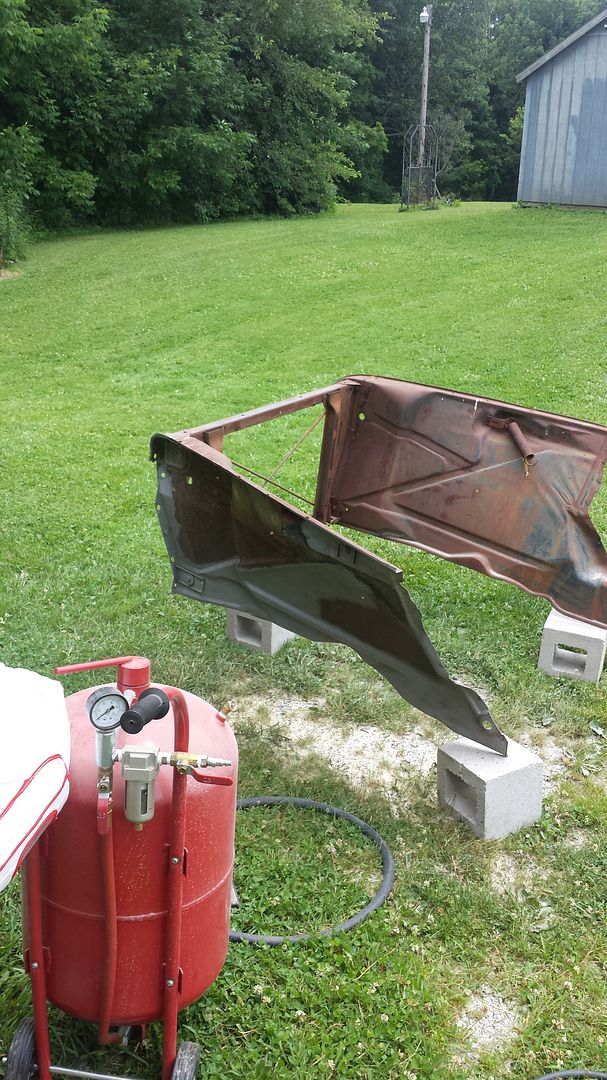

Stripped down the front clip to get the inner fenders and radiator support to get it blasted and painted.
All shiny black now.

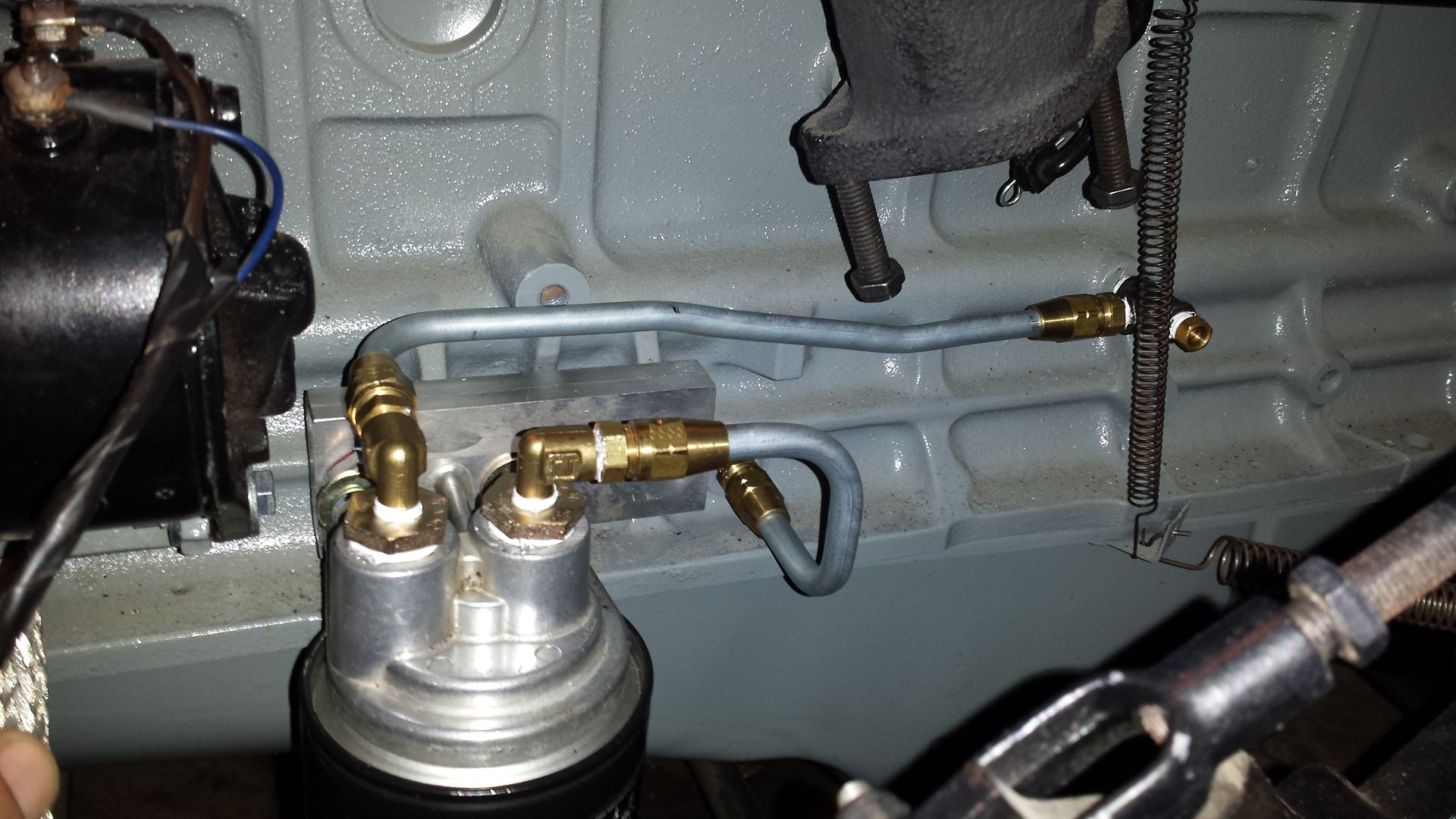

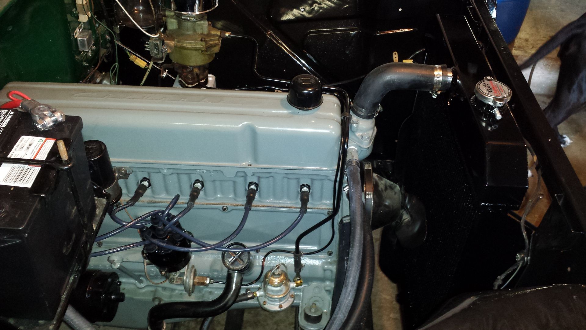

Made a mount and bent up some steel line to have an oil filter. Really happy how it turned out.

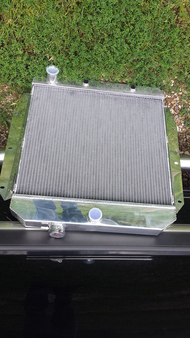

Getting excited again and the push is on to hear it run. Ordered a gas tank and sending unit from Bob's and a aluminum radiator from Champion.

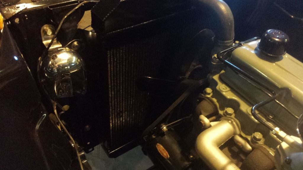

Now the plan with the radiator was to paint it black. But when it showed up all shiny & gorgeous I started having thoughts of keeping it that way. So I call up Champion and expressed my concerns about it oxidizing in Ohio weather. Guy said "no problem just wipe it down with cleaner and shoot it with rattle can high temp clear." So I do that not taking into consideration that it was super humid that morning. After spraying it I checked back up on it later and it looked like I sprayed it with grey primer. The humidity clouded up the clear horribly. I quickly grabbed a can of gloss black and hit it a gain. Turned out nice and now that it's in the truck I like the black better.

Got some sill plates made for the truck. Holds the edge down tight.

Also installed a horn.
It's an old Shovelhead horn I had laying around. Works and adds a little bling under the hood.
Rebuilt the carb thanks to a kit off of e-bay. Easiest carb I've ever done. Picked up brushes for the generator at NAPA for $5 and had to file the contacts in the regulator and polarize to get her to charge.
She is a runner!

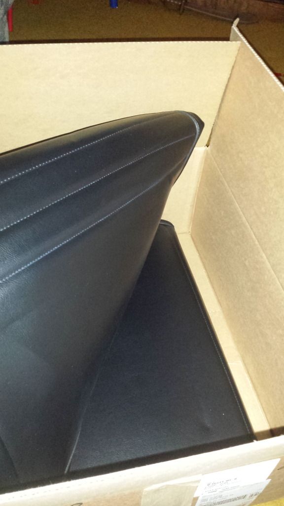

Fedex driver dropped off new seat upholstery today. Padding material should be here early next week. Never upholstered a seat before, aughta be fun.

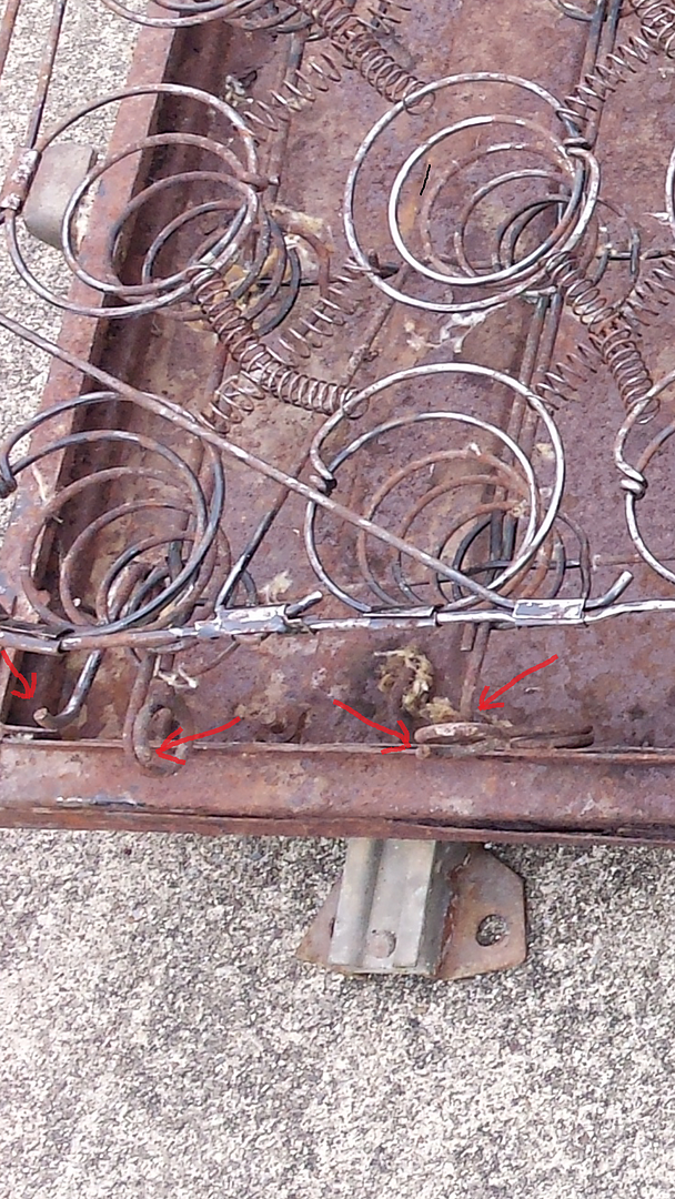

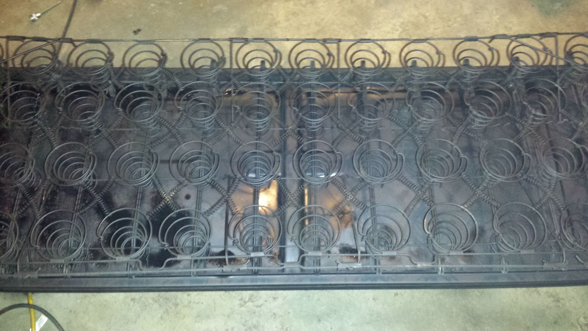

Decided to tear into the seat.

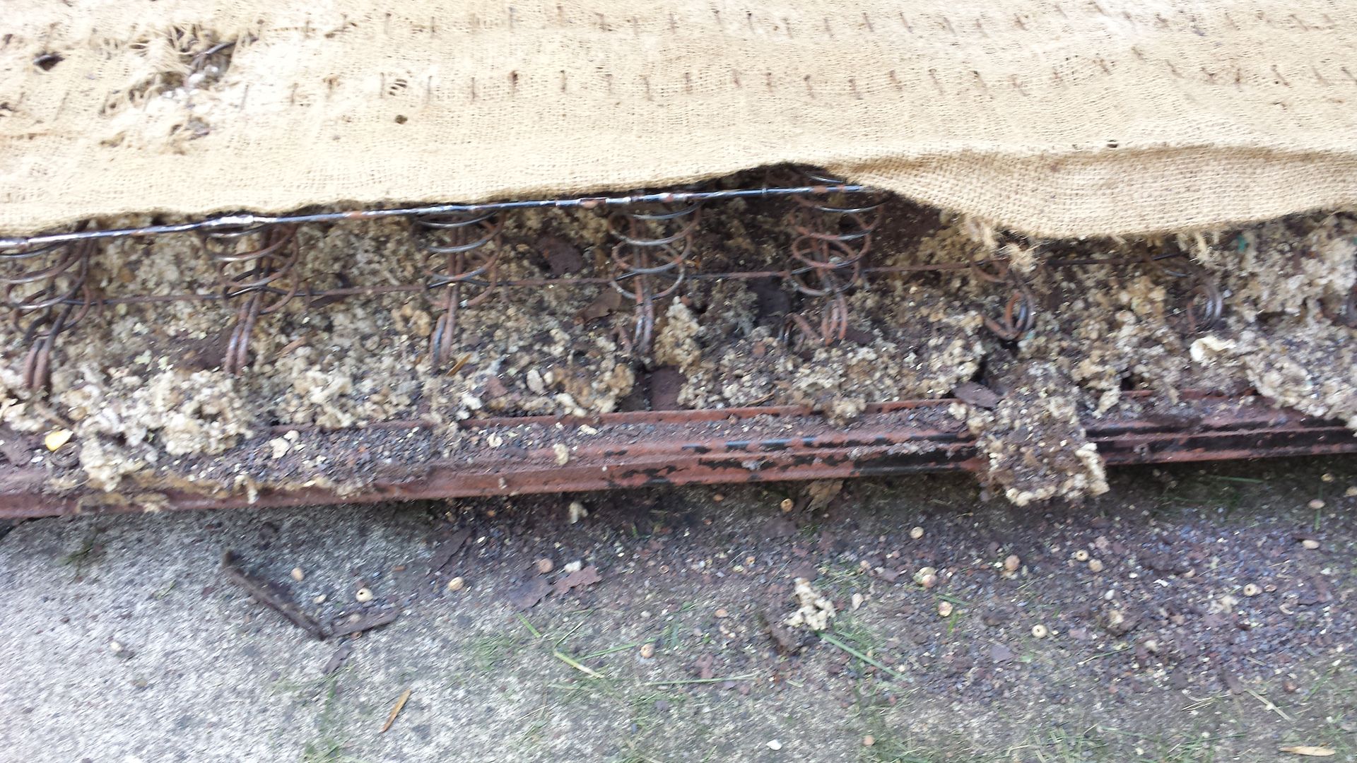

Mice have been having a ball.
Back cleaned up good, but the bottom has a few broken springs.
Think I'm going to pull the seat out of the parts truck to see if that is any better.
Closer inspection of my seat shown several broken springs and the bottom tin very rotten. Decided to pull the seat out of the parts truck and see how that survived. Only one broken spring and the bottom tin was in much better shape.
The stink of mouse pee was a little overwhelming even when stripped down to metal. Took the bare frame up to the back yard and soaked it in bleach and then soap & water. Blew it off and set into rust removal with a wire wheel. The stank came back, so I cut loose with 4 cans of satin black and that took care of the stink. Hopefully gonna try my hand at recovering tomorrow.

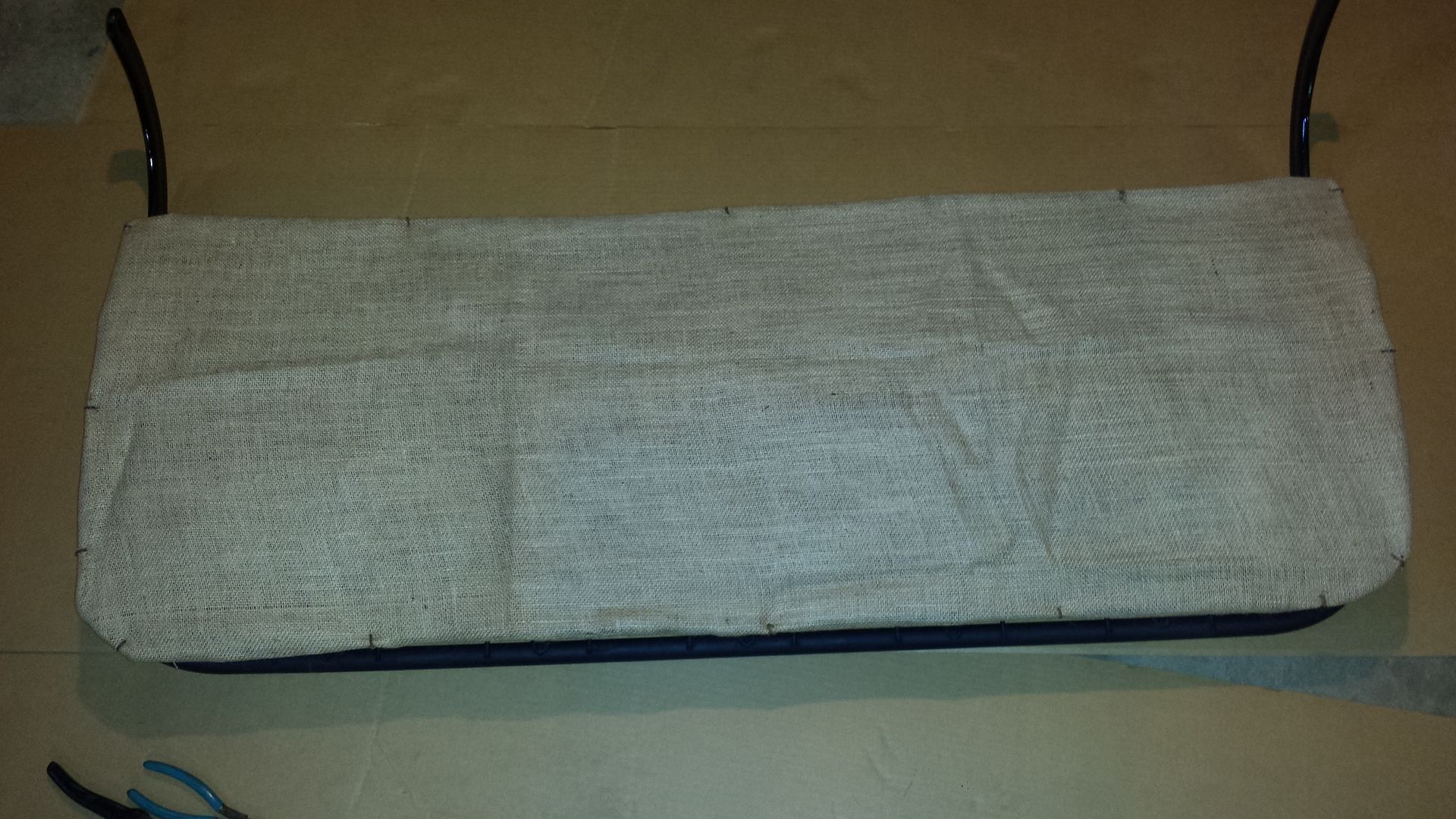

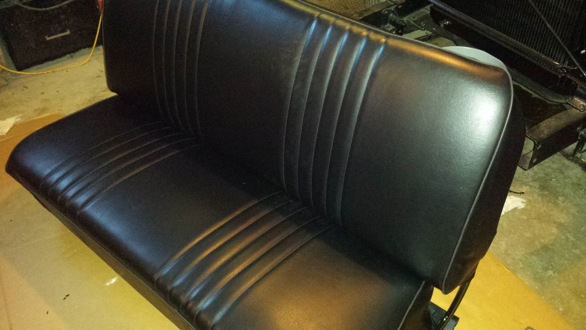

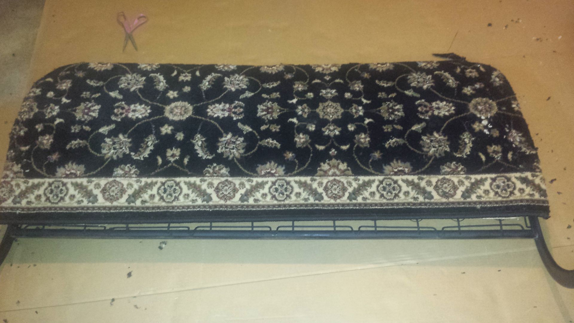

Ordered a padding kit from Classic Parts USA. Had two pieces of burlap, one piece of felt, plenty of cotton batting and new clips. Started off covering the springs with the burlap, reusing the hog rings from the old covering.

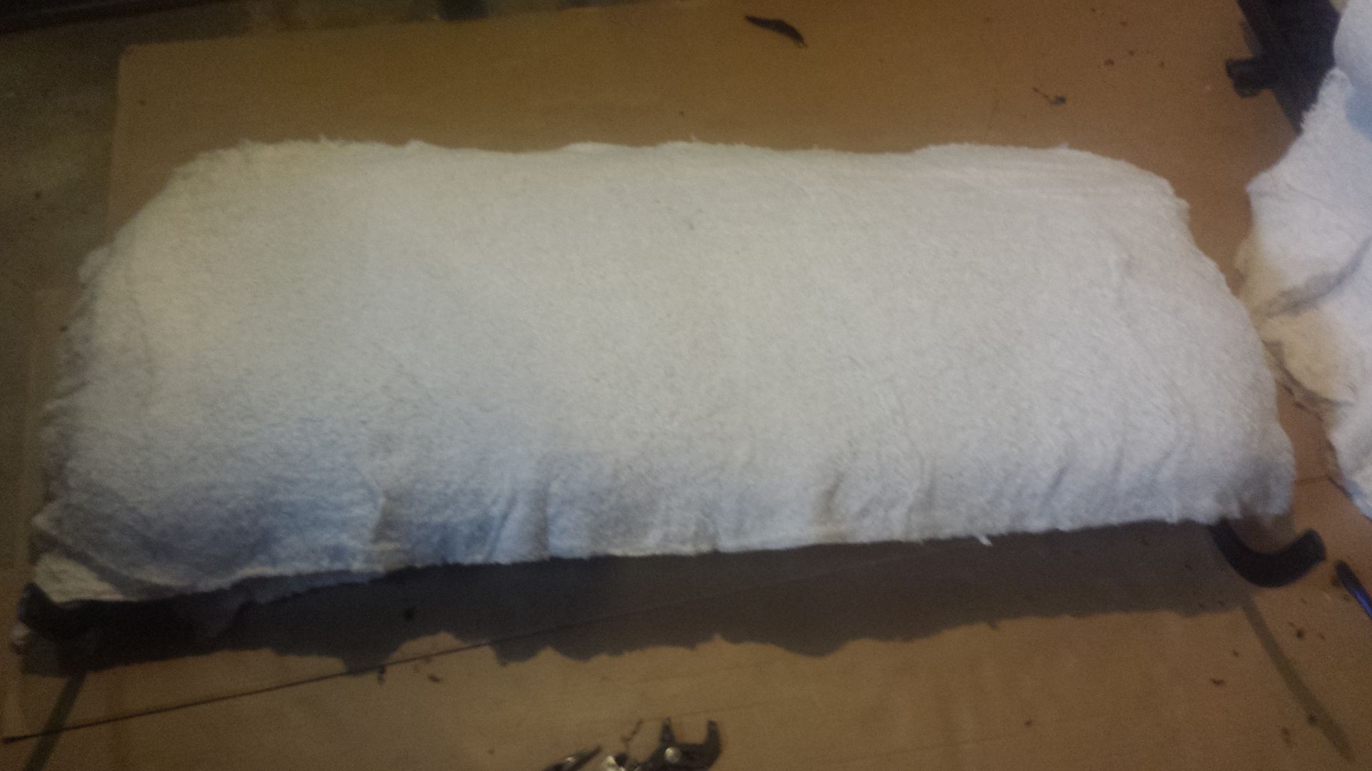

And since they only sent enough felt to do 1/2 the seat and I thought that something stiffer between the springs & batting was a good idea. I laid down alittle carpet.
And then two layers of batting.

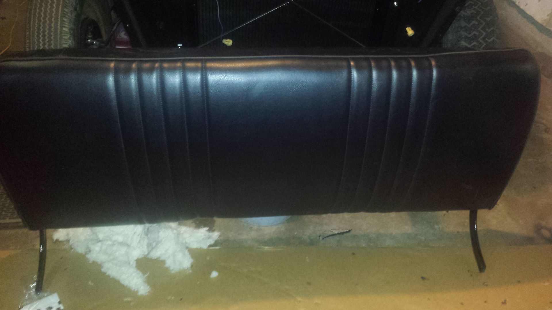

Pulled the cover over it and then flipped it over so the padding stayed in place. Then sat on it while I pulled it tight and installed clips.
Didn't turn out too bad. Time to move on to the botton. Burlap, the felt, two layers of batting, slide cover over and flip.
This is where the cussing and sore fingertips enter in. Didn't grab the camera at this point, I was on a mission to get this job done. Being able to pull the cover tight and get the clips installed down in the little ditch is a PITA!
Done! Happy with how it turned out and it's damn comfortable.
