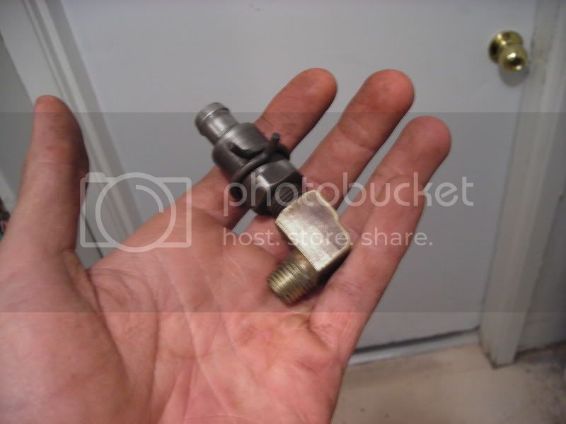

I finally got a look at the pic ~ A & C are the same part and D is the clamp that holds it from wobbling loose.
loosen & remove the clamp and then unscrew the brass elbow and PCV valve , cook the big sheet metal cylinder , it'll really make a stink so DON'T do it if SWMBO is home ! .

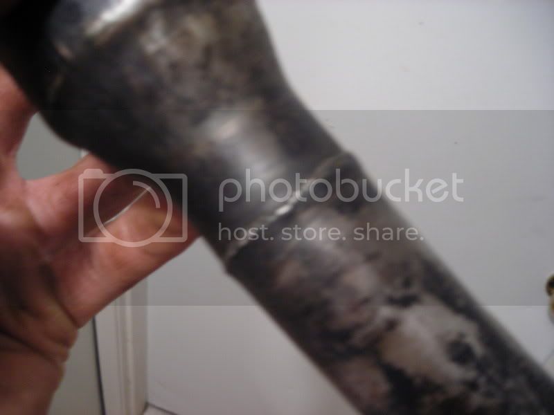

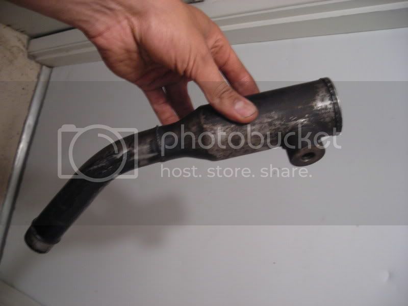

ok, still haven't gotten SWMBO to leave the house yet, but i did get things disassembled and cleaned off a bit. here's some pics. please shout at me if there's something more to disassemble before i go cooking it!!
jon

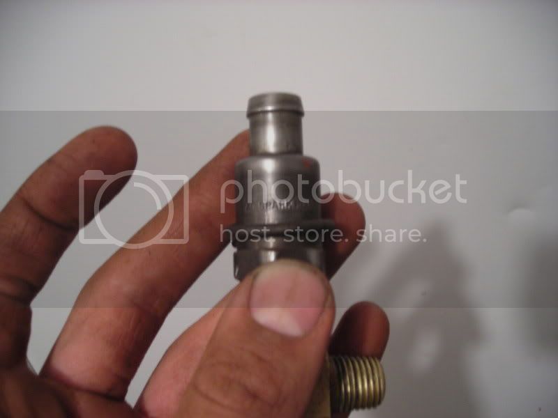

if you look closely, you can read "AC spark plug" on what i believe is the PCV valve setup.
the tube is welded to the top piece, not sure if that's OEM, but the weld looks kinda shotty.
thanks!! jon

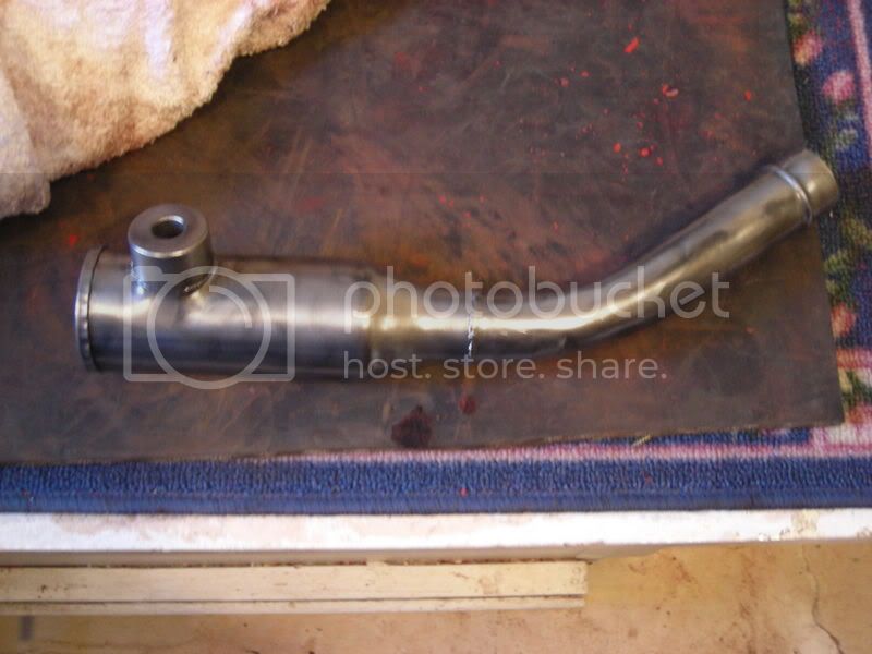

The big tube thingie is wht you want to BBQ ~ wire brush it of all the paint you can first tho' :rolleyes:
The PCV valve in the lower pic ~DO NOT heat it ! next to the tiny printing should be the AC part #.......
Soak it in some cleaner , whatever typ floats your boat , for a few days whilst you're screwing 'round with the breather tube .
If your vacuum cleaner (connected reverse so it blows , dig) shows no resistance , you can prolly just wire brush , rinse off and re-paint the breather tube , no BBQ'ing required but usually they're full of sludge and 1/2 dried oil gunk .

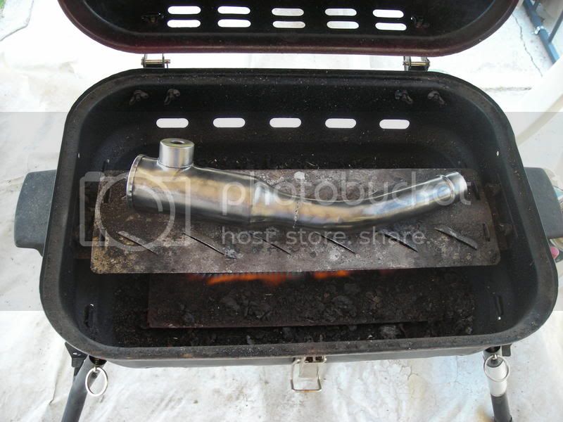

Keep a lid on it!
That way every time you pop the hood, you'll catch a faint whiff of oak, grapevine, hickory, pecan, or what ever kinda wood you'd decide to throw on there!
Or if all else fails, just ask Andy. He's been there- done that!
Whichever allows you to get it hotter .
Remember : we're NOT kidding about the amount of smoke & stink it'll make , DO NOT BBQ it with SWMBO in the same county !
-Nate
got it all cleaned up, going on the grill today! i wonder if the it needs to be under the lid, or if open air is good enough?
jon
