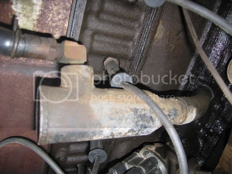

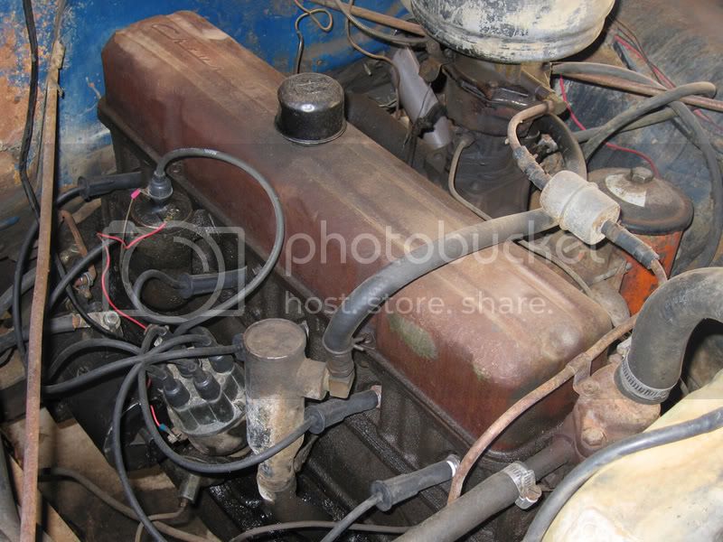

Wouldn't it be almost as easy to modify an old breather tube and make your own pcv set-up?

Yes and yes ~ you canmake your own and it'll be better too ! place the PCV valve up top where it belongs and you'll have less oil loss and cleaner sparkplugs....

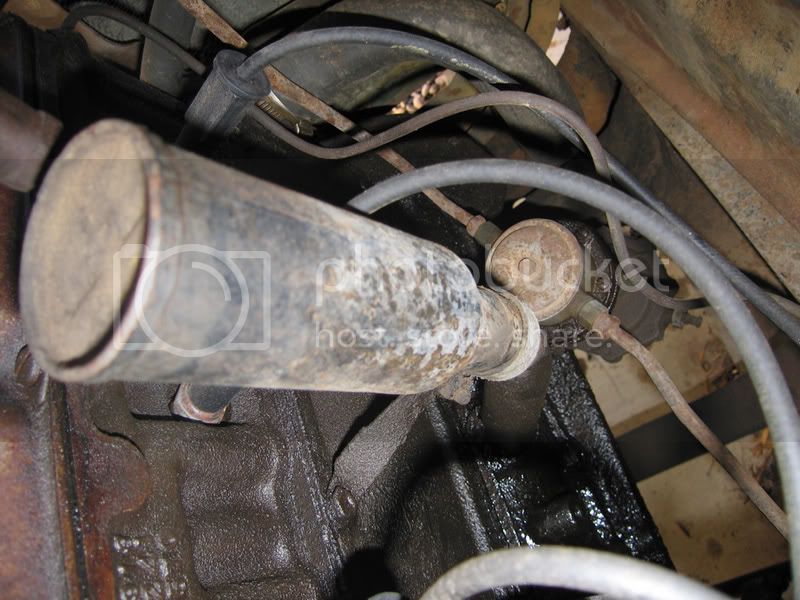

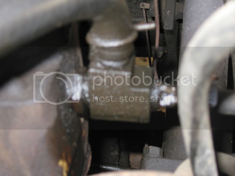

Is that draft tube like the one you have, Nate? Is the OEM one better than the system I "engineered"? :p
PCV System
Yes but , as long as you're not driving down dirt roads , you'll prolly be fine .
Pictures
Hey Jon

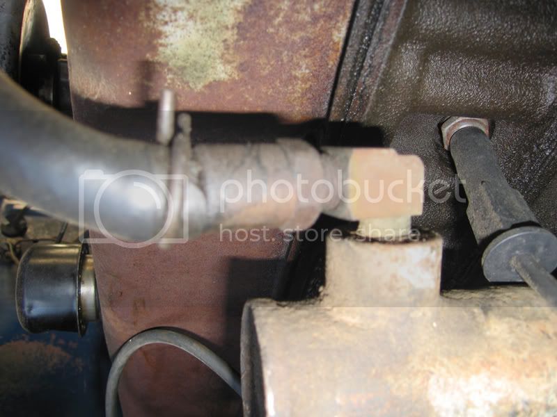

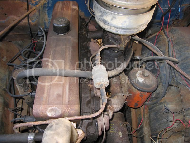

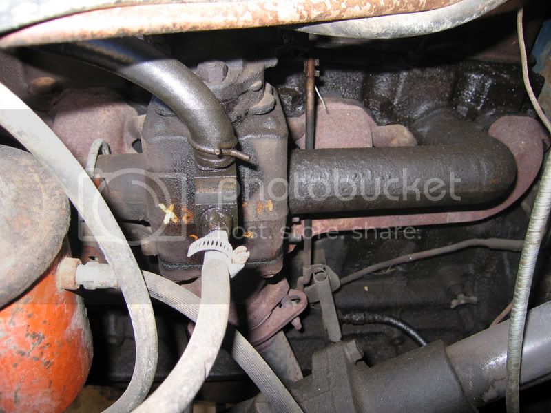

Noticed that this setup have the PCV valve installed in a good way but where is the fresh air coming in ? Normally there is a tube niple going from the top of the aircleaner cover connected to a tube niple to the side of the rocker cover ? Is this missing in your setup?

ok, so i had no idea what thing thing was, or what it did. i noticed it in the manual, so i figured it was a standard thing, but i'm still a little hazy on why it's there, so maybe you guys could enlighten me some more. what the heck does PCV even stand for?:confused: here's a bunch of pics from lots of different angles. hope that helps.:)
