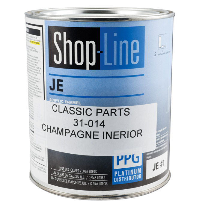

    Time to start rounding up color codes for the interior bits. Anyone have a good source? Penny's interior will be all stock colors.

  19. 50 Chevy LS3
    50 Chevy LS3 Member
    Jan 14, 2013
    951
    Indiana
    Our host sells the paint in Acrylic Enamel.
    (1947-53) Interior Cab Paint-Champagne
    • [​IMG]
    Part # : 31-014
    Year : 47-53
    Steve.
