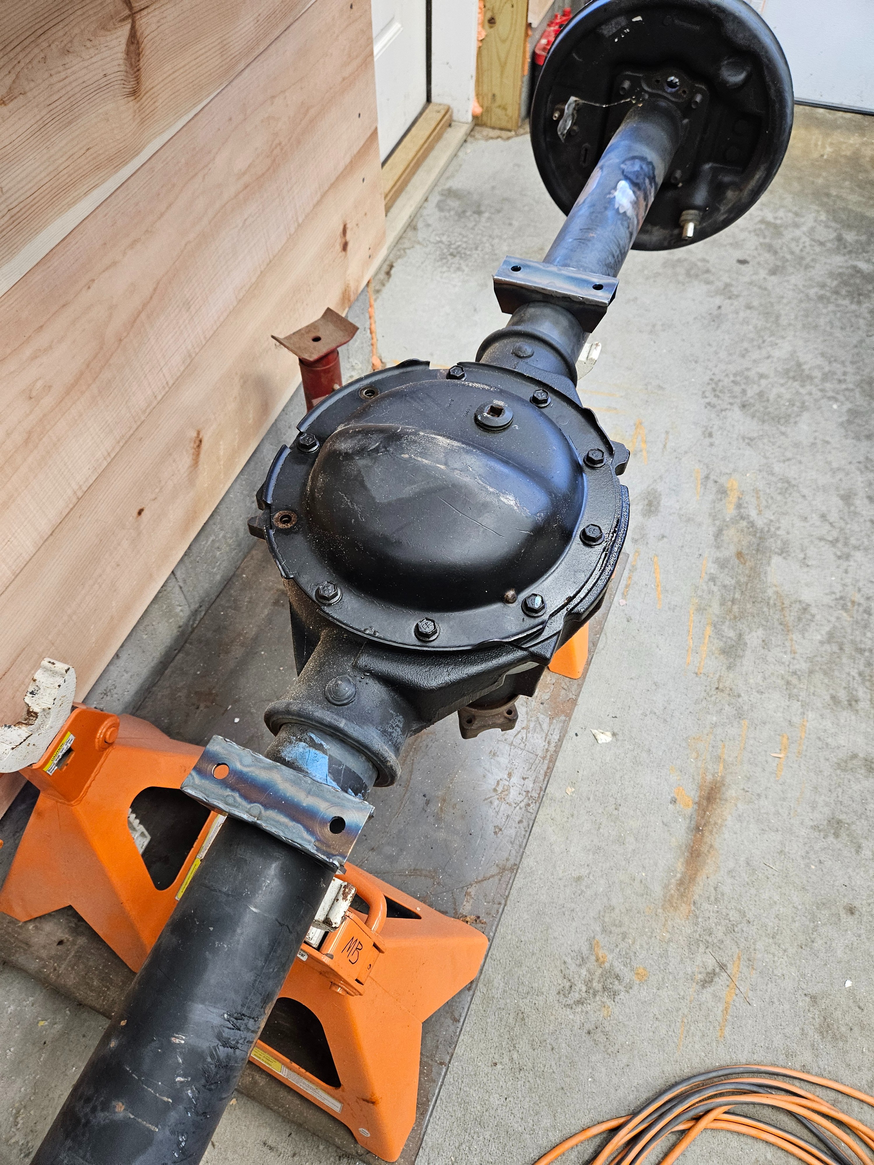

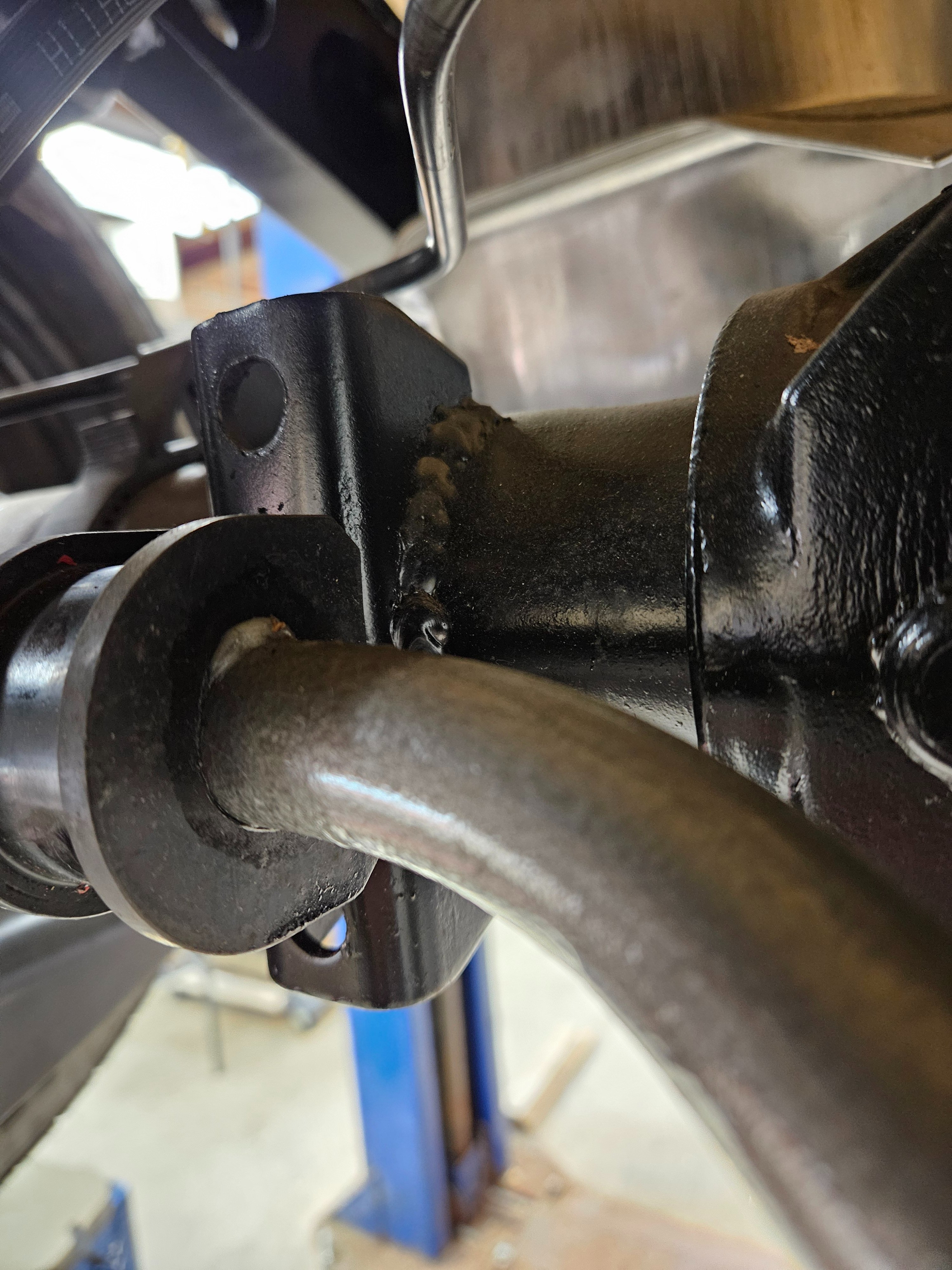

I am getting ready to swap out the "old" 8.0 inch-ring-geared for the 8.6, as the True-Trac has been installed (for a few years already it seems). I had welded in swaybar mounts on the old rear.

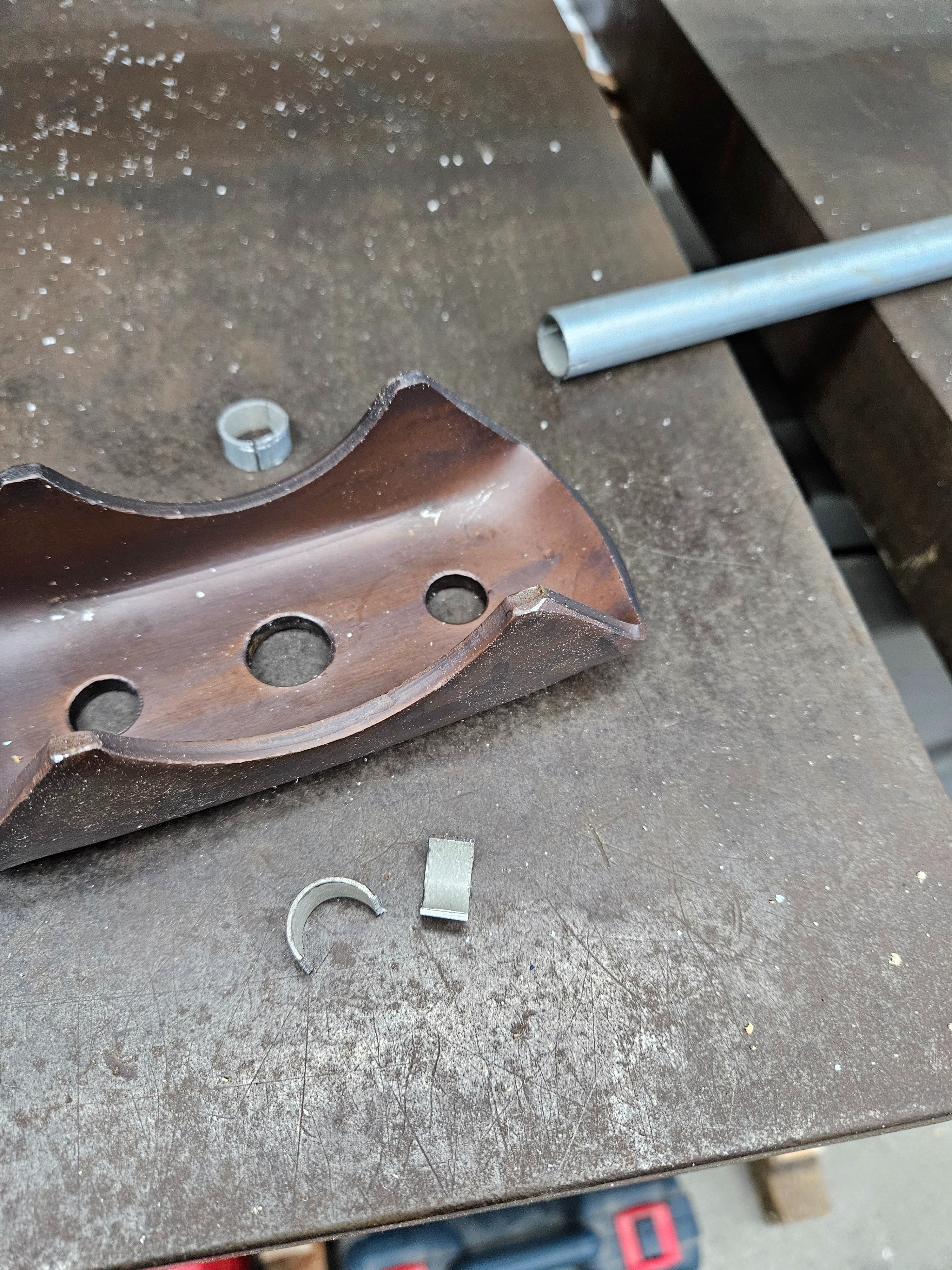

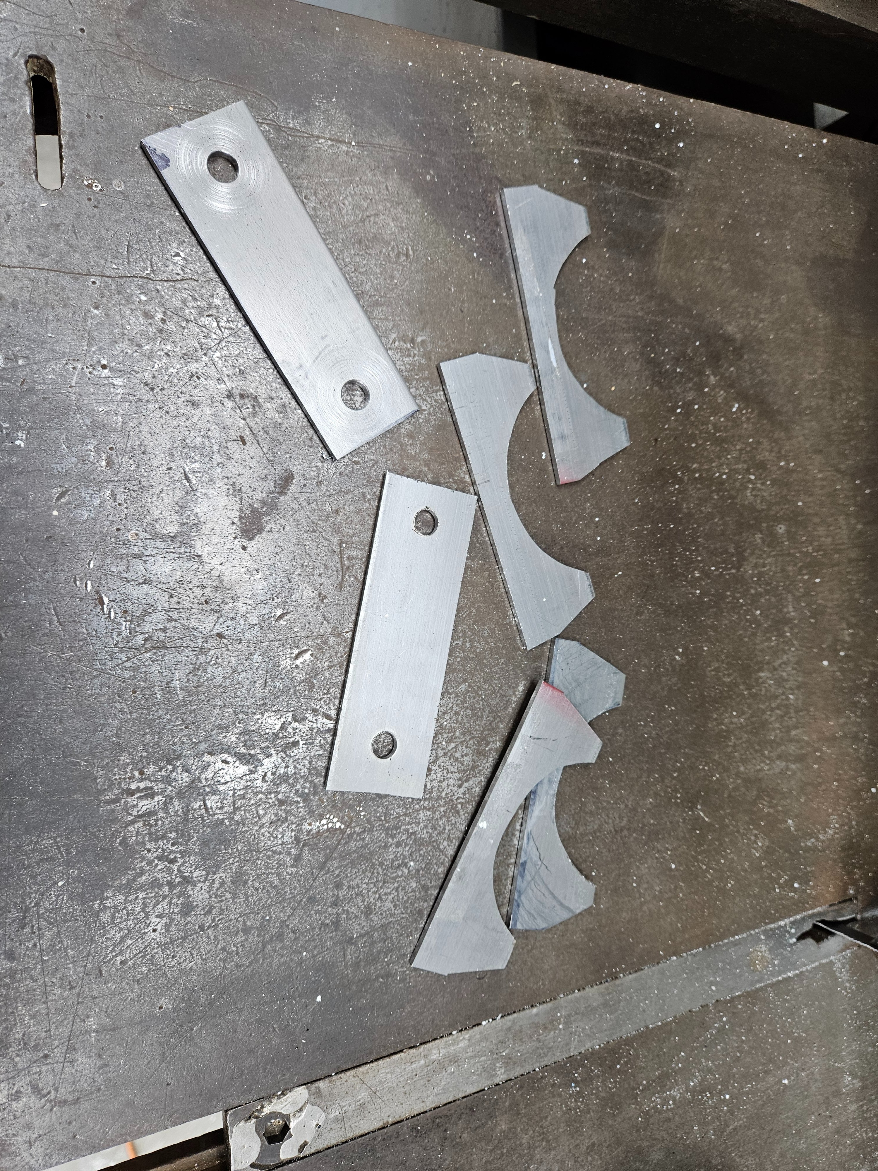

With the drill press and band saw both up and running, I cut out the pieces I'd need out of some 1/8" stock.
Welded them up (my welding skills are a bit rusty, with all the carpentry work that has taken priority), and here they are sitting on the new rear end.

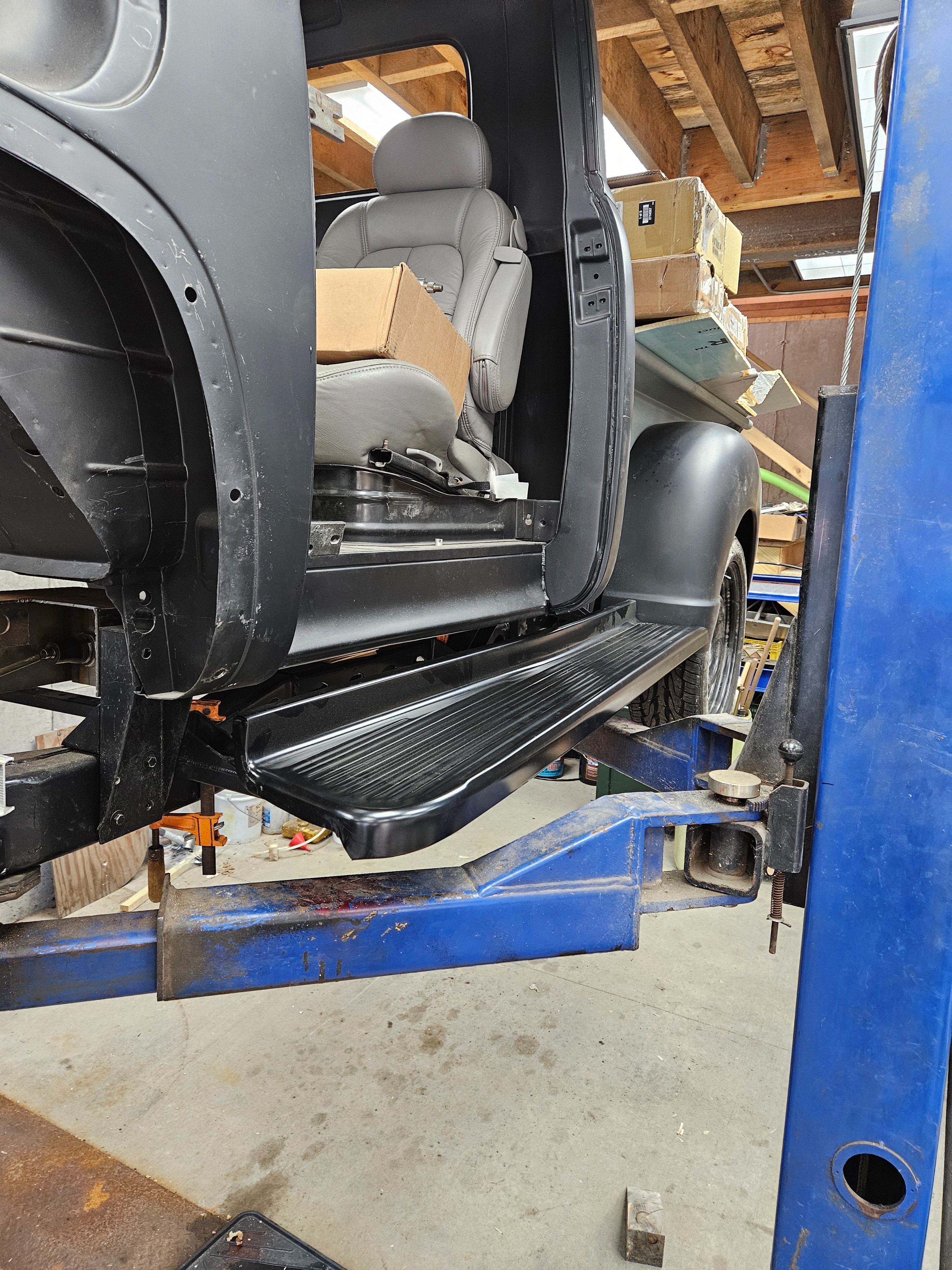

I also mocked up the running board mounts (from the AD Engineering kit) and the running boards, which after looking at the old ones I have, I decided to replace with a pair from our host.

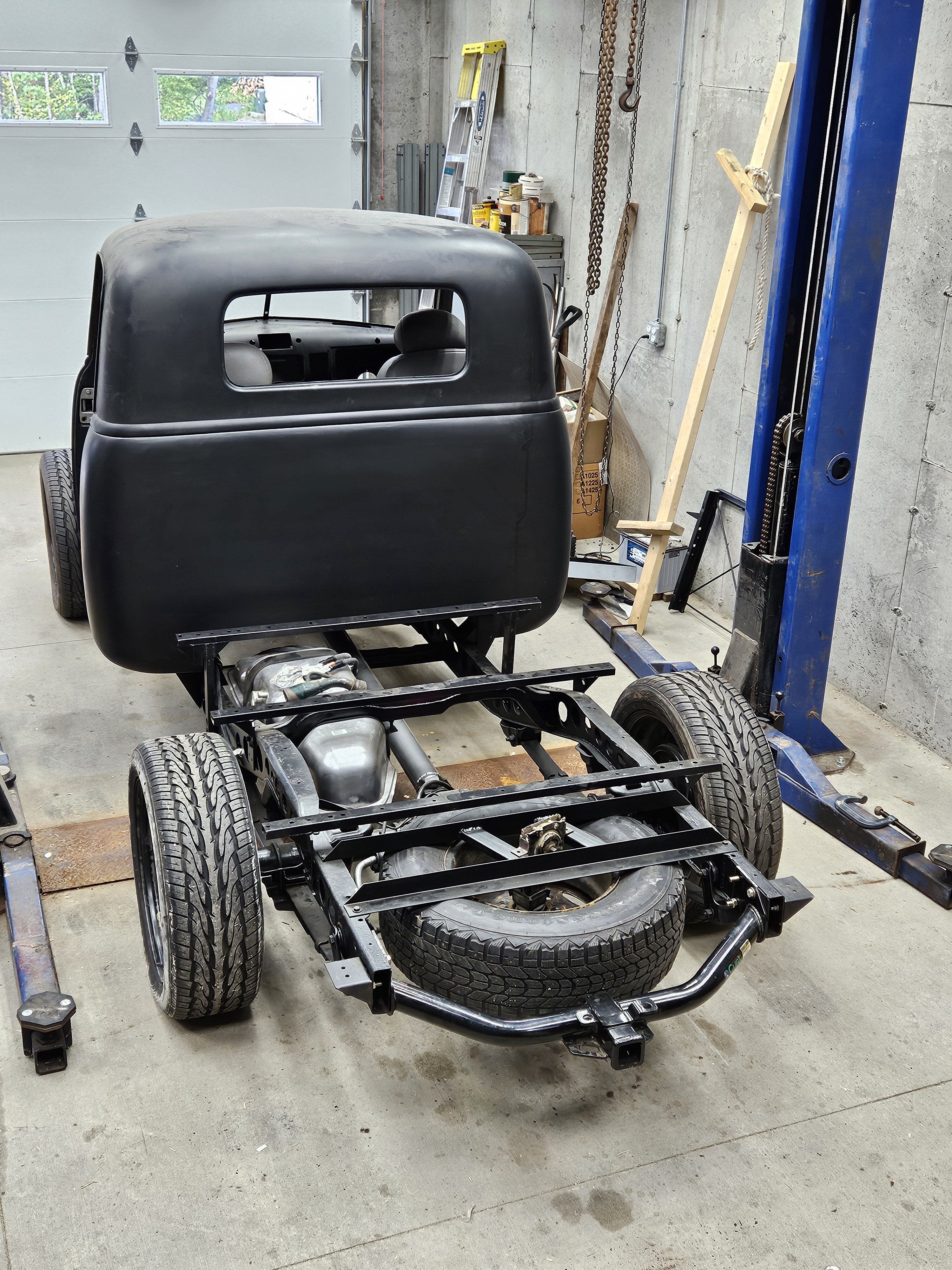

Sunday update
Yesterday, I removed the 8" rear end, and placed the 8.6" on the leaf springs, as I didn't know where the spring perches I bought 2 years ago went... Turns out they were right where I had placed them. So, this morning, I went to set them on the leaf springs, only to notice the center-hole in the perch is a bit larger than the locating pin in the leaf stack. A few minutes with the band saw, and a scrap of EMT from all the electrical work I have done, and I had a set of "spacers". As the rear end will need to come back out to weld the perches (after the truck is complete, so I can set pinion angle), I will leave the spacers loose for the time being. They are galvy, so no welding. I think a bit of epoxy will hold them. They are snug.

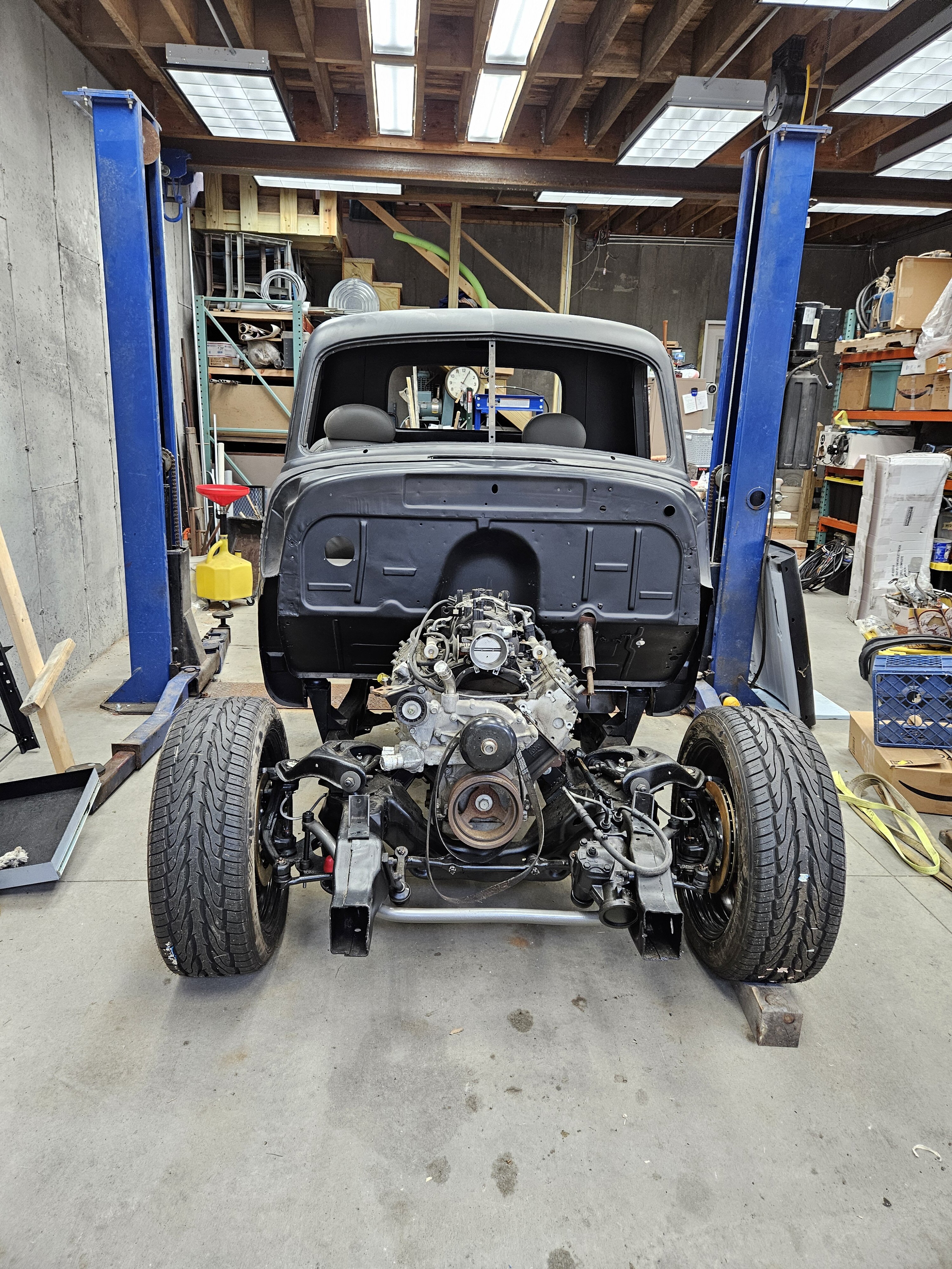

Friday progress:
With the new 8.6 rear centered, I snugged up the U-bolts to hold everything in place. I then lowered the truck down, and installed the wheel/tire setup I have. The fitment is PERFECT. I have adequate clearance to the bedside, and a bit more to the outer fender lip. If needed, I can put an 1/8" spacer between the wheel and brake drum, down the road.
With the rear end installed, I turned my attention to the steering column (which need to be in place to install the shaft to the steering box), to setup header clearance. I purchased an Ididit column-shift tilt column, in bare metal, from our host. It comes with a "hanger" to mount it to the dash. Personally, it looks a little too "street-rod billet" to me. With the column being 2.25 inches in diameter, vs. the 2 inches of the original column, I couldn't just reuse the 2-piece "clamp". I modeled a new 2-piece clamp in CAD, and will be 3D-printing it over the weekend. If it is to my liking, I will have the machine shop just down the road mill the pieces up out of Aluminum. They will be painted to match the interior, just like stock.

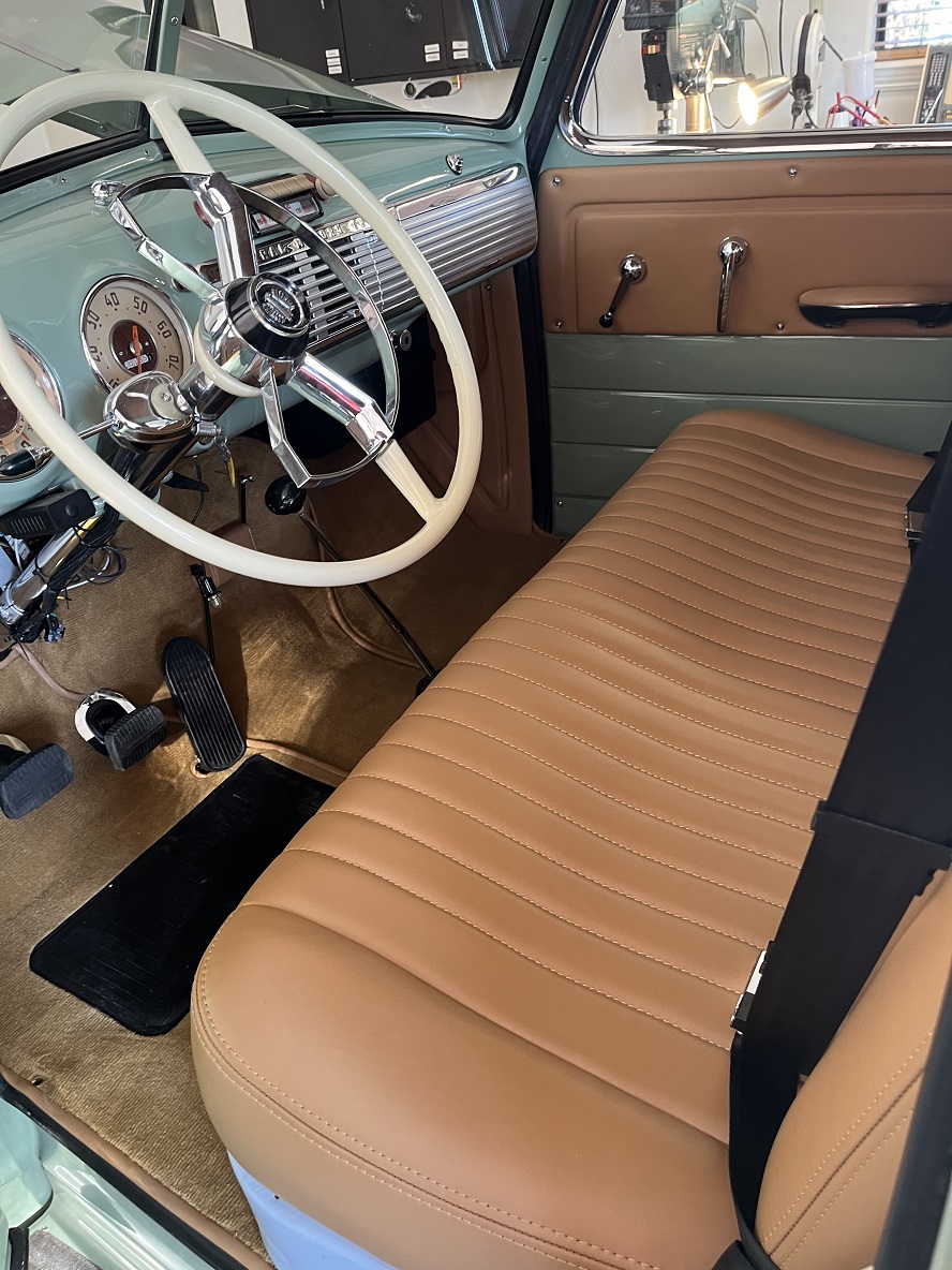

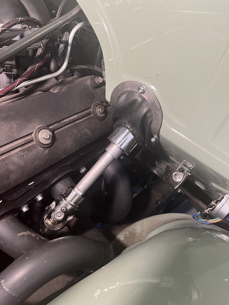

I didn't much care for the Ididit steering column either, so I bought a 2" polished tube from Speedway and a upper steering shaft support (with a horn ring) from Chevs of the 40s and made one. For the bottom bearing I used a 'column saver' to support the shaft. For a steering shaft, I went to the local junkyard and pulled a steering shaft out of a mid-sixties GM truck, cut it to length and ground the double-D at the end to fit a Borgeson U-joint. This is an 'accessory' steering wheel with the same spline as the original truck's
The thing that the Ididit column has going for it is self-cancelling turn signals - I'm still getting used to manually cancelling them and often forget.
The Ididit column probably has some sort of crush feature that helps it from impalling you in an accident, which my column doesn't. But I've rationalized it by thinking mine is no worse than an original column for safety. I made a bezel for the column out of some stainless sheet metal and had the upholsterer make a boot for it
Whatever steering column you use, make sure you drill the shaft to let the setscrew penetrate it and locktite it in.

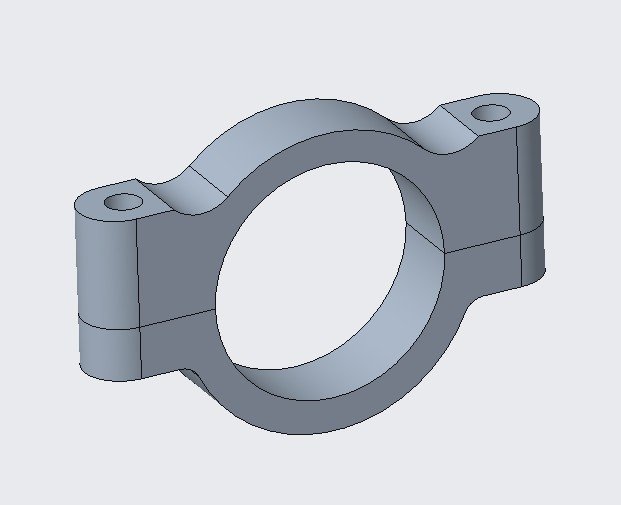

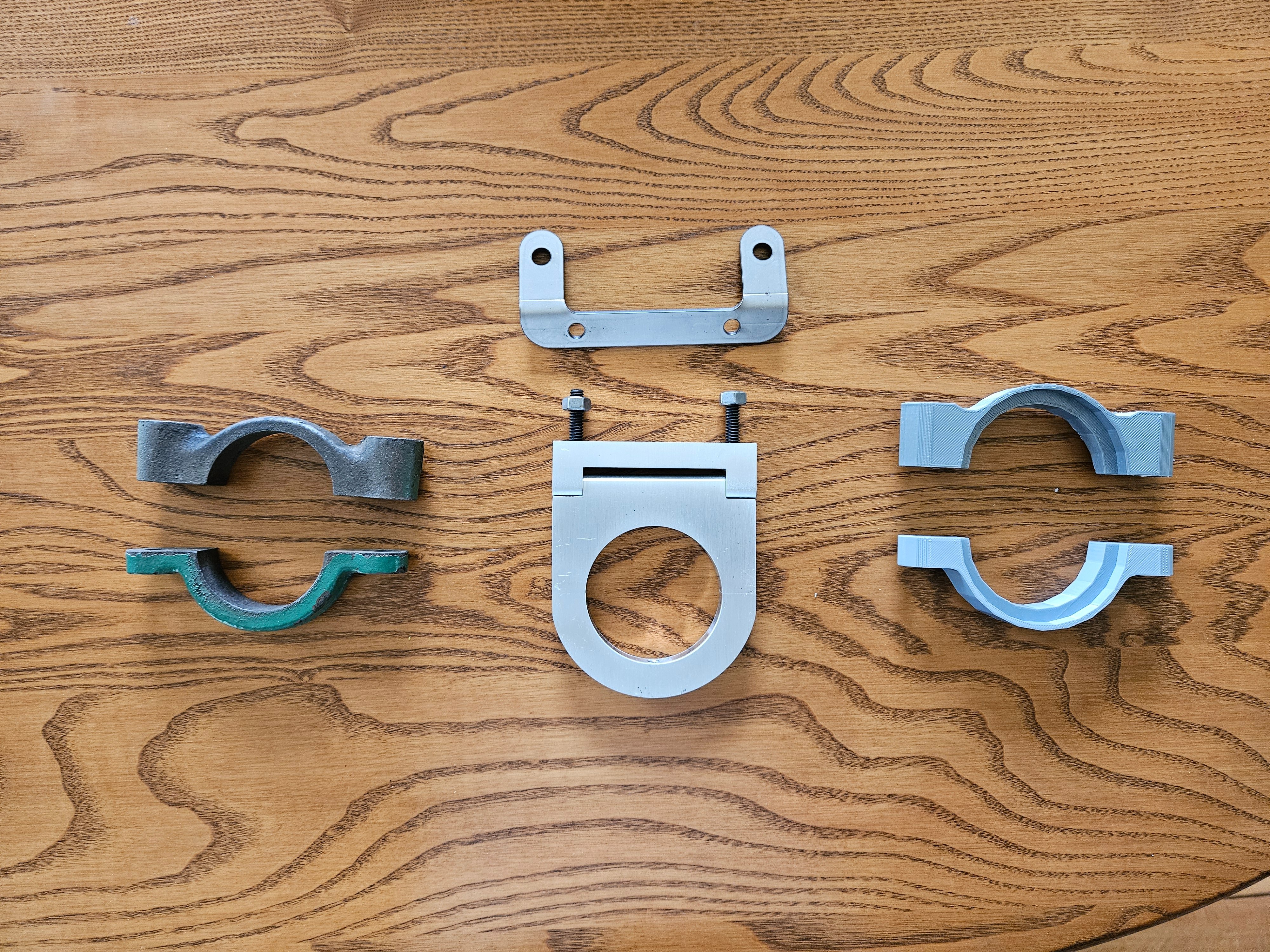

My son brought me his 3D printer, which I used to promptly print the Upper Column Clamp. Then... I had an issue with the heater for the filament in the printer. Luckily, a friend of mine has several 3D printers, and took care of the Lower Column Clamp for me yesterday. Here is a comparison of the ORIGINAL, the Ididit and my 3D-printed prototype.
As I mentioned, the Ididit piece looks too "street rod" for my liking. It also drops the column down quite a bit. The original, and my piece, both keep the column tight to the dash. I added a counterbore to my parts, which would give me the ability to push the column further "in" to the dash by 3/8's of an inch. If I need the 3/8's, I will have the aluminum parts machined as such. If not, I will remove the feature in the CAD model that will go the machine shop.

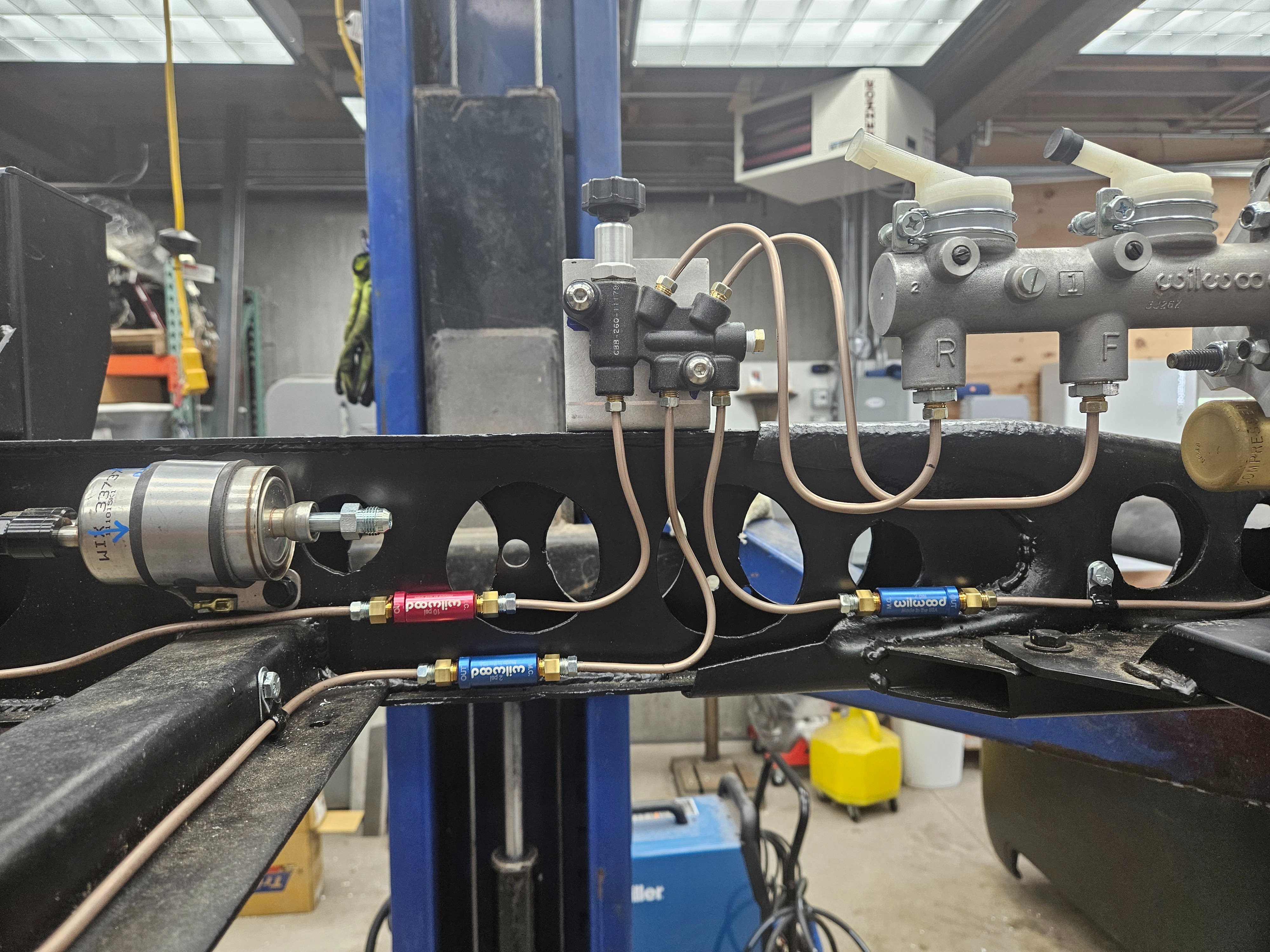

I also got all the new brake lines installed. I purchased CuNiFer (also referred to as NiCopp) line stock by the roll, and all the fittings required, from The StopShop. Bending the lines was a PLEASURE. With the master cylinder mounted as low as it is, Wilwood recommends residual pressure valves, as close to the master (or the proportioning valve in my case) as possible. 2 pounds for the fronts, and a 10 pound piece for the rear (drum) brakes.

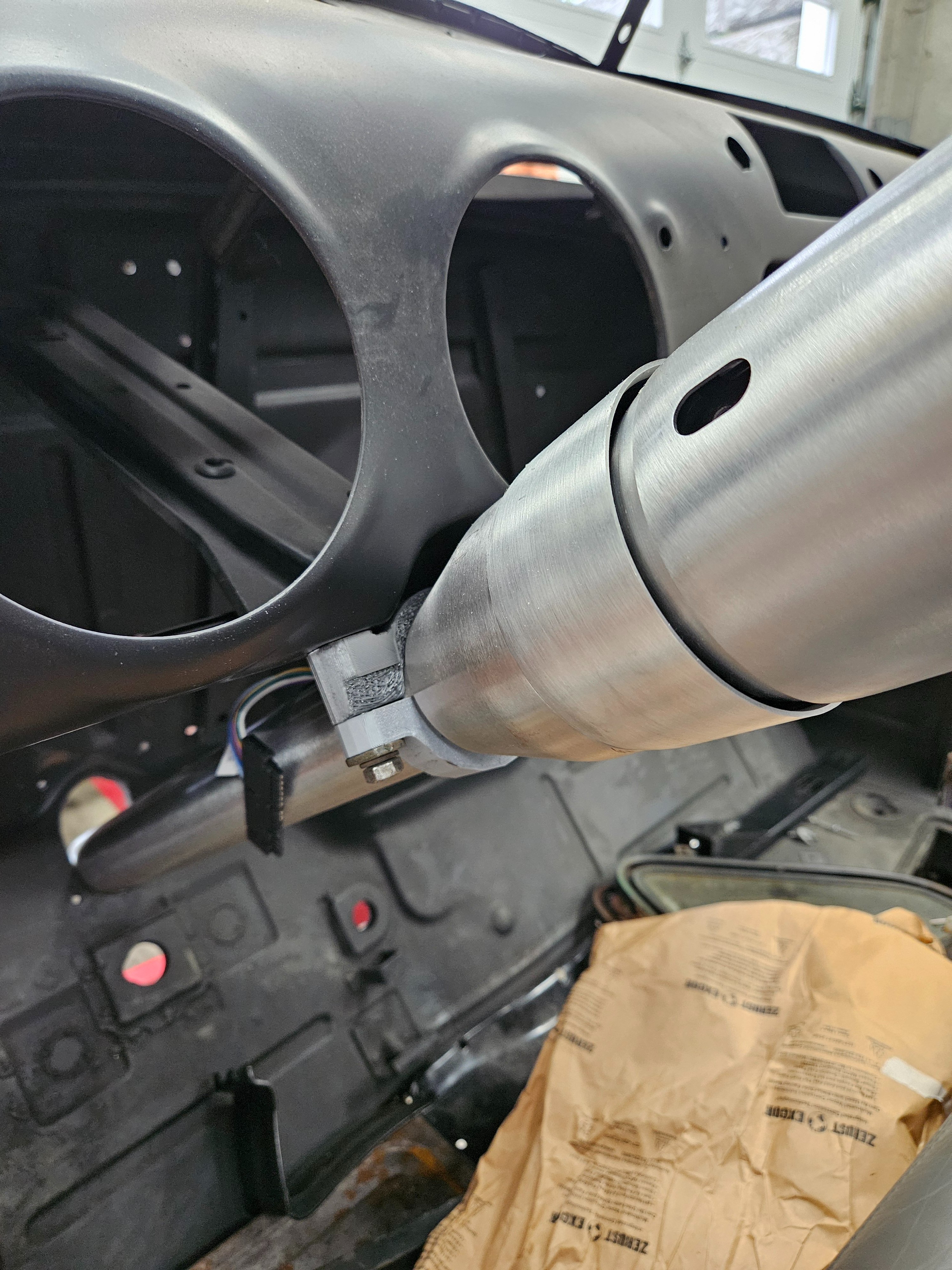

Column test-fitted. As it turns out, the counterbore in the clamp pieces will not be required. Now to address the BOTTOM of the column. The Ididit piece supplied for the lower column doesn't particularly excite me anymore than the upper.
