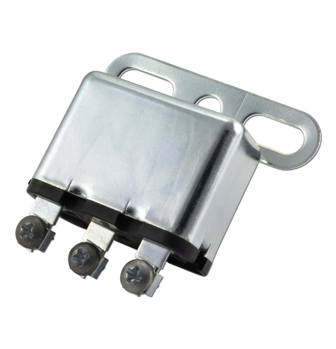

    Is your relay like this?

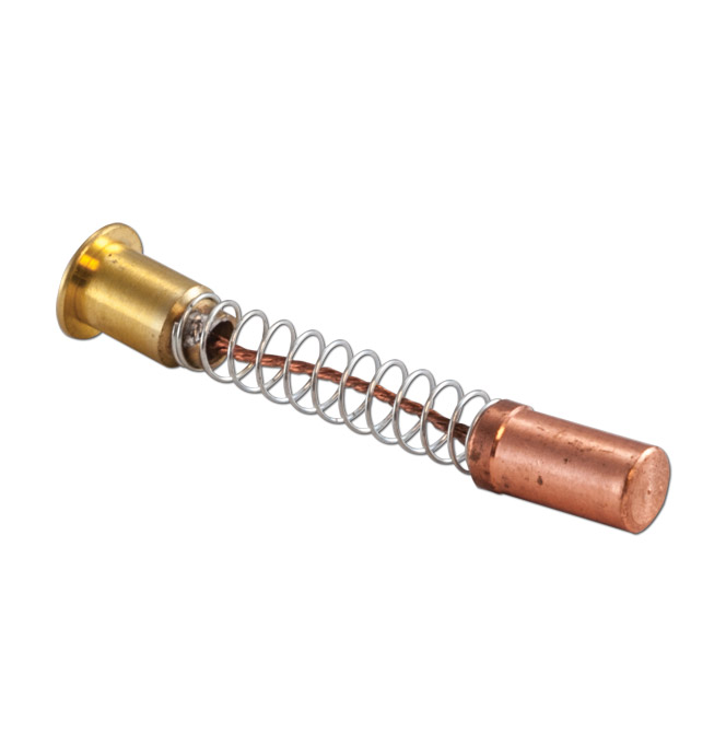

    If so, the horn(s) should connect to the left terminal, battery to the center terminal and the right terminal connects to the horn button via the upper mast bearing outside lip as Tom stated above, then through the contact/brush that looks like this.
    If anywhere along this path you touch ground, the horn will blow. If you have an ohmmeter you can easily find the point that is grounded.
