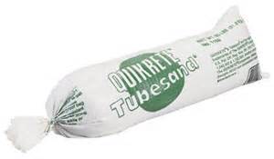

    This works well... I use them in the winter time for ballast in my truck. http://www.quikrete.com/productlines/SandTubesand.asp
    Only issue is in the winter when they freeze they are a 60 pound frozen projectile sliding around in the bed and therefore need to be restrained.
