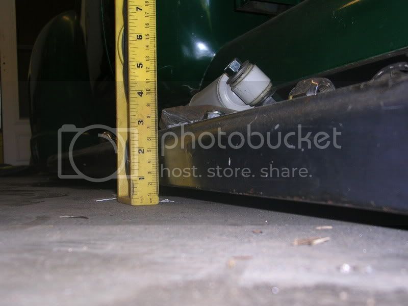

    I'm with you both on too low. Ideally I'd like to replace the springs and end up right where it rides now.
    The problem for newbie me is how to figure that out. Should I send pictures to an Eaton rep and see if they can dial it in for me? Would them do that?

    I doubt if they could tell you just how much your truck has been dropped from stock. With Eaton if you want the nylon sliders you need to tell them you want the street rod style spring. I would go with a 3" drop spring and go from there. How has the front of your truck been lowered?

    The spring ends have been curled, see post #6 of this thread. Also the rear suspesnion has a block welded to the rear axel.

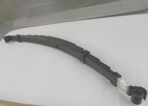

    Happened to come across this new front spring from another vendor ... it has the same curl. It is described as

    It's quite possible that your existing springs were indeed done by a reputable shop and they are fine as is.
    My suggestion is to take them to a local spring shop. They can tell you if they were modified with a torch (by performing a hardness test) or if they were modified by a spring shop and heat treated afterwards.
    Just a suggestion.

    Good suggestion. I will do that.
