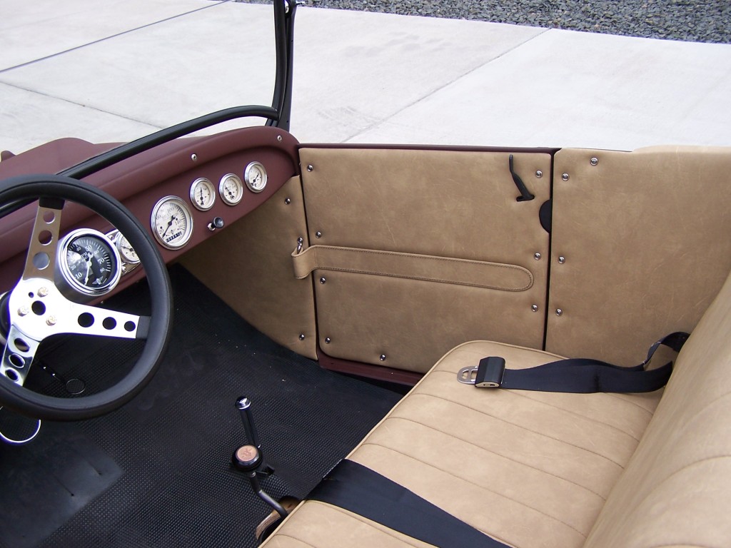

    Finally... After Months...A little 50 Chevy therapy...
    Decided I would turn off the cell-phone and just escape to my project. Even for just a couple hours.
    I thought I would go ahead and test fit the Lokar, shifter, that has been on the shelf for awhile.
    I know... baby steps, again, but I took pictures so I thought I would share.
    Second picture shows position of the shifter while in "Park". Third picture shows the position in "1st, or LOW" The long stick has much more of a throw, than I figured.
    It is not at all uncomfortable while sitting in the drivers position. I could put a shorter stick on it if needed.
    The knob, as you can see, gets very close to the bottom of the dash. My only thought on that is, it might be a problem with an A.C., install.
    I don't precisely know how close it will be to the seat in Low gear. I'm determined to have a bench seat, hopefully original.
    I think it will clear OK. These cabs sure are small.
    Sorry about the last one being sideways.???
    I'm now trying to figure out the E-brake install.
    Steve.
  18. 52wasp
    52wasp Member
    Jul 21, 2006
    694
    Wilton, New Hampshire
    Steve,
    If the pivot point were further from the mounting plate, you would have less knob-travel to achieve the same gear-lever travel. Huh, more pivot/lever/travel math, this time it's Steve!

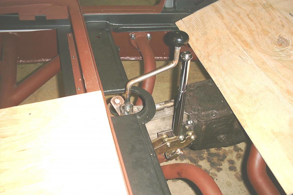

    Added the Lokar E-Brake kit.
    Decided on the Lokar, Trans. mount kit. I had to fabricate a "relocation" bracket, so as to move the mounting location to clear the "hump".
    I also wanted to move the pivot point on the e-brake handle up, as close as possible to the bottom of the floor board.
    I like this setup much better than the original.
