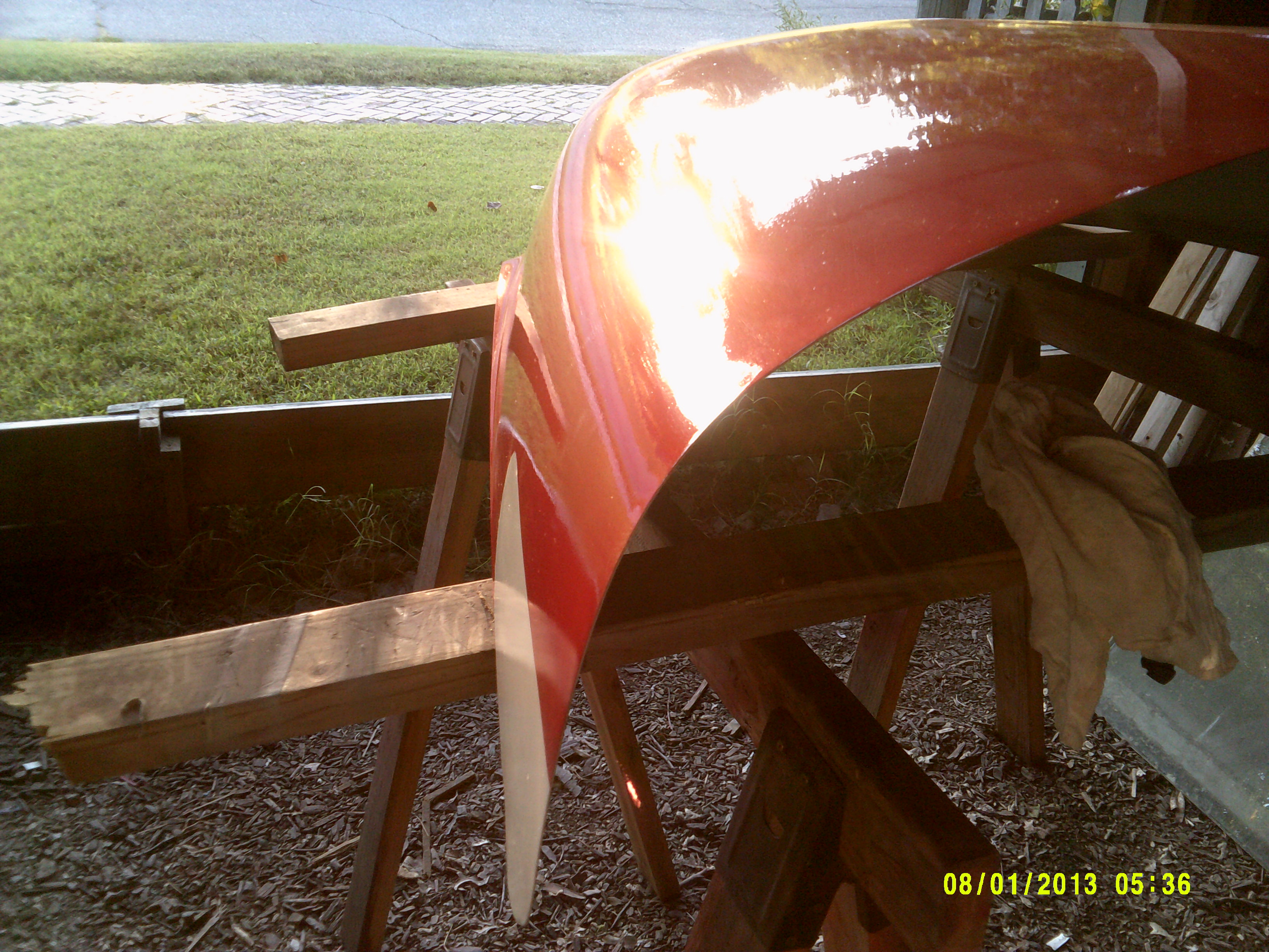

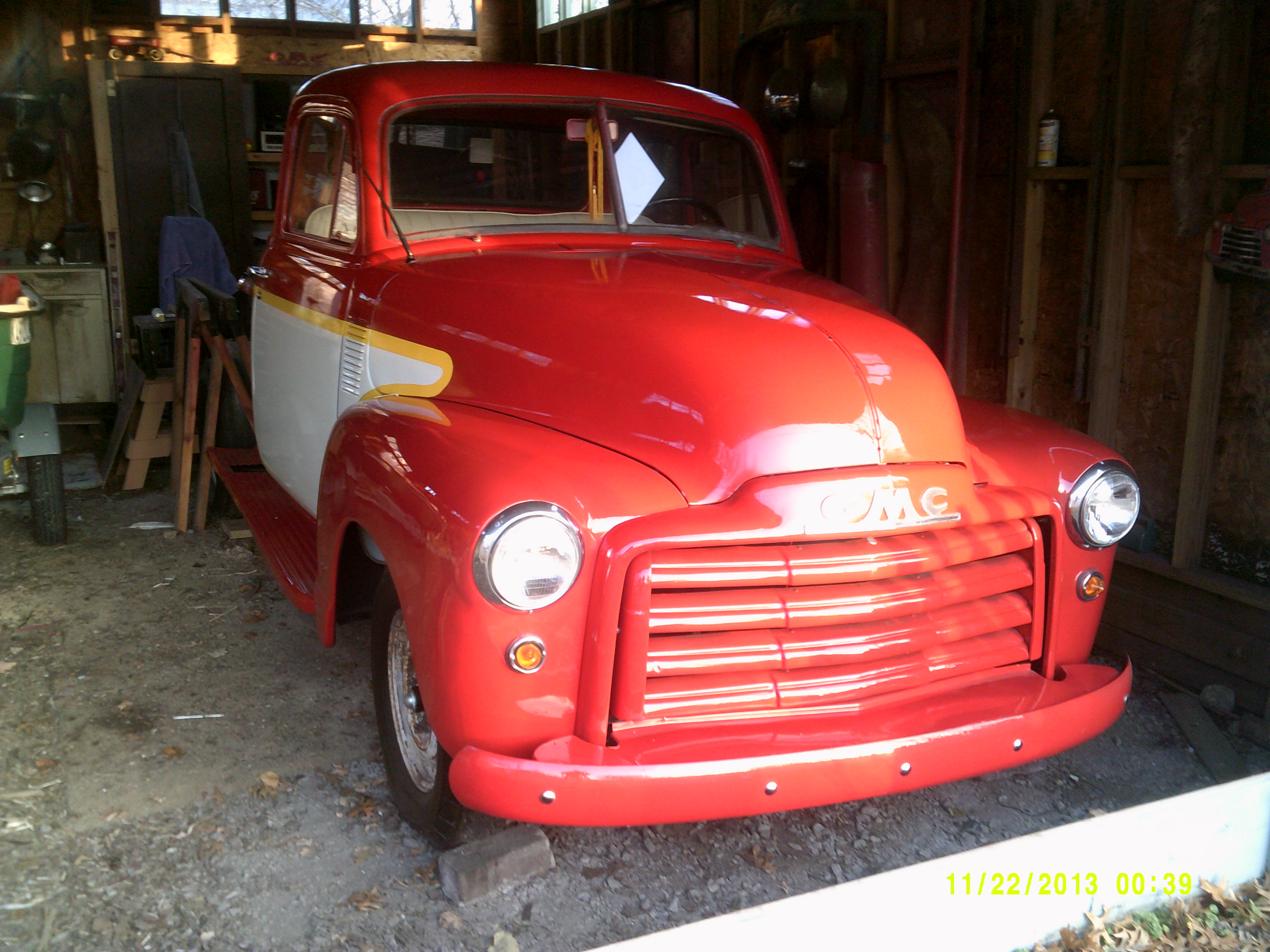

    DSCF0085.JPG DSCF0005.JPG I used the gravity feed Home Depot gun. Paint and clear. I think it turned out good for a daily driver. It laid on smooth enough I never worried about buffing or sanding, just washing and waxing. Not that there aren't runs here and there, but it's smooth overall, and I don't have to put signs up that say "look, but don't touch". Mine read "Go ahead and lean up on this thing and let's chat." #biggrin# DSCF0085.JPG DSCF0005.JPG

    Sorry for posting these pictures twice. I guess you can get a real good look at them this way.

    One other thing that may have helped was having a regulator right at the gun. That way I knew I had correct pressure right up to that point.
    The gun I got was a Husky HV. I believe it was around $45?
    Everything was painted out under the big blue sky. There are a couple of insects that wanted to be immortalized and there is a faint trail of cat paw prints across one of the doors.
    You know how cats gotta be~
    I only took mine to the one car show, and I got the feeling I needed to keep it parked far away from those high $$$$$$$$ painted cars.
