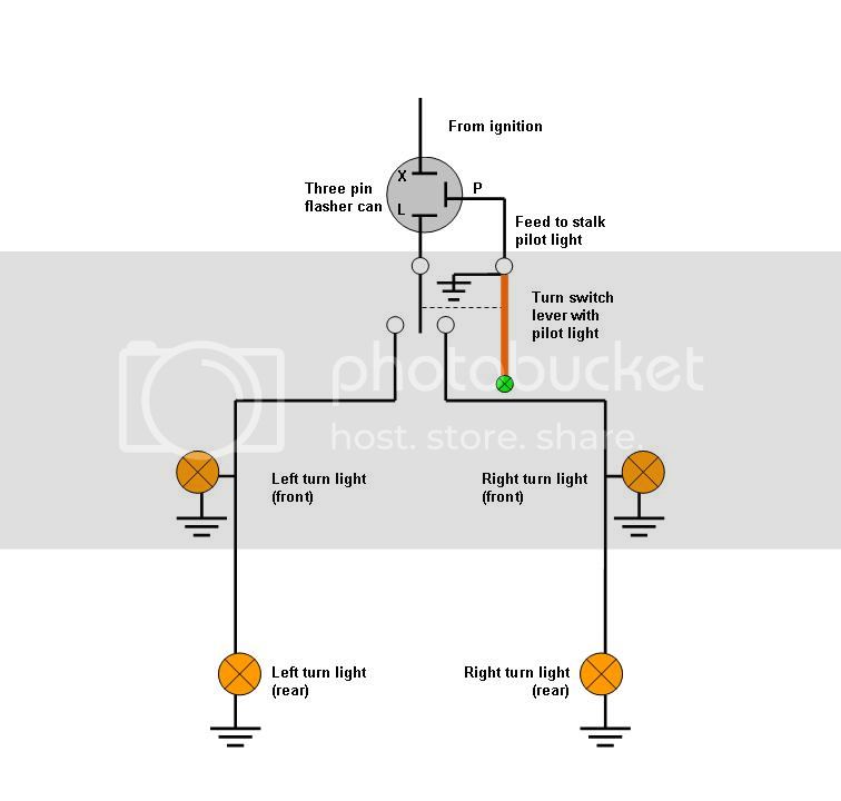

    thanks will do.. Another question the turn signal flasher I got with my wiring kit only has two poles and I think I need three according to my turn signal directions can someone tell me how to do this??

  8. Bill Hanlon
    2,791
    Morris Ranch TX
    Karen: The 3 prong flasher is just like the 2 prong flasher, with the extra connector used to light an indicator on the dash or handle to remind you to turn it off. You can use a 2 prong in place of the 3 prong if you don't care about the in the cab indicator.
    I (being an old guy without self-canceling turn signals) wired my indicator connection to a general-purpose 6-28volt beeper I got at Radio Shack years ago. Keeps me from driving miles down the road with my turn signals on. ;)
    Here is an example schematic using 3 prong flashers:
  9. coonkka
    coonkka Member
    Feb 8, 2011
    180
    Kansas City KS
    Thanks Bill for the diagram.. I like your idea of the beeper and the two prong flasher. Wiring the same??
  10. Bill Hanlon
    2,791
    Morris Ranch TX
    Using the diagram above, I connected the + terminal of the beeper to the X terminal of the flasher and the - terminal of the beeper to the L terminal of the flasher. The beeper was pretty loud (ask Ken), so eventually I wrapped it in paper towels and put it into a zip-lock bag.
