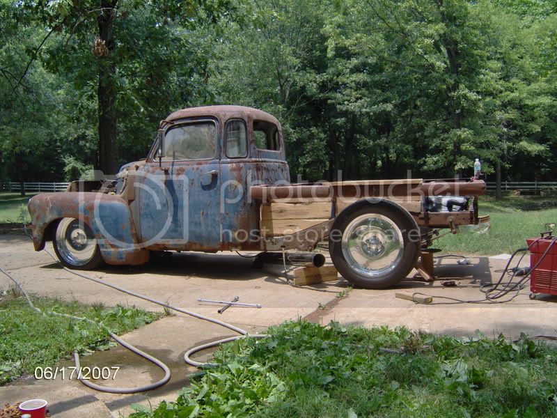

***Update (w/pics) on rusty/ratty 48 ***
Bed wood is finally cut and fitted
Made running board brackets

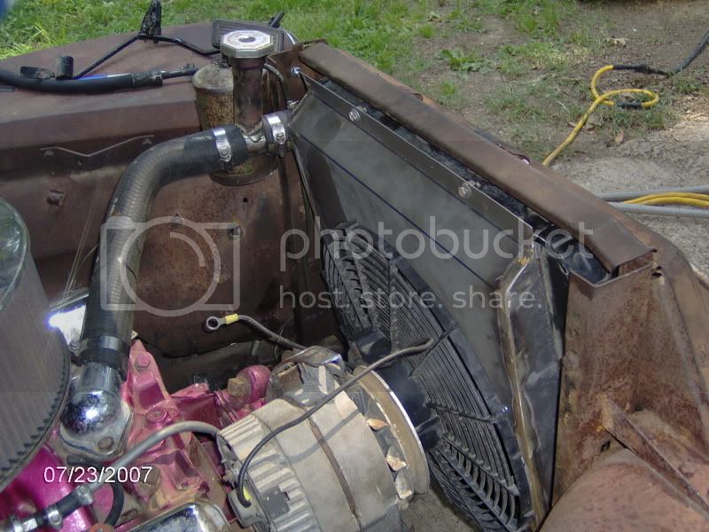

Got the radiator mounted. The old oil can is the overflow tank.

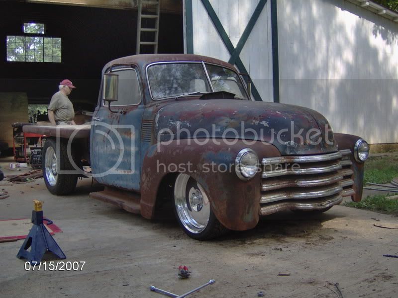

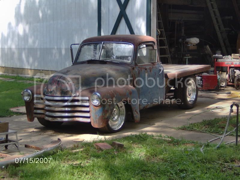

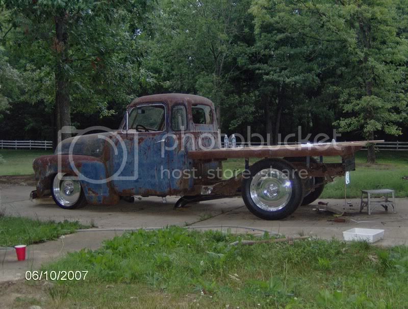

I don't know, Flipper~ I'm a fan of your truck. I have thought hard and heavy about a flat bed for mine. You know, the thought of me forgetting where my hammer is, or the thought of setting up a neat "little" platform to rock and roll from... well, a flatbed makes MUCH sense.
Anyway, look at your driver side photo verses the passenger side. I think the boardless side steps the whole thing in the right direction, making it look "right". The side with the board makes the leap from the end of the board to the level of the bed visually tougher to do.
These are of course the thoughts of someone up too late with too much grape juice, but- like I said, I'm a fan. You have the photos, what do you think?
In fact~ upon further review, you have seen the sign for a heartbeat~ (the straight line that shoots down then back up higher than the line was, then down not as far then back up to level again? That would be a great way to paint your truck IF you ever wanted to. Kinda like "teacher's" purple and silver, but playing more on the diagonal theme.
just my (even later at night) thoughts...
By the way, the purple part would include your bed metal. The purple would be no lower at the back of the cab then the bottom of the bed edge.
you know what I mean?

I have been struggling with the whole running boards/no running boards thing.
I was thinking that it had grown on me since I had been looking at it for two years without running boards.
How many people think I should go without running boards?

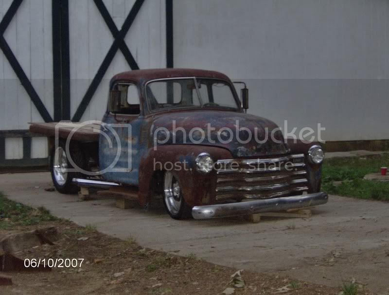

Hey Flipper~ You're one of those picture posting experts, could you sick in a shot from the backside that shows your truck without the running board? You have a good shot from behind with the board on, and a good shot from the front with the board off, but if you could post one from the back~ boardless~ that may help people decide.
My vote is "boardless".
Oh MAN!
(by the way GMC girl, flipper's ride used an S-10 frame, also... right Flipper?)
Yes, this picture lacks the wood you've put in to fill the void between the frame and underside of the bed!
BOARDLESS!
My vote is definitely no running boards.

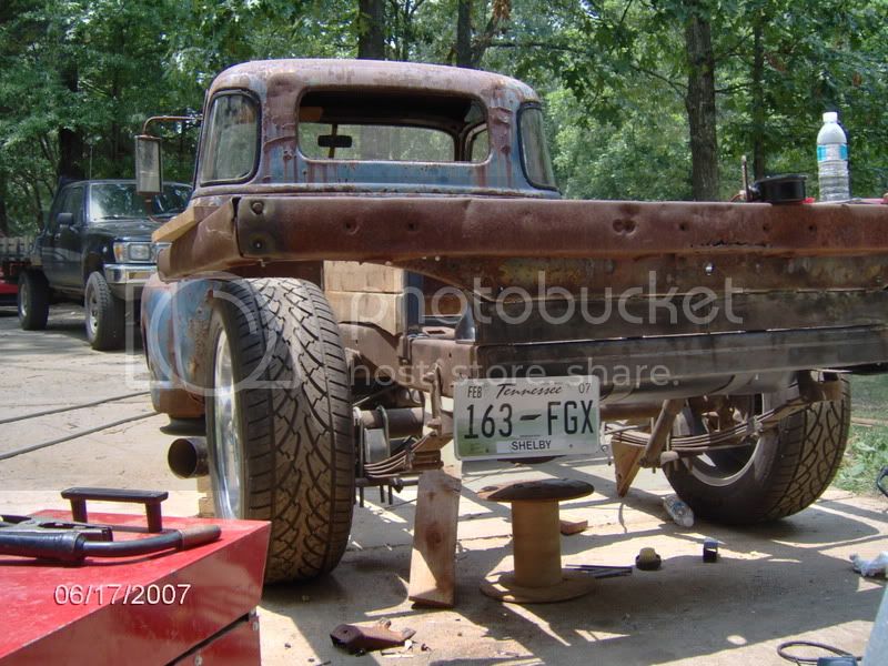

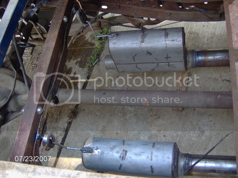

Where will your exhausts exit? Will they be visible under the cab. That might be a good thing.

The exhaust will hang down. Since the running boards were gonna kill the ground clearance anyway, I got the pipes down low ...away from the floors.
The pipes are huge. Dual 3.5" going to Flowmaster sprint car mufflers (empty box). The "chrome tip" in the picture is a 5" stack from a dump truck. I was gonna cut it in half and make two tips angling out after the running boards.
I like the idea of showing off the mufflers and chrome pipes. They are a lot more interesting than the running boards in this application.

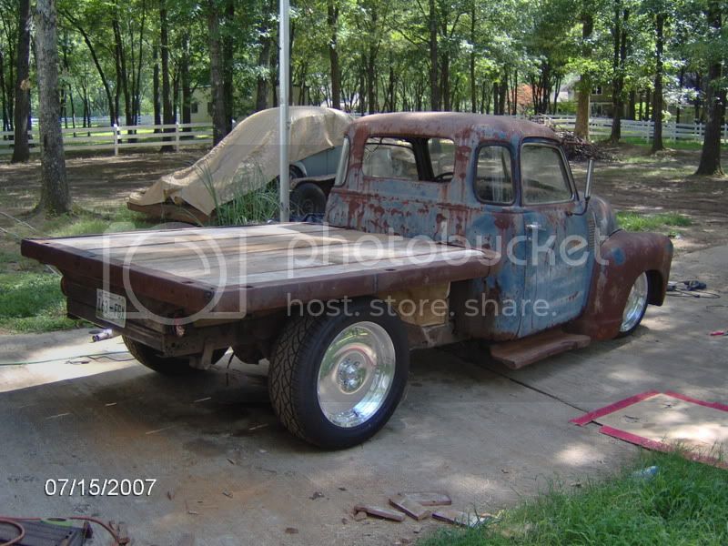

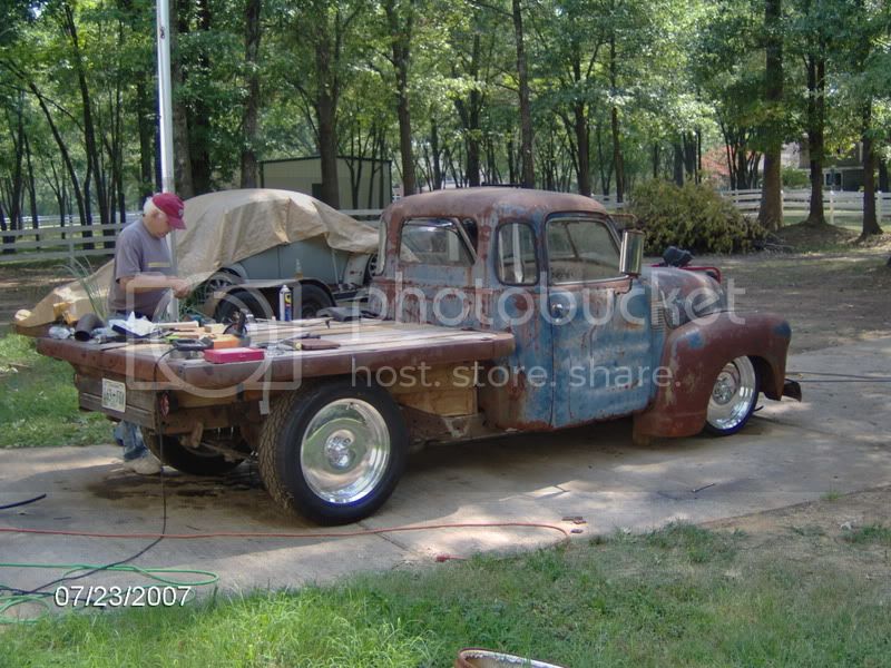

Pictures from this weekend
Exhaust pipes and front bumper are installed
Electric fan is mounted and fan shroud fabbed up

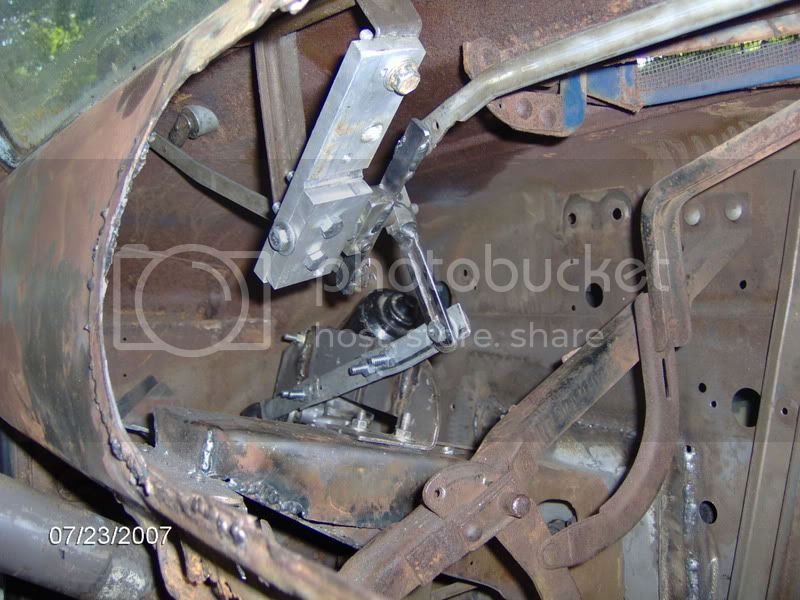

And the @#$%^!*&^!!!! electric wiper conversion is complete. It took forever to get the wipers to smoothly wipe the entire glass and be timed evenly.

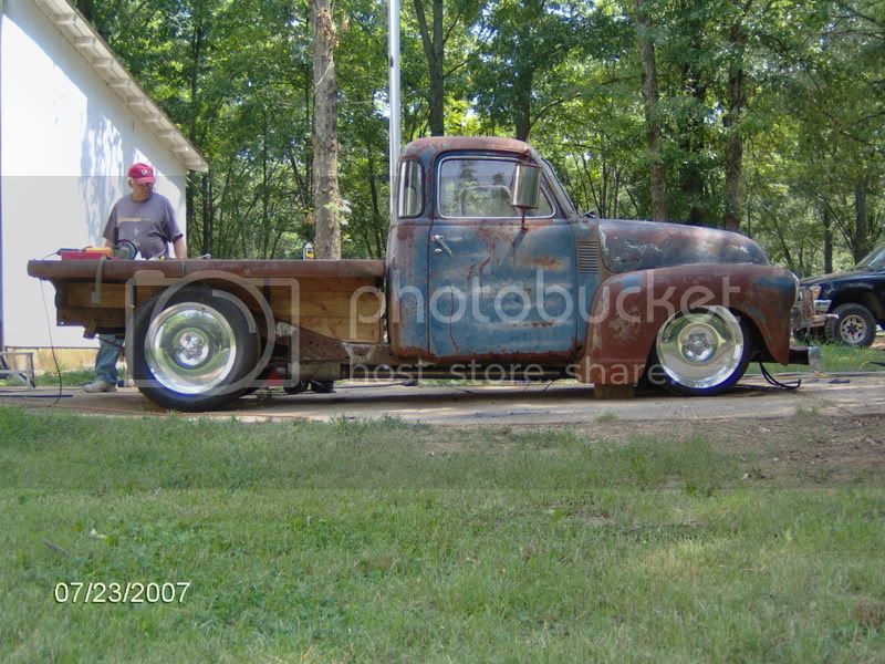

The flatbed works
