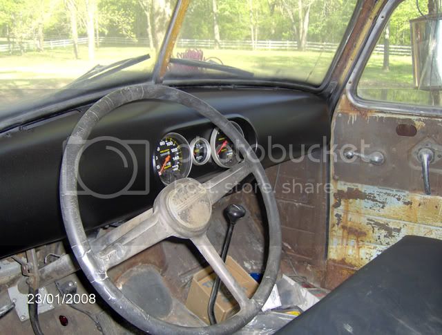

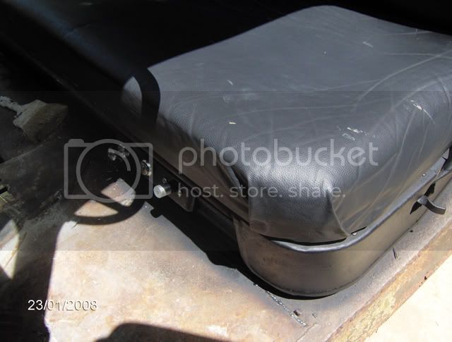

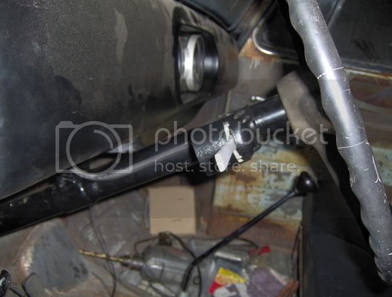

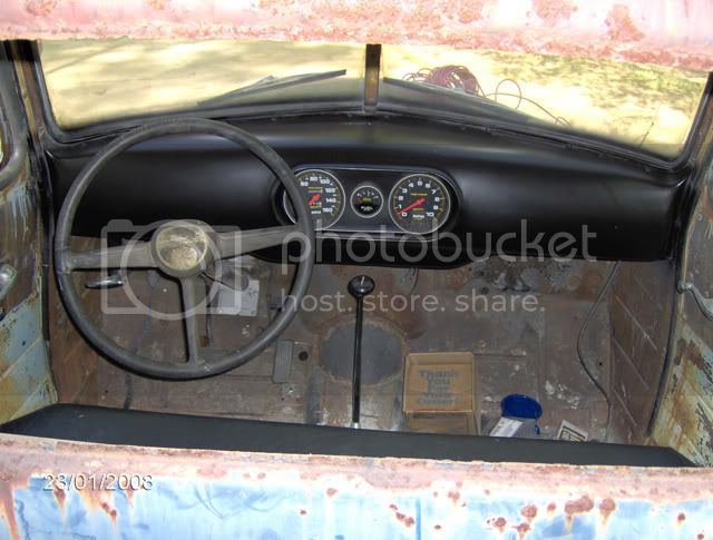

    I finally thought to take some pictures of the painted dash
    ....and the second "dash" (ignition, headlight switch, wiper switch and dimmer are in the seat base)
    Oh yeah, wiring is a pain in the butt!!!! I used an EZ harness. It would have been easier if I mounted the panel on the firewall....like they suggested, instead of under the seat. I had to "adjust" darn near every wire to make it work that way.
  12. Kens 50 PU
    Nice!
    The dash is really clean! I like the simplicity. Do you plan to keep the original steering wheel?

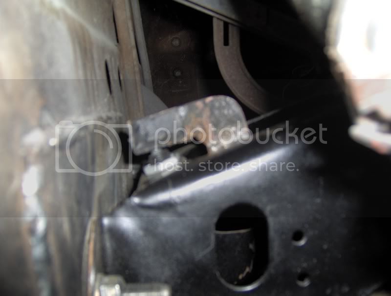

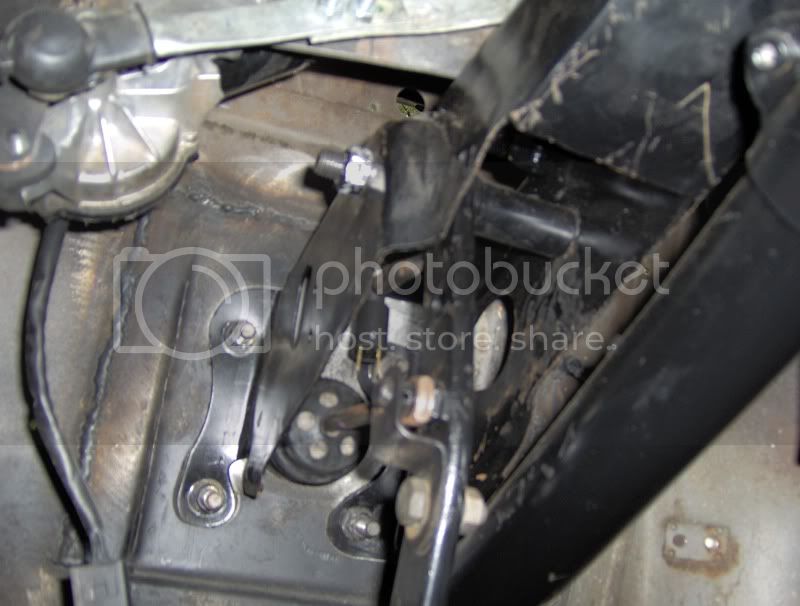

    Time for more build updates.
    This was my solution for the brake switch. I mounted a mid 80's GM switch in the top, rear surface of the S-10 brake bracket and then addwd an arm to the back of the brake pedal. The you hit the brakes, the lever moves up...and off of the switch. (I should have taken pics while the whole assembly was out.

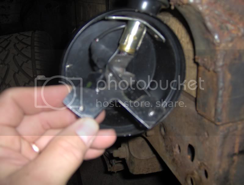

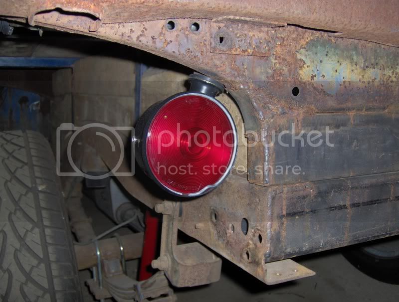

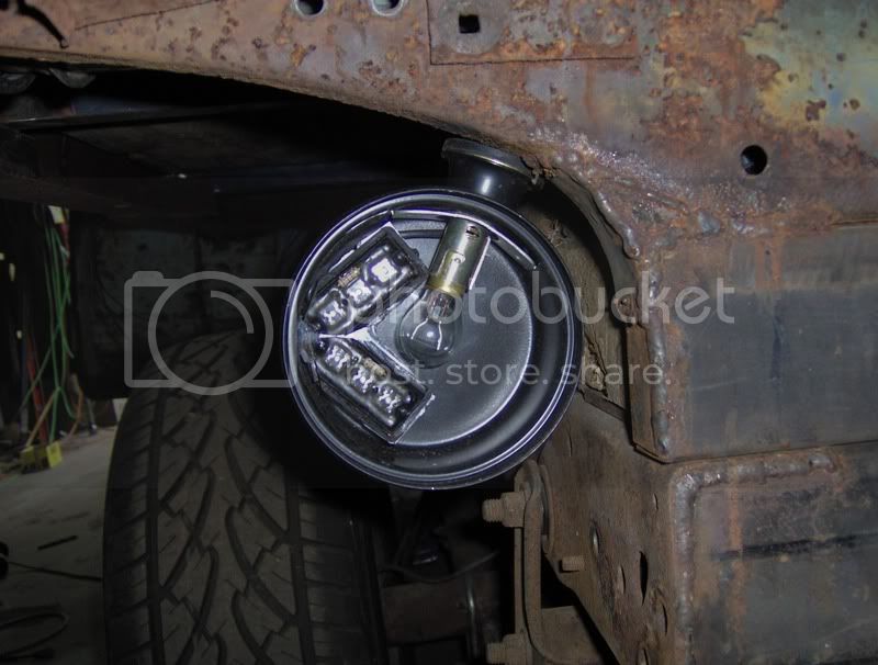

    Here are pics of my turn signals.
    With the lense removed. The arrow is made from 2 LED clearance lights from Wally-world.

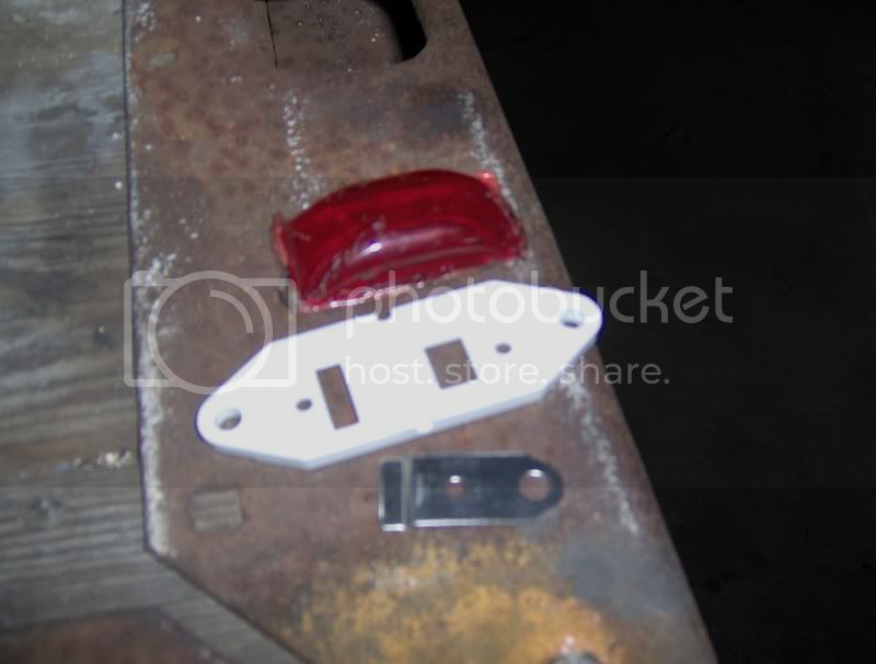

    These were the left overs from the clearance lights (some cutting required)
    I made a bracket from a piece of jaguar XJS chrome (I recycle)
    I re-used the OLD turn signal switch that was in the truck when I bought it (spray-bombed of course). The wires are pulled through a piece of un-shrunk heat-shrink tubing. Looks nice and it was damn near free.
