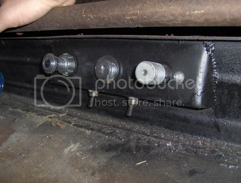

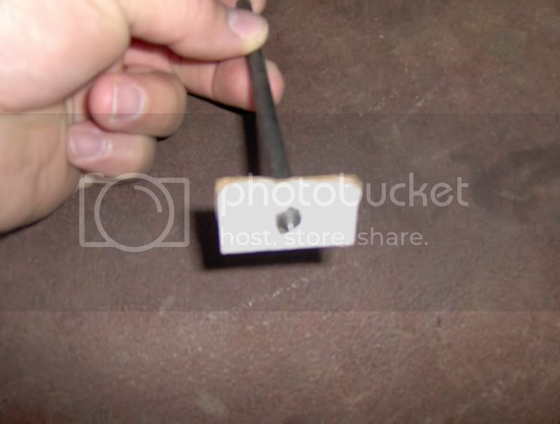

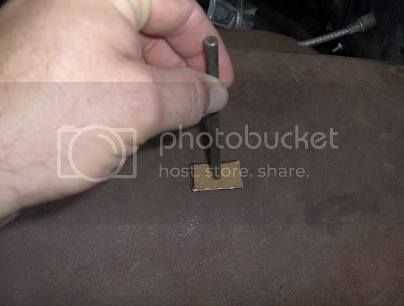

    I realized I need more switches (electric fan and hazard lights), but didn't want them mounted just anywhere. I squeezed them in my new "seat dash"
    It was a tight fit trying to fit them in the switch panel that was not designed for any extra stuff. I made a cardbodrd template that was the same size as the switch and used a cener punch to find a spot where the switches fit.
    It worked great!

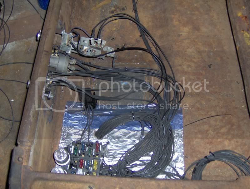

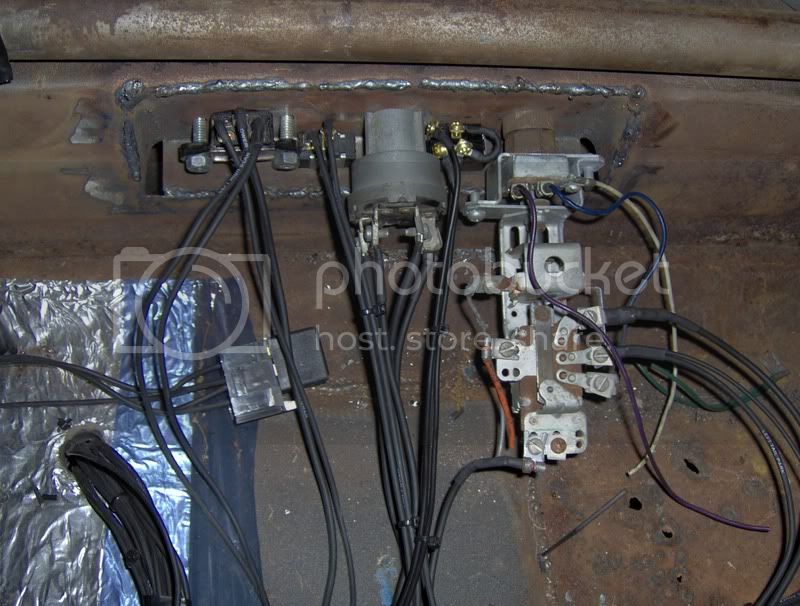

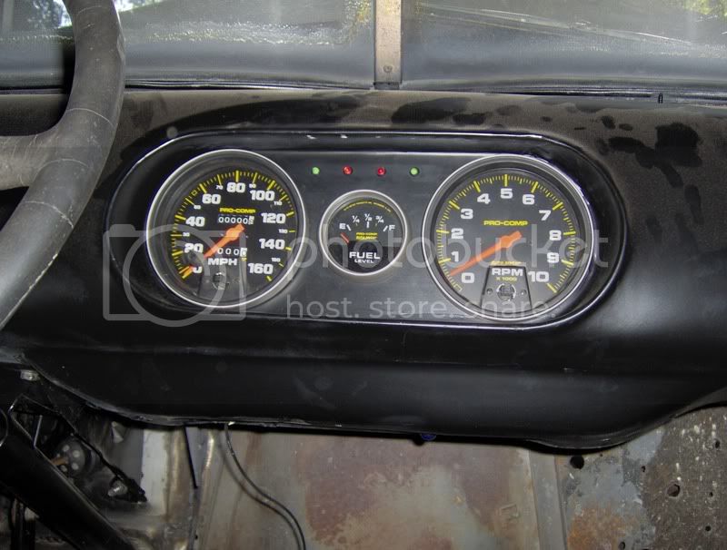

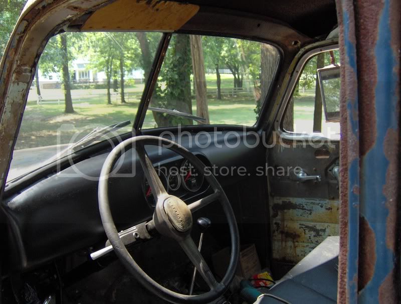

    The dash-dash now has idiot lights. The outside ones are for turn signals, the inner ones are oil pressure and water temperature.
    Wiring that stuff up.....sucked!

  5. vwnate1
    11,703
    You're Talented !
    When are you going to post up some pix of the rear turn signal illuminated ? in the dusk please...
    That's very clever .

    One tiny thing......if i may be so bold:eek:...... i would make a metal cover over the rear of those switches if they are under the seat, but im paranoid about fire hazards.

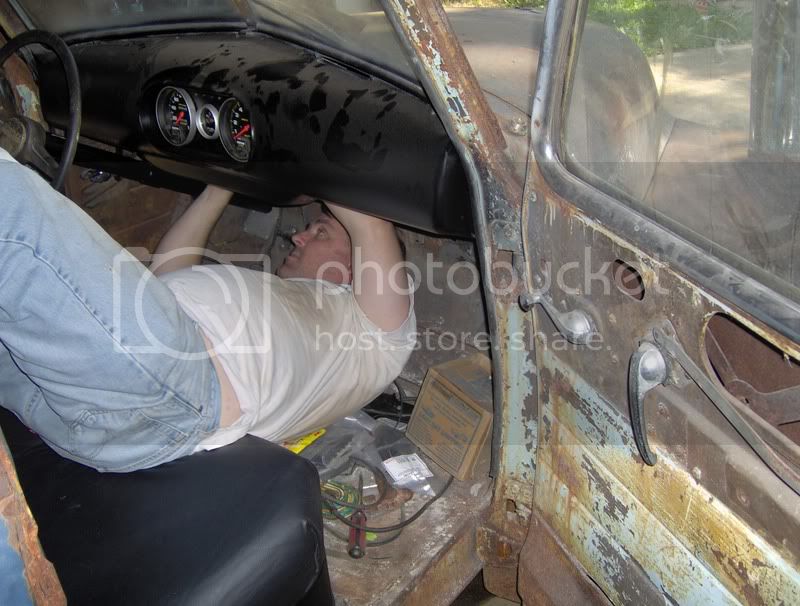

  7. Kens 50 PU
    Man, my back started hurting just looking at the pics of you wiring things up. I know the name of a good chiroprator, but he's in New York!;)

    I was a little concerned myself. :) That is one of the reasons why the switch panel has that much angle on it....to get the switches down out of reach of my butt.

    My back doesn't feel it, but the top of my head is as sore as all get out. I don't know if I hit something sharp down there or it was 200 lbs of gravity mashing on my scalp :)

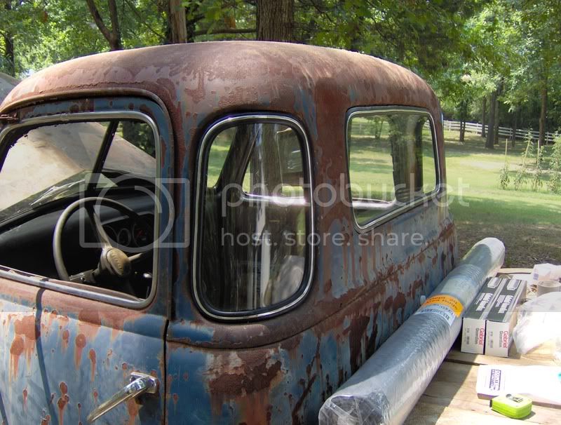

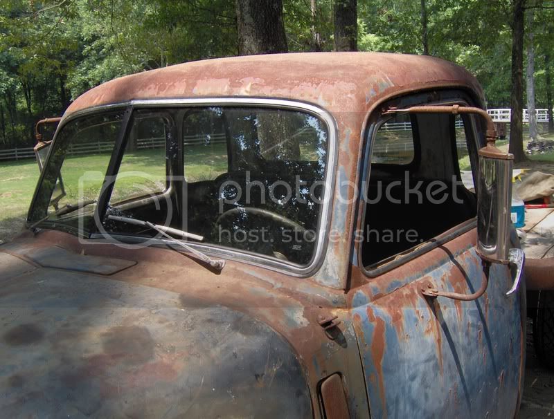

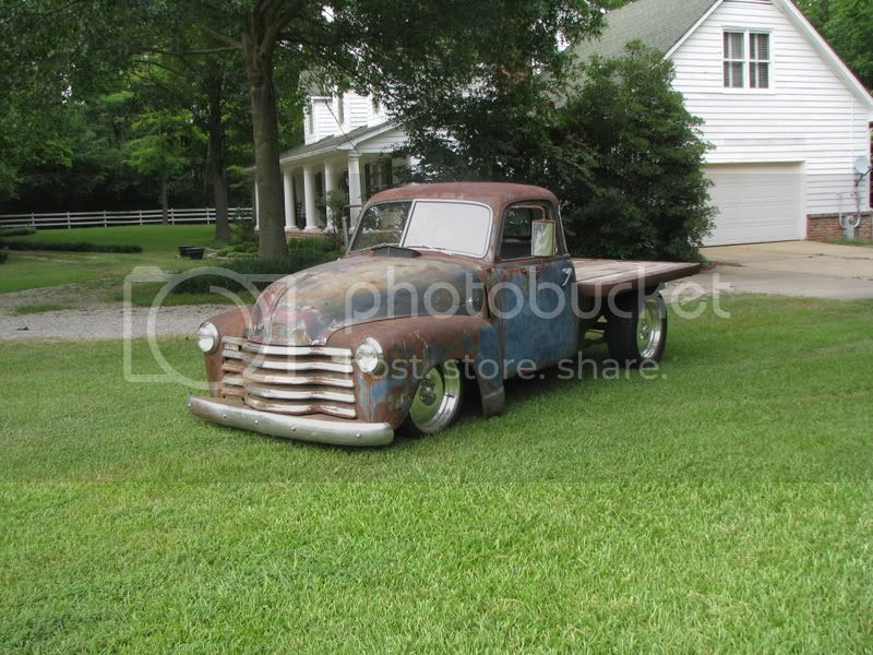

    I have glass that I can see out of !!!!!
  11. Chiro
    Chiro Member
    Sep 3, 2006
    1,314
    Nice job on the glass. Where did you get the gaskets? The front gasket sure fits better than the one I got from Steele for my '55.1.

    Nice job where did you get the windshield wiper blades from?
  13. Flipper
    Flipper Member
    Oct 17, 2005
    133
    Classic Parts.
    It still needs a little more love to get seated just a tad more. The center rubber strip doesn't quite make it back to the center divider. I know what I need to do....lube everything back up and work the seals outward and the glass back into the opening.

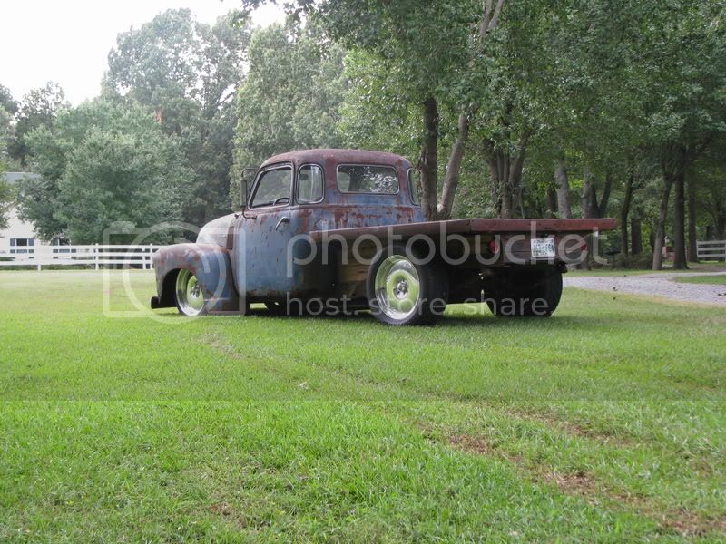

    Man, what a hot nasty weekend for working on a truck!

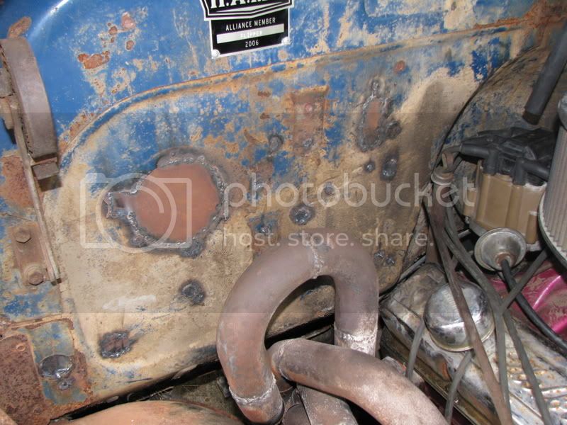

    I started out by making a ton of plugs for all of the holes in the firewall.
    Yes this was fresh, clean metal a day earlier. 100% humidity sucks! I welded them in from inside the cab to preserve the 60 year old dirt on the firewall.

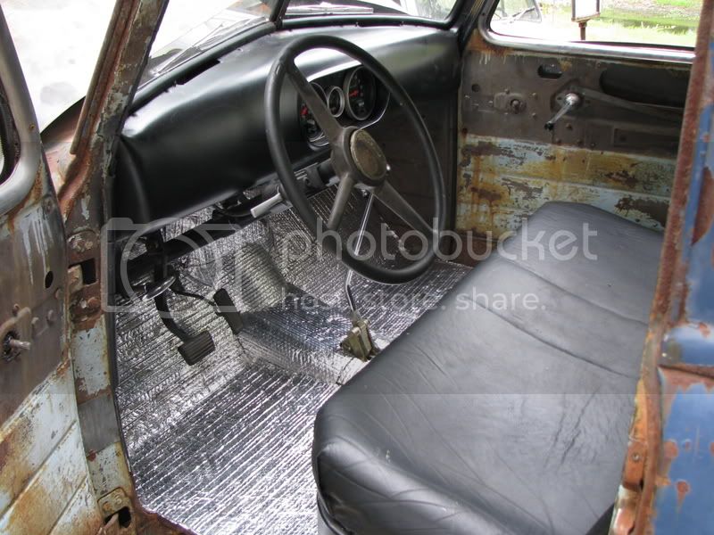

    Then I installed bubble wrap.

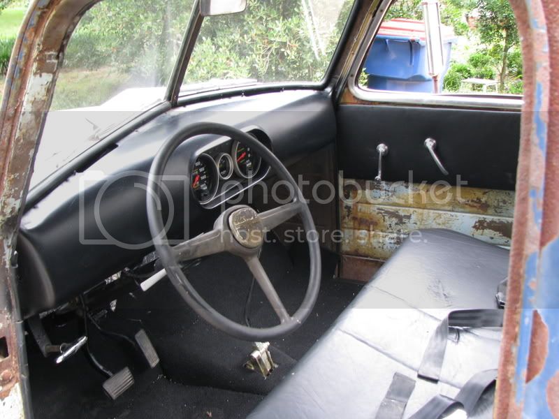

    Then installed most of the carpet. I still need to cut pieces for the firewall. I also attempted to make door panels, but the clips I had were too short and didn't really work.

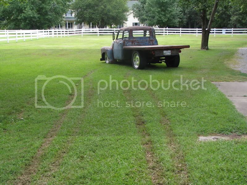

    Dad didn't want me doing burnouts on the concrete, so we rutted up the yard :) One set was mine, the other was his!

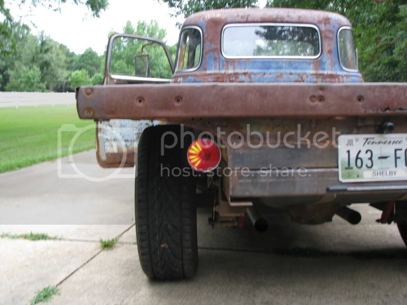

    I went ahead and snapped a few more pictures...including one of the blinkers for whoever that was asking.
