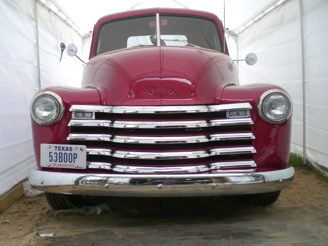

    The good news, me and a friend Wayne worked on the Boops ride most of the day. Got the bumper all mounted... Looks great... Ken, that cheep taiwaneeze grill sure stands out... ain't to bad from a distance but I wish I had the real thing.

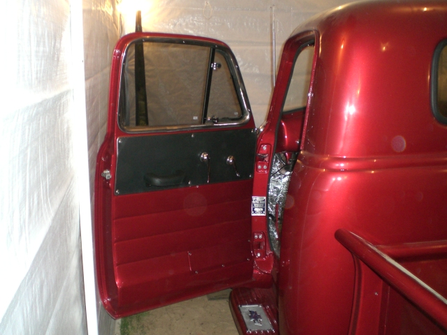

    Got the doors adjusted better, we followed the book, we followed the posts, we followed the yellow brick road and had to compromize with a fair fit, not perfect but the doors shut and the latches work (after I worked on both) and the space is acceptable.

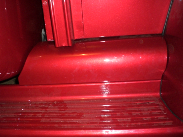

    We got the drivers side running board and apron on with the chevy step plate, now it looks REAL good, sets the old hoopie off real well.

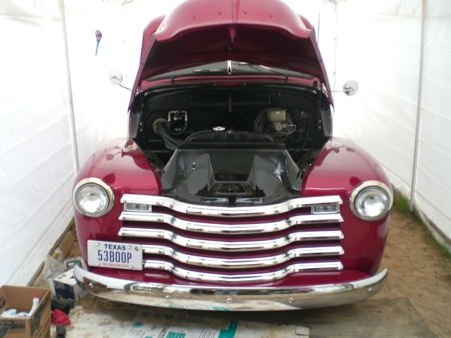

    Bumper nount
    We used a piece of 3/8 plate, cut it to 2 1/2 X 4 inches, welded it to the end of the bumper brackets which we cut to the right length. We took the plazma cutter and cut 4 - 7/16 X 1 inch slots in the piece of plate that you and I installed as the radiator support and WHAAALAAAA. It fit like it was made to be that way.. .. I'll get some pics up as soon as possible.

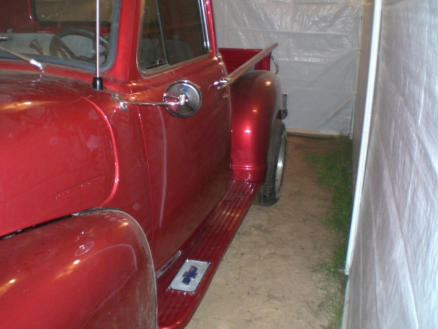

    Pics of progress
    Here are a few shots of the bumper, running boards and aprons, as well as completed door shots. More later:D
  6. Kens 50 PU
    Wow!!
    Now that's what I call a ride! Don't forget that we disconnected the ps pump hose. Don't forget to reconnect that (friendly reminder)! Awesome job on the bumper!

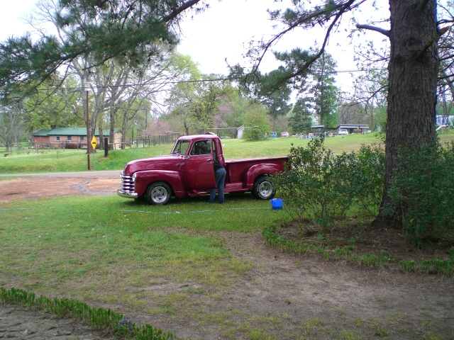

    Out for a washin
    Well the Boops ride is out front for a washin, I think all we like is the misc wireing then a test drive the first of the week. We'll post some pics of the washed hoopie sometime today. Stay tuned, excitement is risin, the Boops feeling mucho better with a big smile:D

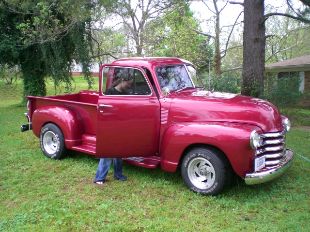

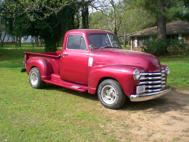

    The Boop was so excited, and you all know how your little girls can get just about anything with their cute little smile... We'll she said "do you think I could drive it around the block". Dad took one look at that beautiful little lady and said "you bet"... So around the block she went, waving at everybody who was anybody and anybody else who looked her way. No blinkers or stop lights but the radio worked and the truck looked pretty good, now my little Boop, WELL, SHE LOOKED RADIANT!!! :D It was worth every minute of the past year of work...
    Here are a few pics, I'll let her post more later.
    TB'sD
  13. Kens 50 PU
    You go, girl!
    Now that's what i'm talkin' about! Get the bling on the hood and we're there! You know, guys, these pictures don't do that paint job justice. 3 different metallic flakes in that paint. Depending on the light, this thing takes on different shades! MOST AWESOME!
  14. Zig
    And to know that ride has electricwipers is even better! TB'sD- Get ready. Your daughter behind the wheel of that truck as she goes down main street???
    Get ready!
    That is one AWESOME ride- well worth the wait.;)
