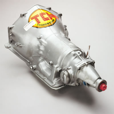

TCI street/strip 350 transmission with extra clutch packs and a manual valve body.
With the manual/automatic valve body, it allows me to manually shift the vehicle into each gear or place it in the drive position to remain fully automatic. In either mode, I get a shift that bangs through the gears. When I use the manual gear selection feature, the StreetFighters upshift and downshift right when I move the lever, with no lag or governor override.

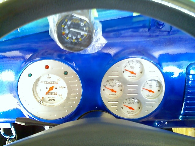

New auto meter guages in the original holes.

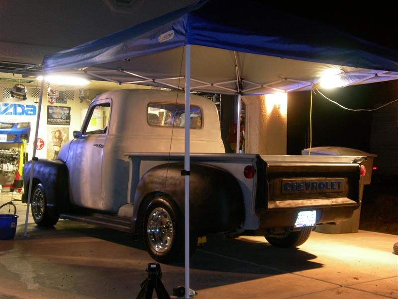

We mounted the motor low and forward with custom motor mounts. This way we could fit the motor and the huge distributor in with out cutting the fire wall. AFter we got the drive train all in we noticed that the rear tires were too far forward in the wheel well. So we moved the fenders forward until the wheels were centered. Then cut and reshaped the running boards to fit.

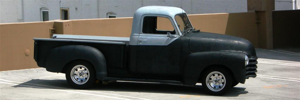

I got tired of the multicolored truck so I did the whole thing in gray primer.

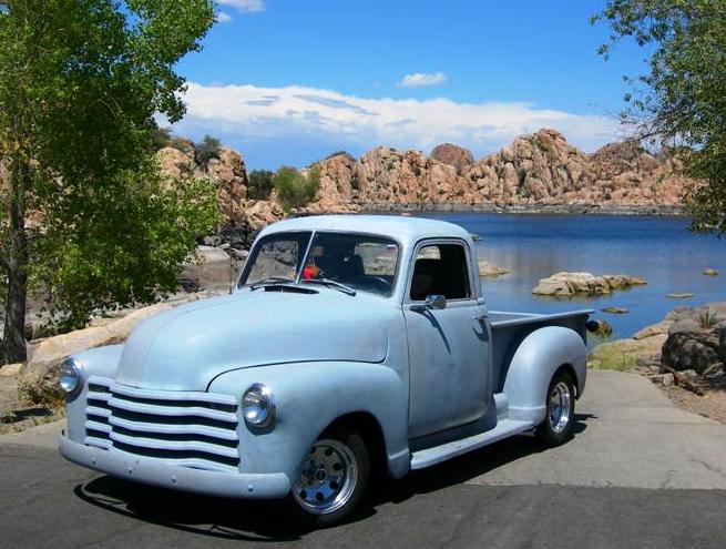

Willow Lake in Prescott.

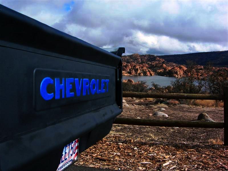

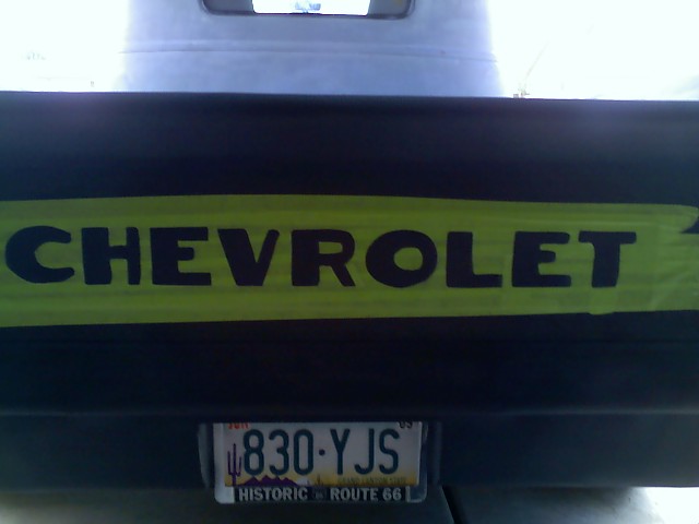

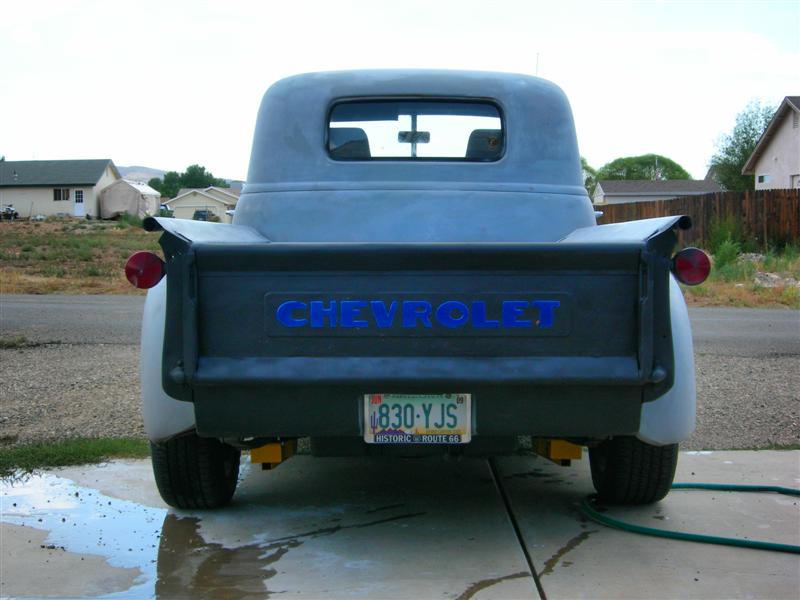

I got bored and decided to primer the tail gate in black primer then tape off the letters CHEVROLET and paint them laser blue.
Since I just couldn't leave the tail gate black I did the fenders in black too.

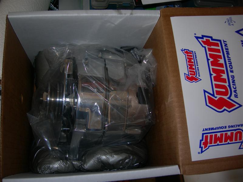

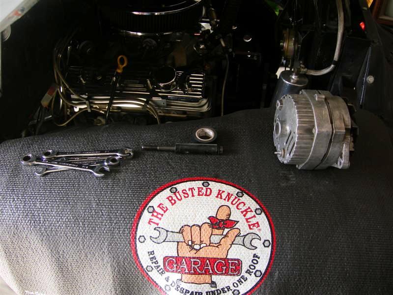

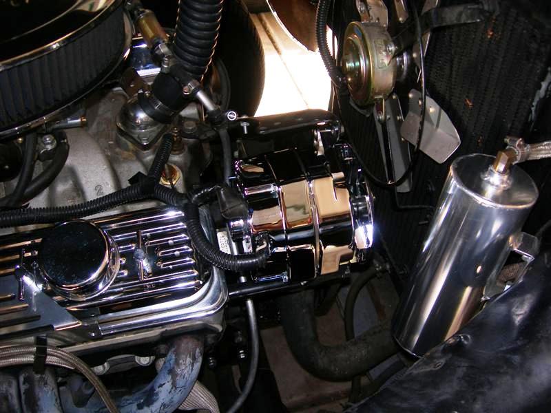

We had an alternator on the truck from a junk yard. The internal regulator decided to wig out and spiked to 18V one night on the way home from the movies.
So I used it as an excuse to get a 100 amp chrome alternator. :D

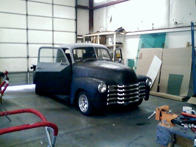

I drove around for a while with the black fenders and tail gate. Then got bored with that look. All the while I have been trying to decide on a paint scheme that was different from the rest. I know I wanted a two-tone but wasn't sure.
Blue is my favorite color so That would be a part of if. My other car is (gasp) an import tuner. A friend and I did a custom paint job on it last year. So far in 2007 I have won 3 trophies at car shows. (1st, 5th, & best of show)
Enough about my rice burner.
Anyway The blue is a custom mix with blue pearl added in. I want to use that on the truck. Since I'm a Dallas Cowbows fan and my wife's old school colors are blue & white we are going with a contrasting color of silver.

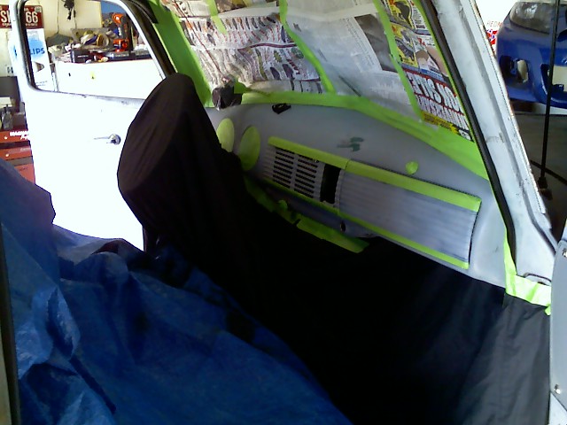

So the truck will be blue & silver. I wanted something different so one afternoon I taped off the truck and came up with idea.

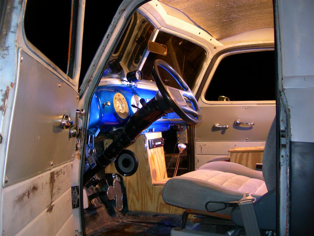

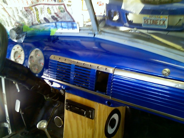

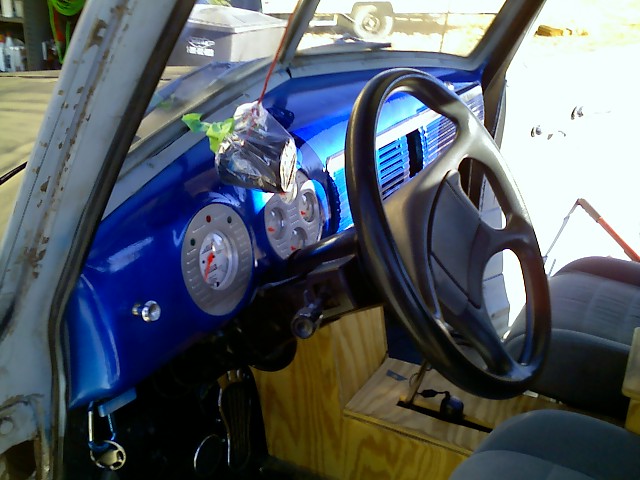

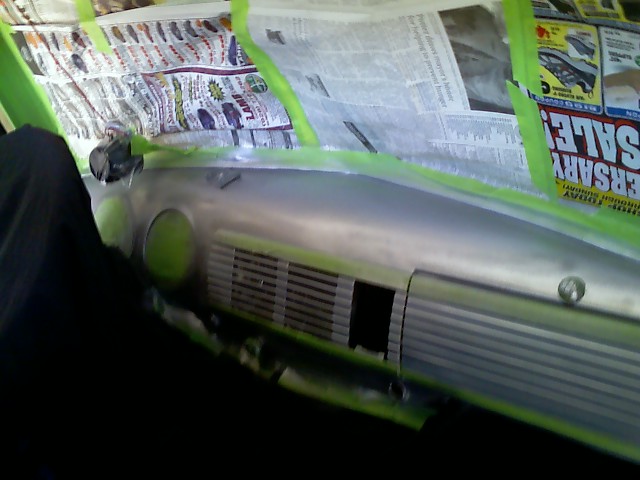

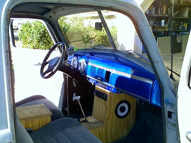

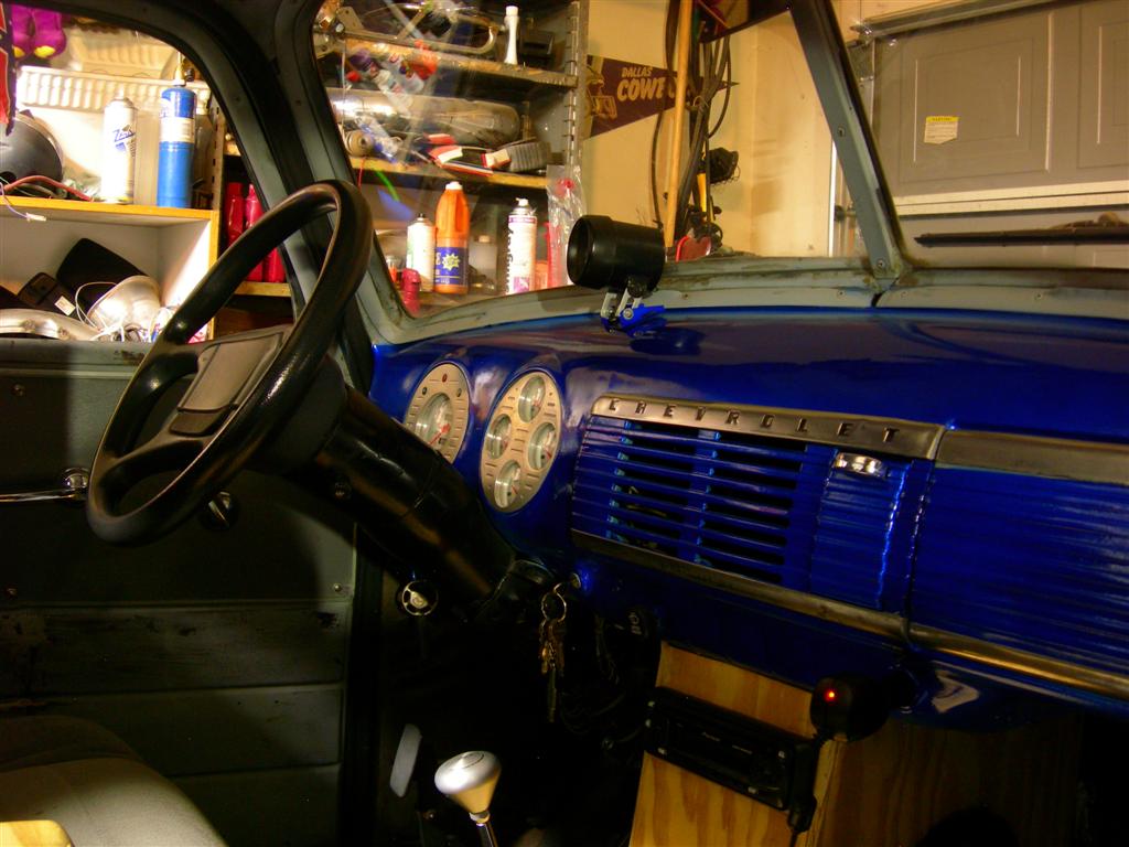

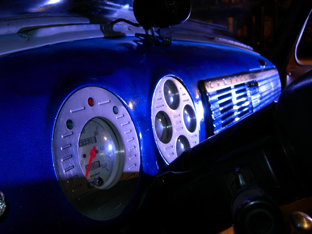

Since I had blue paint in rattle can, I decided to see how I liked the dash painted blue. The only down side to this experiement It that when I paint the truck for real I'll have to sand all this off.
sanded and primered
metalic base coat
camera phone picture
Here are more pictures.
I also did the doors in blue & silver.
Keep in mind this is all temp paint done just to get ideas.

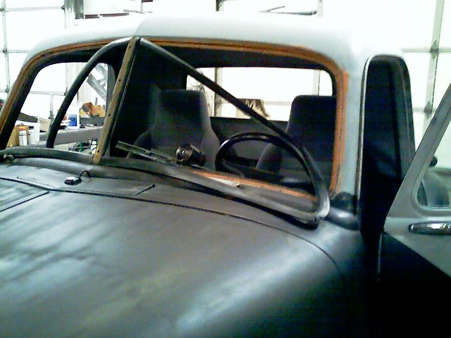

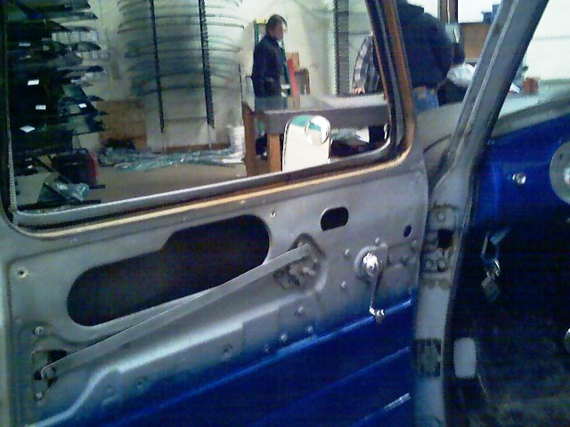

The driver's door window had a crack in it. There was a rock chip in the driver side front window.
We have 100% glass coverage with 0 deductable.
So I called the insurance Co and made an appointment for yesterday to have a new door window and a chip repair. We have new weatherstripping for the front windows. So I asked how much to replace the weatherstripping while the truck was in the shop. They quoted me $40. Fair enough.
The glass shop pulled out the broken door glass and cut a new piece of glass.
After that was done they pulled out the weatherstriping and repaired the rock chip.
When they went to put in the second windshield it broke on the drivers side.
CRAP
Well the glass that was in the windshield was clear. All they had in the shop was the smoked. The Manager couldn't just put in one smoked and leave the other one clear. So he replaced both front windshields.
When I asked for the bill for new windshield glass and weatherstripping instalation The manager said it was too much fun working on a truck that was older than him by 2 years. Its free. Have a nice day and take care of this old rig. She'll treat ya good!

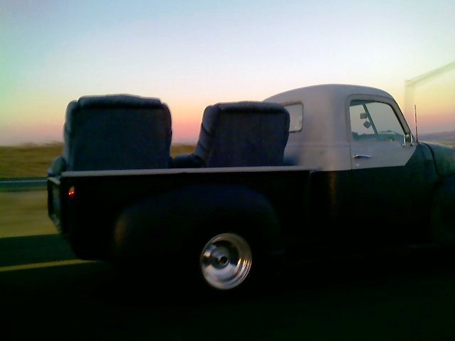

On the way home I stopped by my in-laws house and they gave us two recliners. So here is a picture of the hot rod actually hauling a load down the highway.

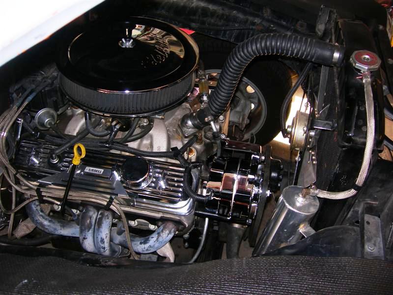

The Chevy has an oil leak from sitting too long while under construction. With the Route 66 fun run car show coming up I needed to fix these leaks. ( www.azrt66.com )
The front seal is leaking and its leaking at the back of the intake manifold.
We cleaned up all the sludge from underneath the truck and pinpointed exactly where it was leaking. I got all new gaskets .
We also installed some chrome door trim around the cut out on the fan shroud.
