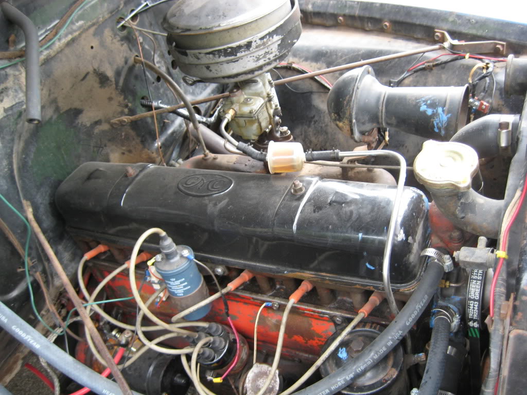

    oh and one to make it up to ya Zig!!!
    See that long motor!!! OH yeah:D:D
  14. vwnate1
    11,703
    OO-Wee !
    Drool....
    *pant*pant*pant* .
    Sorry guys ! I have SERIOUS ' Long Motor Envy ' issues .
