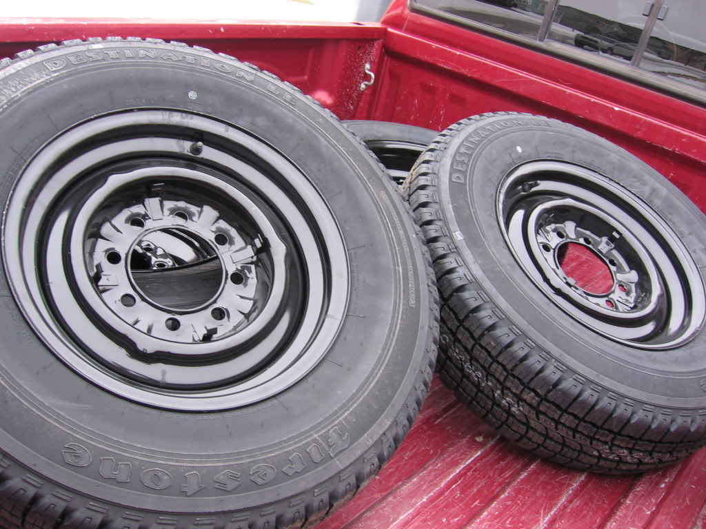

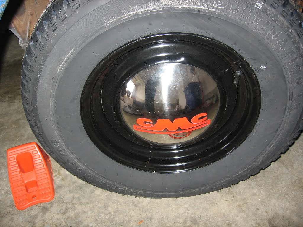

    They are a thing of beauty!!! Nate you best be sittin down when you see this pic;):D
    Its great to see a lot of oil pressure when running 45MPH, my top speed, with a bed full of something when it was 105F this summer!!! Gotta love the GMC;)

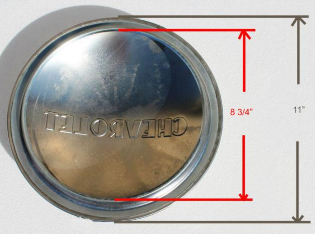

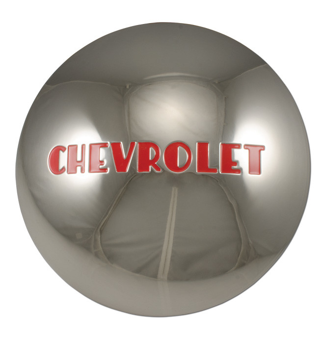

    Wolf, I have 1954 Chevy 3/4 ton truck. I will buy 8 lug new steel wheel (AM20766) from etrailer.com too...
    I want to use baby moon hubcaps as you. I want with red "chevrolet" letters moon hubcaps (47-53).
    Seller said that 47/53 3/4 ton with letters hubcaps outside diameter is 11 inch , inner is 9 inch. I dont want without chevy letters hubcaps.
    Can I use this hubcaps with AM20766 ? Thank you..

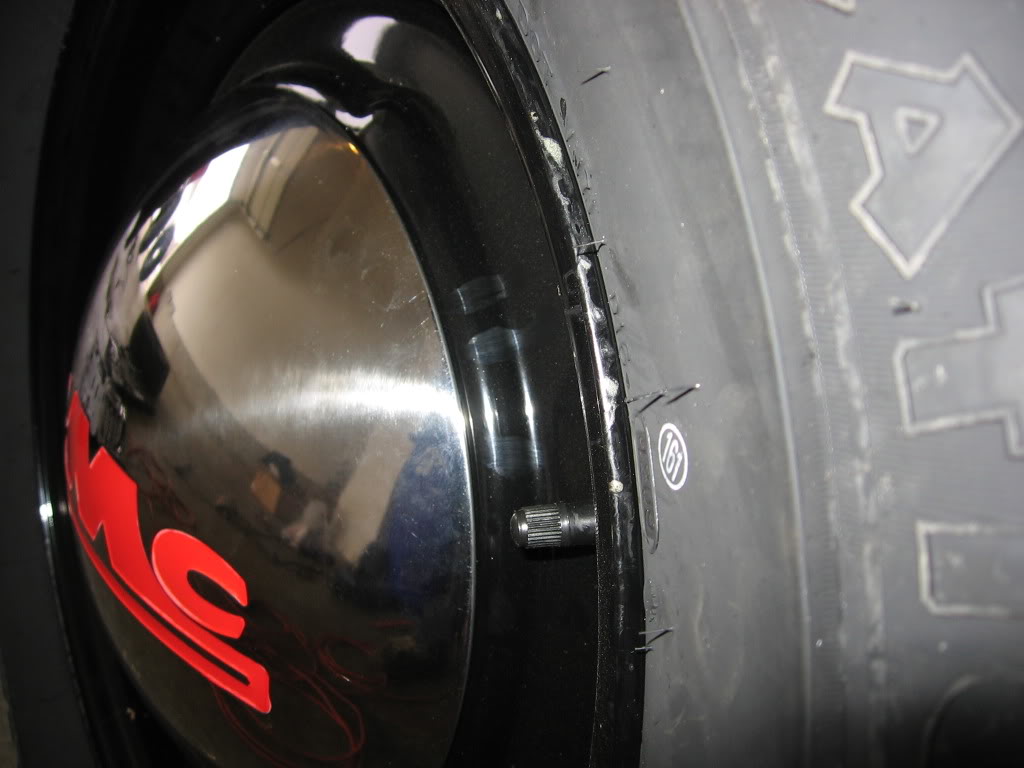

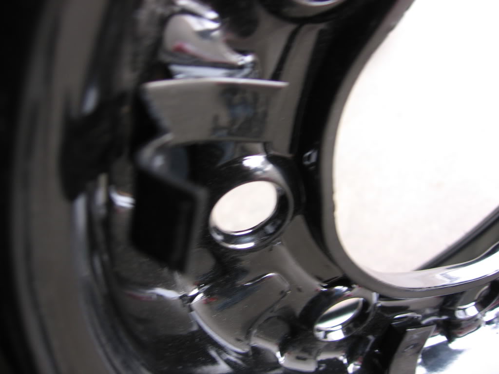

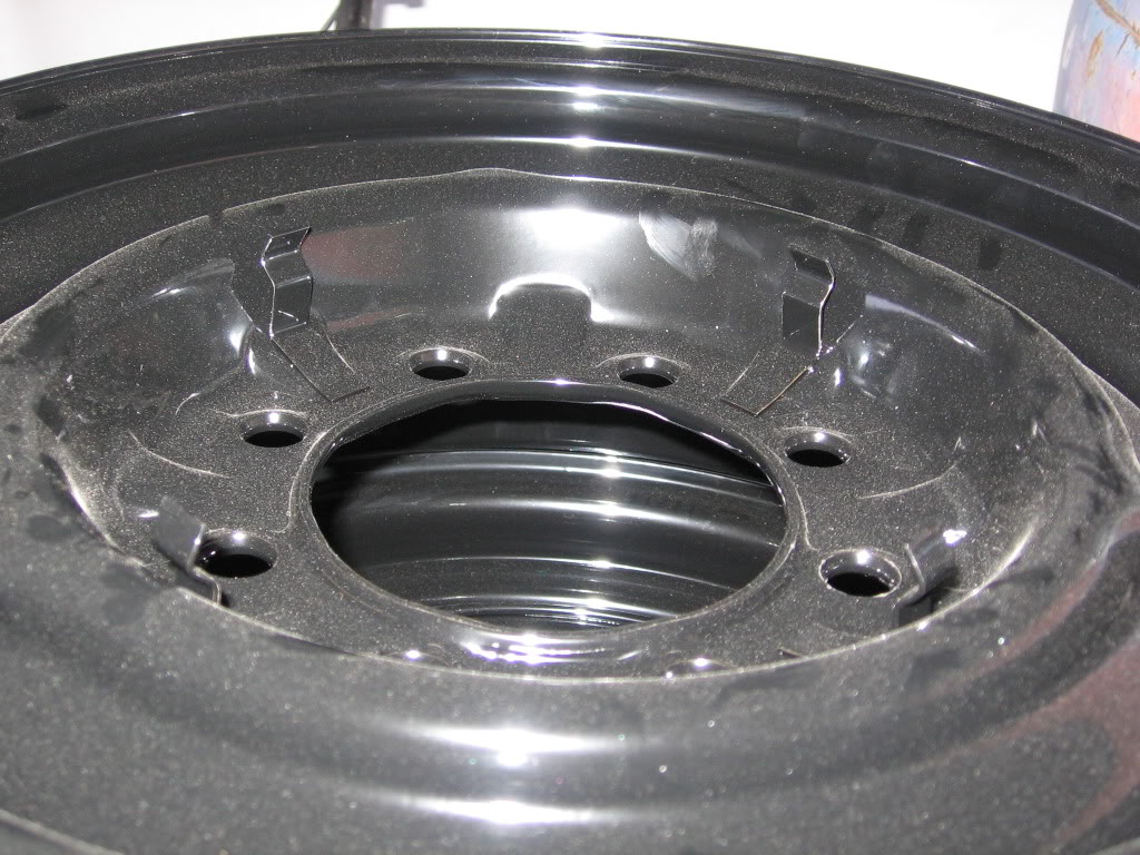

    Well hello! Sorry i actually sold this truck last summer. The hub caps I got for my truck were from Jim Carters. They were exact replicas of my original ones. My original ones basically turned to swiss cheese after the sand blasting. But they fit those rims perfect. I did have to custom make the clips that held them on.

    This is why I keep answering questions on my post "New wheels and tires". I don't want to buy something that won't work. Why do some trucks have 8 lugs vs. 6 lug, or 15" vs. 16"? Was this a Chevy option or a difference of 3100 vs. 3600 or Chevy vs. GMC thing?
    Also note OP has clips for hub cap. Those are missing on a lot of wheels currently for sale. I have looked all through Dexter website and cannot find what I need.
