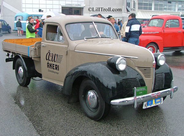

    Wokri man i disagree with you!
    If you know your stuf its easy to do it, so i disagree with you about the way you critizise this construction of the ignition. As you are an Volvo intrested guy i can tell you that Volvo there pickup truck also uses the inline six with the same setup from that 50. period. If the system whas a bad one why copy it from GM. Emotions.....emotions dont let them get away with it. By the way what kind a Volvo are you driving anyway? Does it have the same setup as your truck ?
    http://www.youtube.com/watch?v=ybNw_3MaFj8
    http://www.youtube.com/watch?v=H0bqiUxLMcw&feature=related
    Happy ending.
    VOLVO PV60-1 IN PRODUCTION 1946-1950
    The PV60 was the last of the large six-cylinder passenger cars from Volvo with a traditional side-valve engine. The design of the car was relatively old-fashioned, as the American lines had changed drastically during the war. The car became very popular, primarily because of the comfort it offered. Most of the cars were sold during the late 1940s.
    Volvo's first post-war car, the PV60, was also offered in bare chassis form as the PV61. Five hundred of them were produced and transformed into delivery vans or light trucks, except for a handful which received elegant drophead bodies.
    TECHNICAL SPECIFICATIONS
    Model: PV60-1
    Variants: PV 61 Chassis
    Produced: 1946 -1950
    Volume: 3006
    Body: Saloon or chassis intended for special private or commercial bodies.
    Engine: In-line, 6-cyl, side valves; 3,670 cc; 84.14x110 mm; 90 bhp at 3,600 rpm.
    Transmission: 3-speed with overdrive, steering column gear change.
    Brakes:
    Dimensions: Wheelbase 2,850 mm.
    Misc
    http://www.youtube.com/watch?v=Brjl5il3f64
    Martinius.
