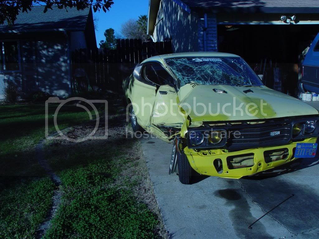

    bringing this back from thread death progress has come to almost a complete stand still due to an accedent january 15 2009 my other car my 76 datsun 610 was t-boned and distroied
    got tore up to
    so i ended up building another one

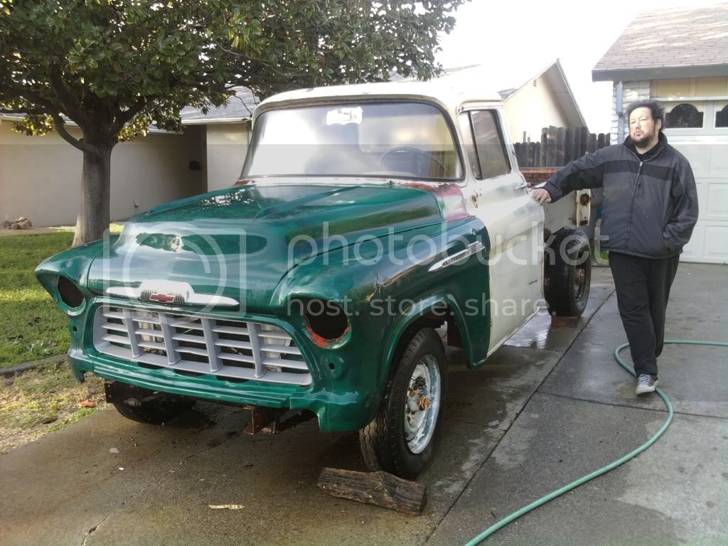

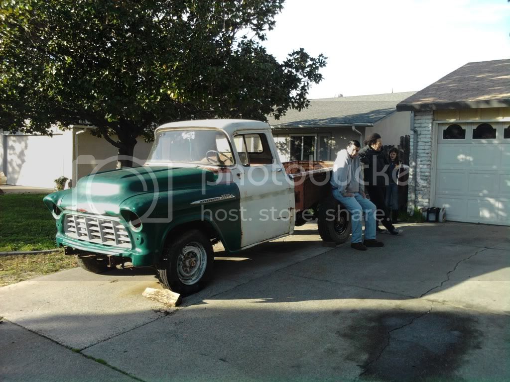

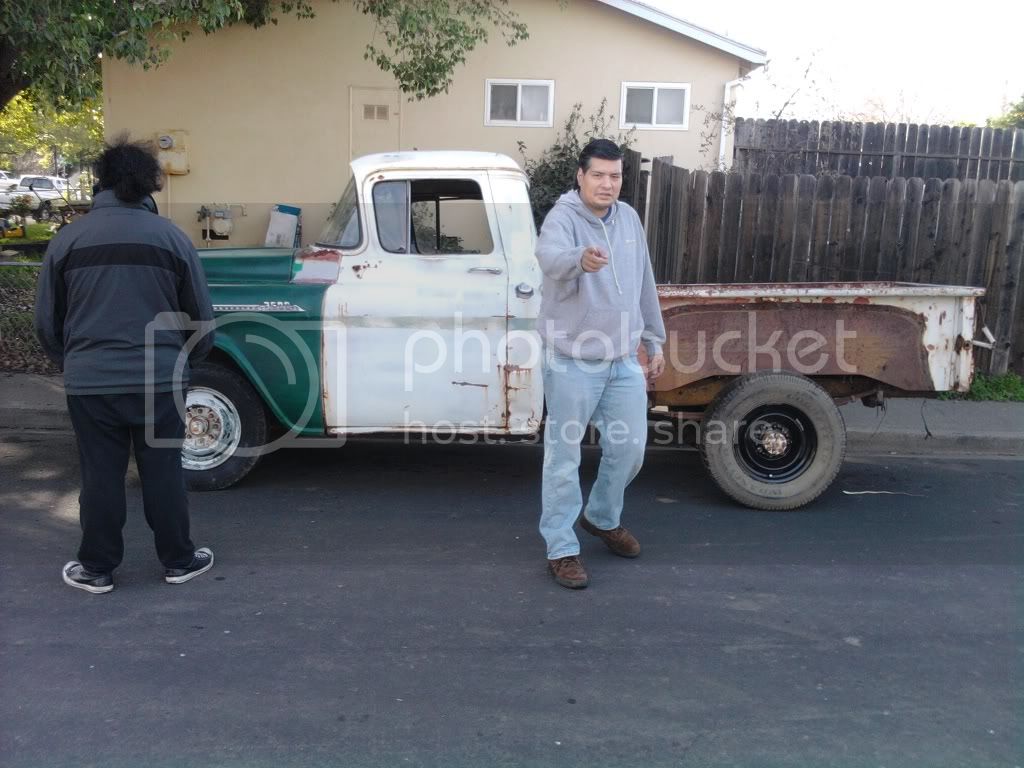

    well finally got it out of the back yard hopfully there will be more progress soon im trying to get it ready for my move to oregon so i dont have to trailer it biggest thing i need is a radiator i posted a parts wanted thread but have gotten no reponces yet anyway here are some pics from today
    my friends steve and jason helped me push the "big bitch"

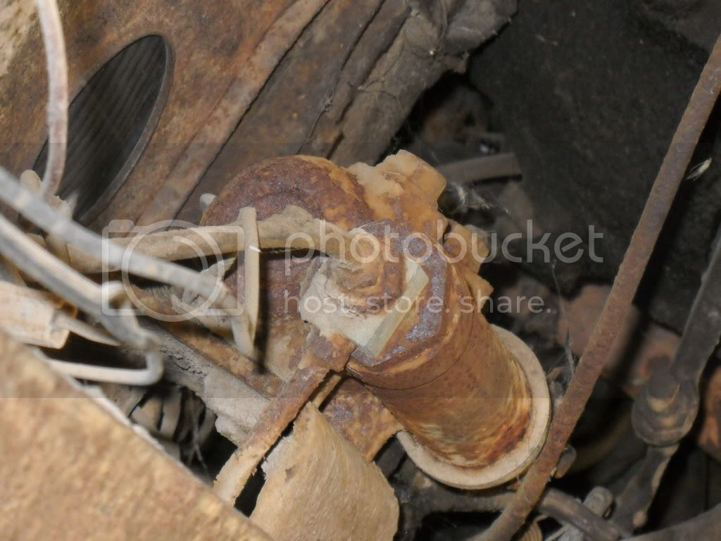

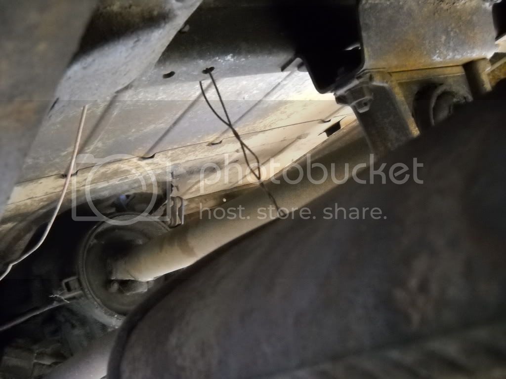

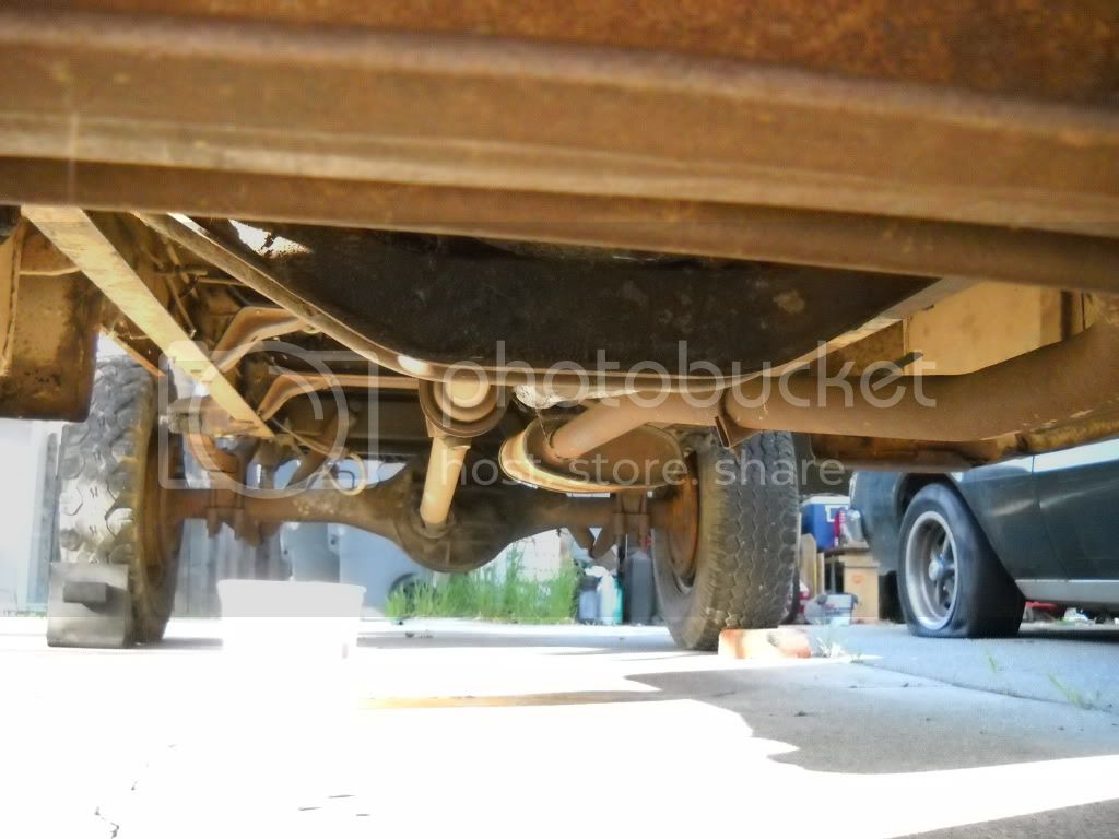

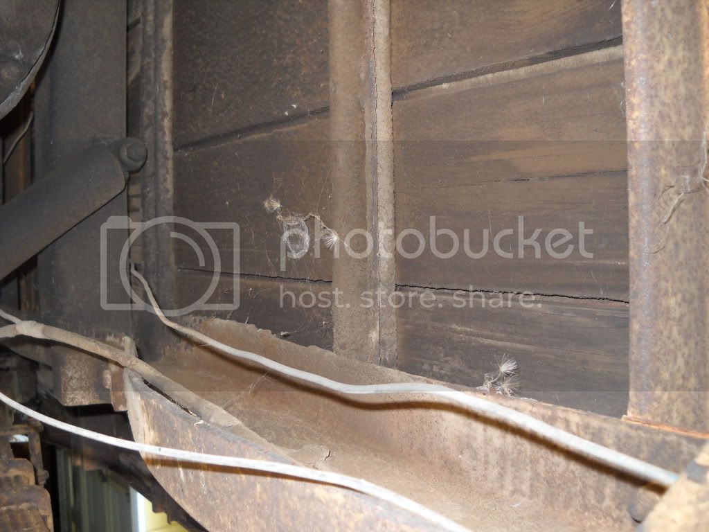

    well i did some work to her today not alot but i replaced the ballast resister and took a grease gun to every grease fitting on the ubderside of the truck ( holy hell theres alot of them) took some pics to show you guys what im dealing with
    looking from the front axle
    my "exhaust hanger" installed by a PO
    mickey mouse wiring
    master and lines that i dont want to deal with they have a nice amount of rust going on

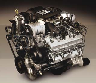

    i think ive decided on the final power plant for this i think im going to go duramax diesel it will have plenty of power for whatever i do with this thing and i can run it on french fry oil and not hurt the environment and keep money in my wallet
    Specifications
    * Engine type: 6,599 cc (402.7 cu in) V8 turbo
    * Bore x Stroke: 4.06 in (103.1 mm) x 3.90 in (99.1 mm)
    * Block / Head: Cast gray iron / Cast aluminum
    * Aspiration: Turbocharged & Intercooled
    * Valvetrain: OHV 4-V
    * Compression: 17.5:1
    * Injection: Direct; Bosch High Pressure Common-rail
    * Power / Torque: 300 bhp (220 kW) @ 3100rpm / 520 lb·ft (705 N·m) @1800 rpm
    * Source:[2]
  17. vwnate1
    11,703
    Task Force
    It looks like a good truck to me ! .
    If you go Diesel and home brew fuel , please read into it well before just pouring filtered french fry oil into it as that's what kills 99 % of the tree huggers Bio-Diesel rigs .
    There's a lot of work that needs to go into that " free fuel " or the engine WILL be ruined .
    My '84 Mercedes 300CD Diesel Sports Coupe was ruined this way by Sta. Monica nitwits , I had to re - sleeve the engine to save it .
  18. bonvo
    bonvo Member
    Mar 6, 2007
    122
    vacaville california
    ive been reading into, it i do understand that you need to buy certain equipment to do it right and the equipment ran a few grand, but other then that i havent gotten to far into it. its still a long way from that its gonna run the stock 235 till it dies (if it dies). when it comes to the diesel i see it this way, 1: cheap fuel 2:clean fuel 3: tuning a modern turbo diesel can make some insane horsepower and torque. there is no down side.
