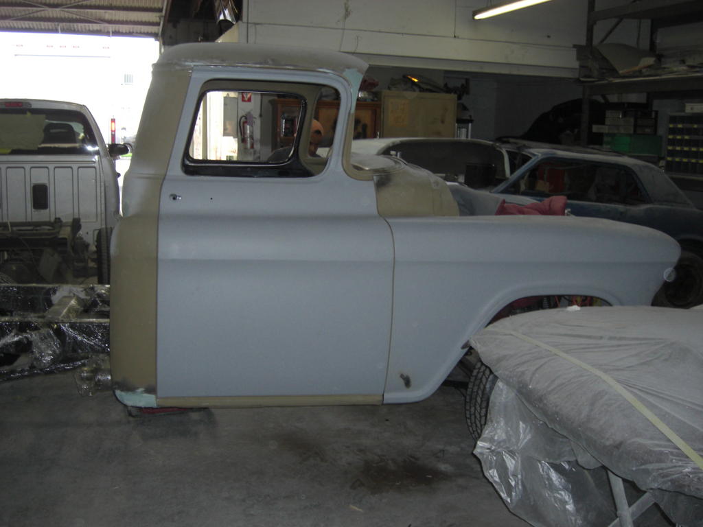

After dealing with rusted door skins myself after talking with my body shop it was more cost effective to replace the doors .The body shop wanted a little more than $300.00 a door to repair and you have to think about the time to repair and I think the body shop said 5-7 days and we all know how bodyshops can be .I replaced both doors and i'm quite happy with the fit

Replaced with complete doors .Door skins and inner panels too badly rusted and one door was twisted .Door hinges and latches fit fine .

So far everything seems to fit fine .Just a few minor adjustments.The doors are manufactured by counterpart.The only thing i noticed the bolt locations for the hinges required a 3/8-16 bolt rather than the fine thread bolt.I'm happy with how the doors are looking.Whenit comes back from the paint shop final assembly will be the big test.I'm confident everything will be fine. The truck is a Chevrolet

Sorry i mis-spelled the supplier name is counterpart.I hear OER(original equipment reproduction) is pretty good too. Yes i did fit the windows,track,wing window and door lock hardware and had no problems.I hung the doors in my garage and removed to transport. I didn't have a lot of help to get the cab on the trailer. with the preliminary work done then i gave them chassis.Now they're double checking door,hood and fender alignments.I was there today they should be ready to start blocking it by thursday.
