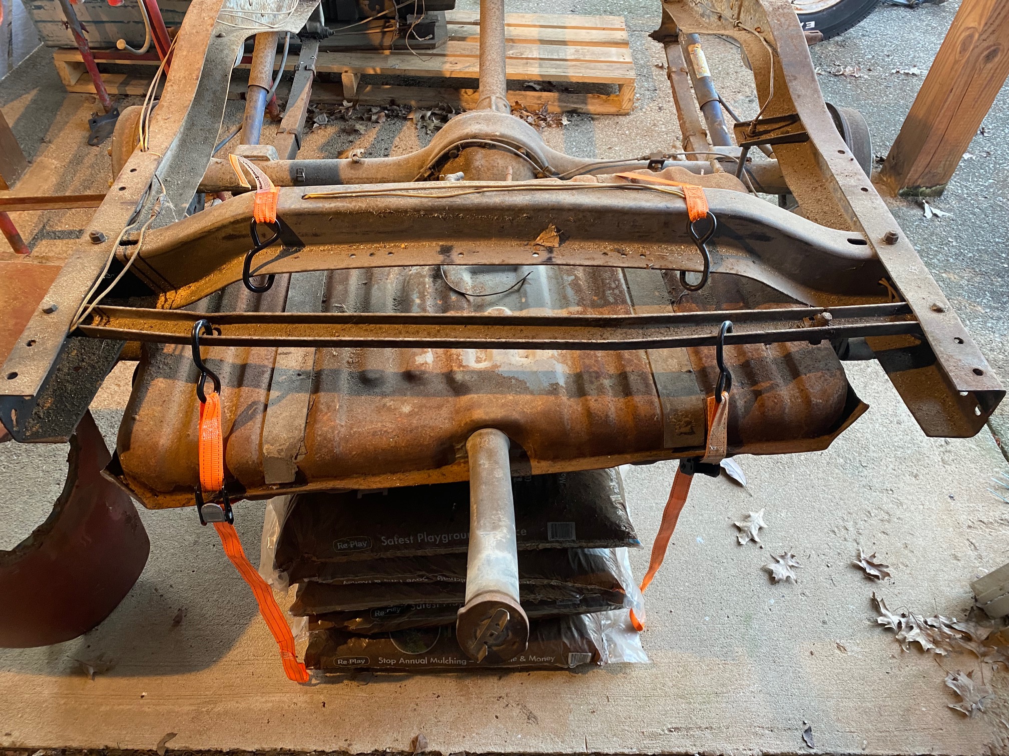

    @fantm2flyer , that tank is 70 Mustang? Tanksinc says that's 32" wide, but that must be seam to seam?
    The more I look at your pictures the better that fit seems...
    Looks like it snugs into the crossmember much better than the 71 Chevelle tank I have mocked up here.
    (And 22 gallon capacity, wowzers!!)

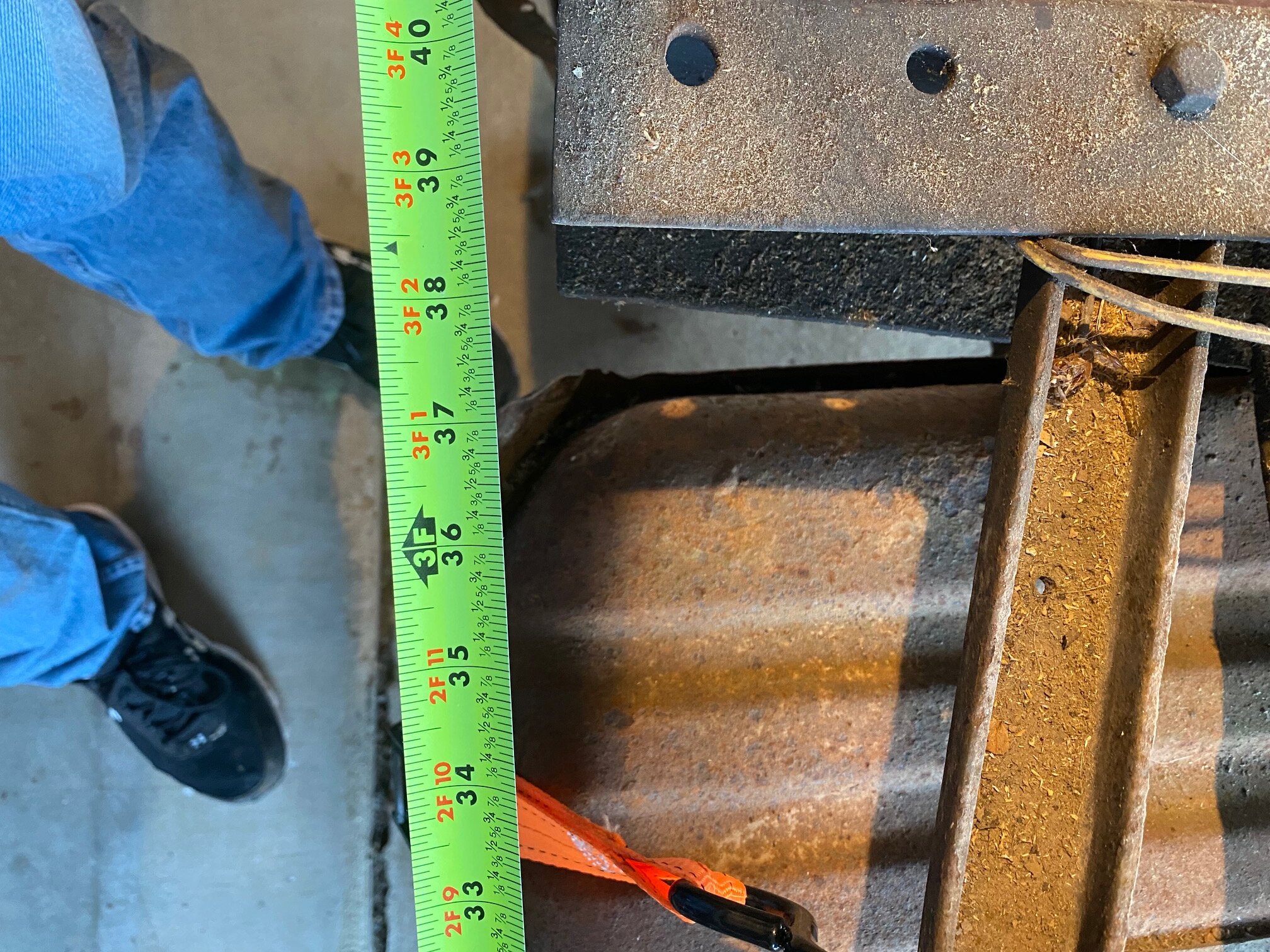

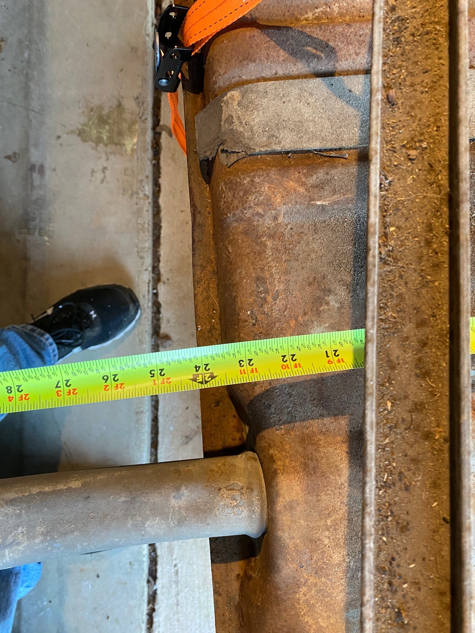

    I put a tape to my tank and it measures 32" from edge to edge. I have about a 1/2" clearance between the tank and the crossmember on both sides. I used 1" angle for the back and the sides of the support frame, and a piece of 1" square tubing across the front, and the tubing is for spacing. It let me drop the front side of the tank down and gave me some extra clearance on the crossmember. If I ever need to drop the tank, all I need to do is remove the bolts on the four corners. Tank pic from rear low.jpeg Tank pic from rear.jpeg Tank pic side.jpeg
