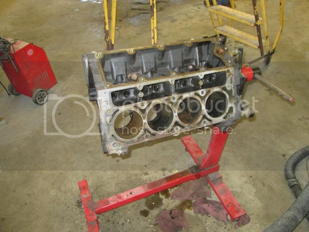

    The only other updates is that I started on my motor. My so called "good" LS motor that has been sitting on my engine stand for a while is actually no good. The seller didn't tell me he left it outside so the rain went in the intake and filled the cylinders. Anyway, its all full of rust and I need to do a full rebuild on it but atleast I'll have a new motor now.

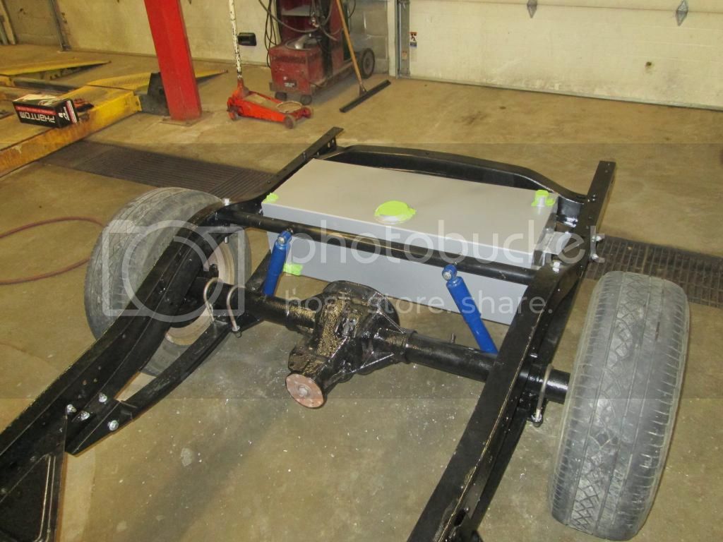

    Sorry about your trouble with the engine. What is the story on that 4L60E? Also, what brand of fuel tank are you using? I would like some pictures of the tank install, with measurements.

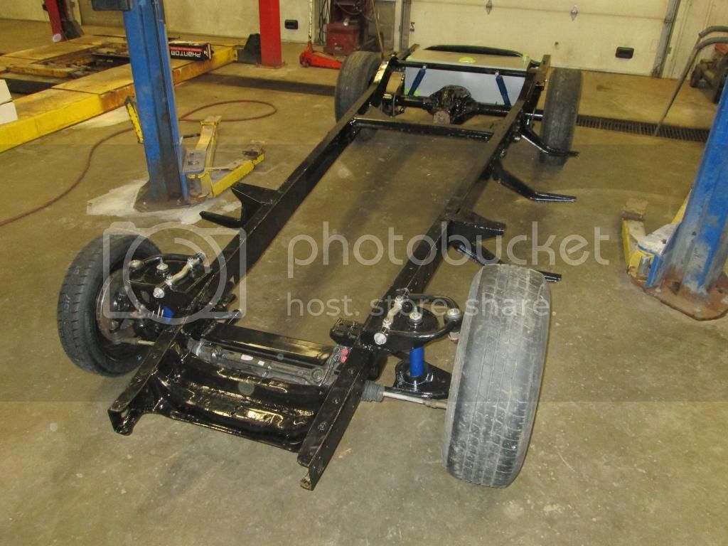

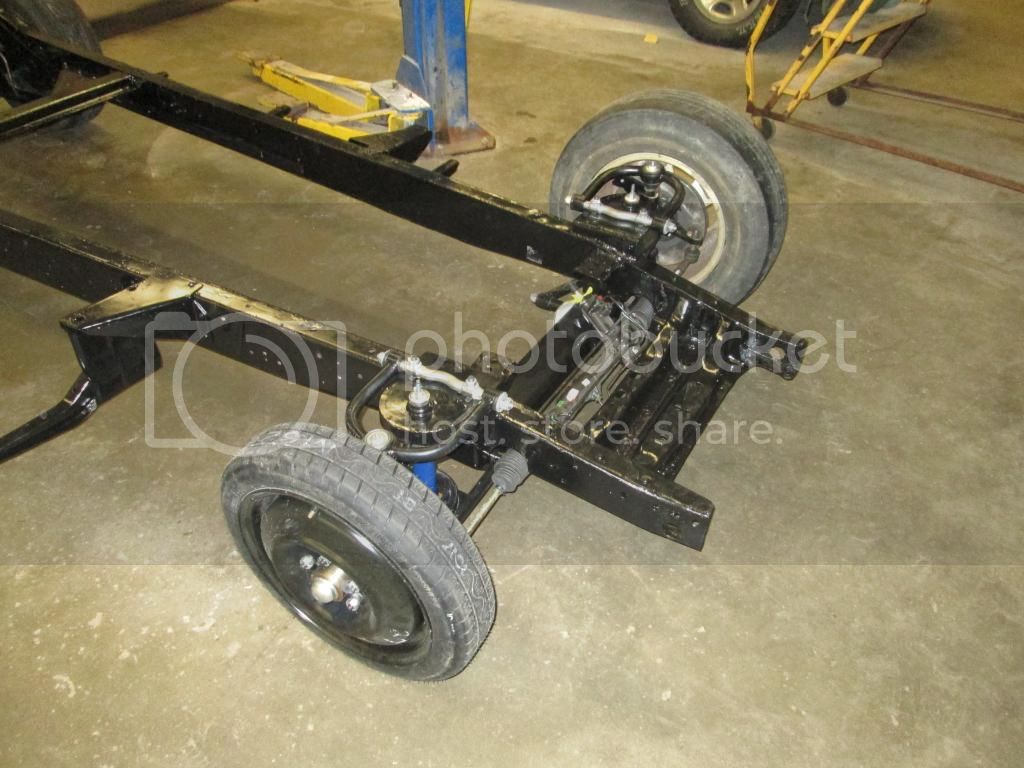

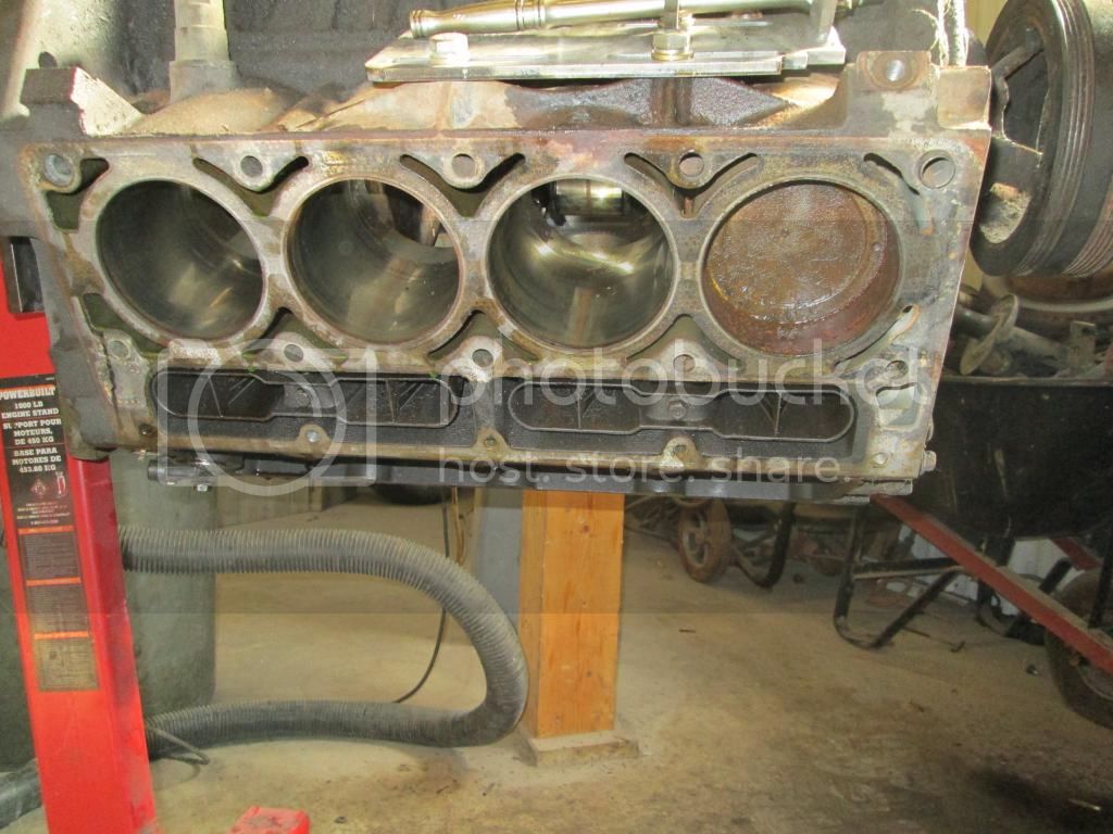

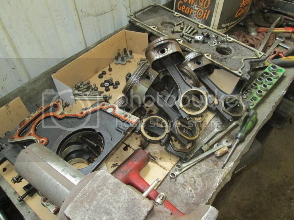

    The last two days have been productive. I got the 5.3 tore down and ready to go to the machine shop. The #2 piston was stuck but I got it out. I will need to have it bored .030 over. There was so much carbon in there that all 16 lifters were stuck. They needed gentile tapping to come out but they were not moving. The cam looked good but I saw a small scratch on one of the rotating surfaces. It was a hairline scratch that I could barely feel with my finger nail. My dad says it will be fine but I am not sure. What do you guys think. Below are some pics of the engine tear down and some of the finished chassis.
    I got my suspension all back on the painted frame and my fuel tank mounted. I have the aeromotive phantom fuel system for the fuel pump but I didn't have the 3.25 inch hole saw so it has to wait. I will have to pull the front suspension back off when the truck is done because the springs will need trimmed but that can't happen until the full weight of the truck is there.
    You may also notice that I have a donut tire on the front. That's because I had two of my wheels outside and someone stole one. The donut is all I had.

    The frame looks very nice but kinda willowy ~ what will prevent it from twisting in normal driving ? .

    Willowy? I have no idea what that means. The frame is plenty strong for regular driving with a stock 5.3. Its not going to be some high powered street machine. Its just going to be a driver for cruising.
    The engine spun fine when I bought it but then it sat in my garage another year with the water in the cylinders. I brought it home and put it on the stand not knowing it had water in there so it kept rusting. It was unfortunate but things happen some times. I gave only $300 for it with the harness and computer so I wasn't out much when you look at the price of those parts. I just have to build it which I wasn't expecting. I could have bought a new motor but this way I will have a like new one. I was just asking questions because I don't want to waste money by buying parts I don't need to. I've also never heard of someone only boring one cylinder but the machinist I have will do them all.

    What kind of measurements were you looking for? The Brother's tank is pretty big as you can see in the pics but it fits without messing with the rear cross member, its just really close to it. The mounting tabs are angled when it mounts to the frame so it places it in one spot because of the angle of the frame rail. I am pretty happy with the tank. On the passenger side there is a piece riveted to the frame that I think was to hold the brake line. I had to remove that but it was one rivet.

    willowy...
    The way I would define "willowy" is as follows, something flimsy, flexable, as in the branches of a willow tree. Used to be great fun to find one, strip the small branches off and whip the you know what out of your brother or any other antagonist. Unfortunately, sometimes his size would trump my speed, and the result was not real good.
    In this case, I think Nate failed to notice you have boxed your frame, it is hard to see with all that shiny black paint.
    The measurements I was looking for are basically visible in your picture. The new fuel tank has enough room for the shock x-member. Mine measures 15" from the front of the x-member to the upper shock bolts. I'm also curious about how far it hangs down. I've been looking at a No Limit alum. tank, with provision for internal fuel pump. They run between $500-$600, however. :(

    Yes , I had enlarged the photos thinking maybe it was a boxed frame but couldn't tell .
    Boxing is great , forget I asked .

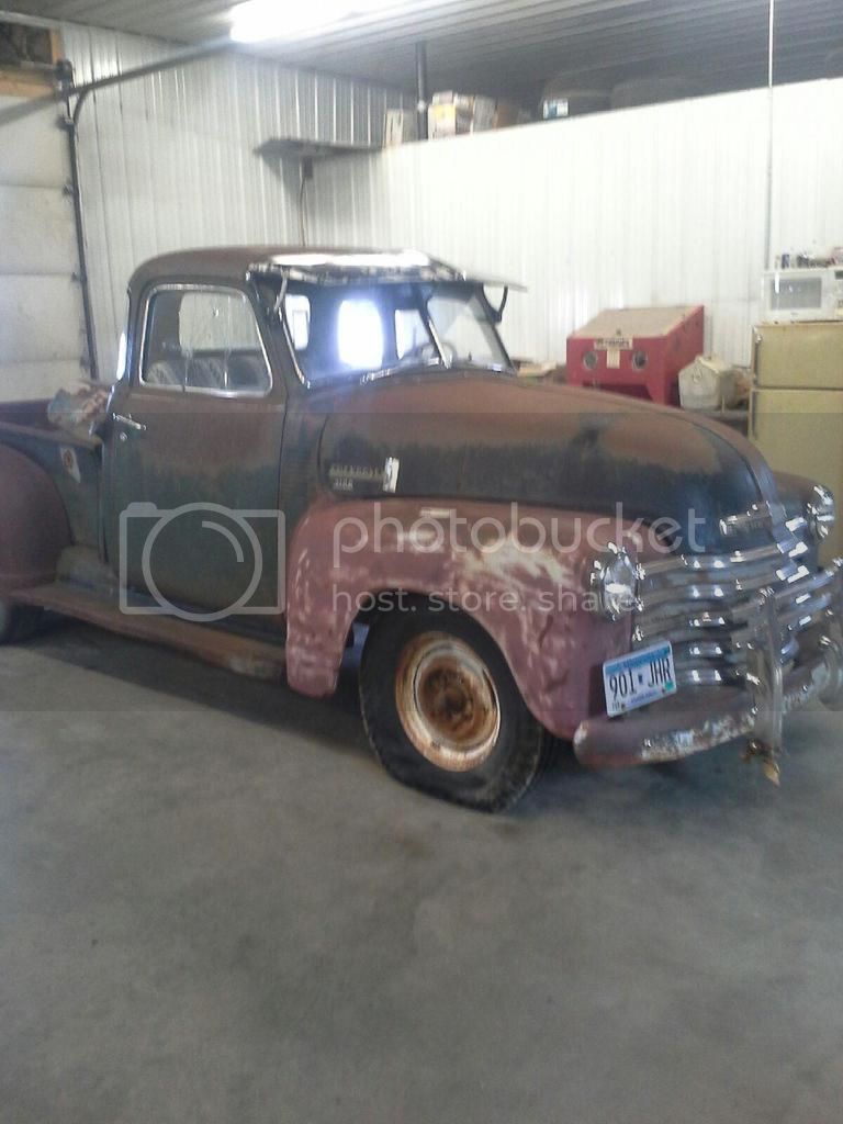

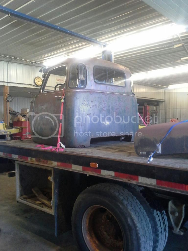

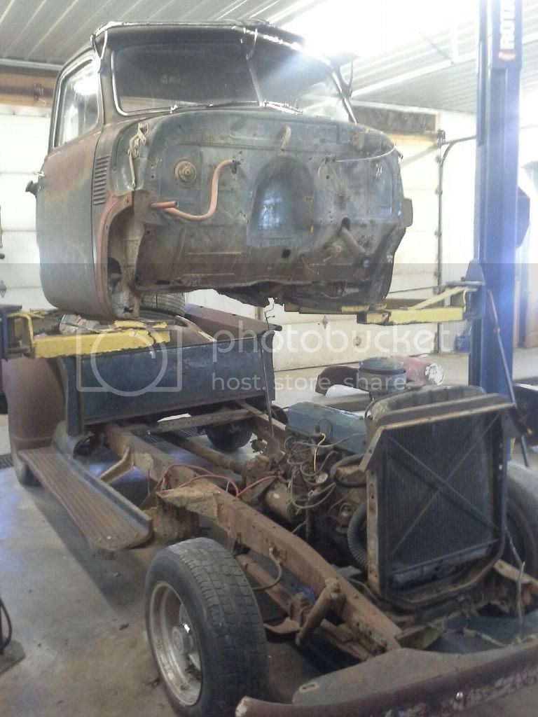

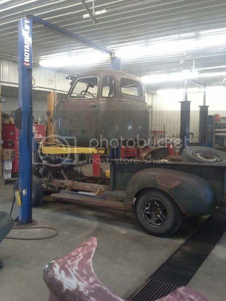

    Well I have made no progress because I haven't been able to make it up to my Dad's house to work on the truck any more. The engine is at the machine shop now so I am waiting on parts to come back. In the mean time my dad's repair shop got slow so they drug my truck in and tore it down. When I go up there next time I still have to gut the cab but then it and the front clip can head to media blast.
    I won't be using this frame since I built the other one but this one is in great shape. I hope I can find someone in need of a good short bed frame. I'd hate to scrap it.
    Here are some pics.
    Lifts make it easy :)

    You need to turn that right front tire over. It is flat on the bottom.

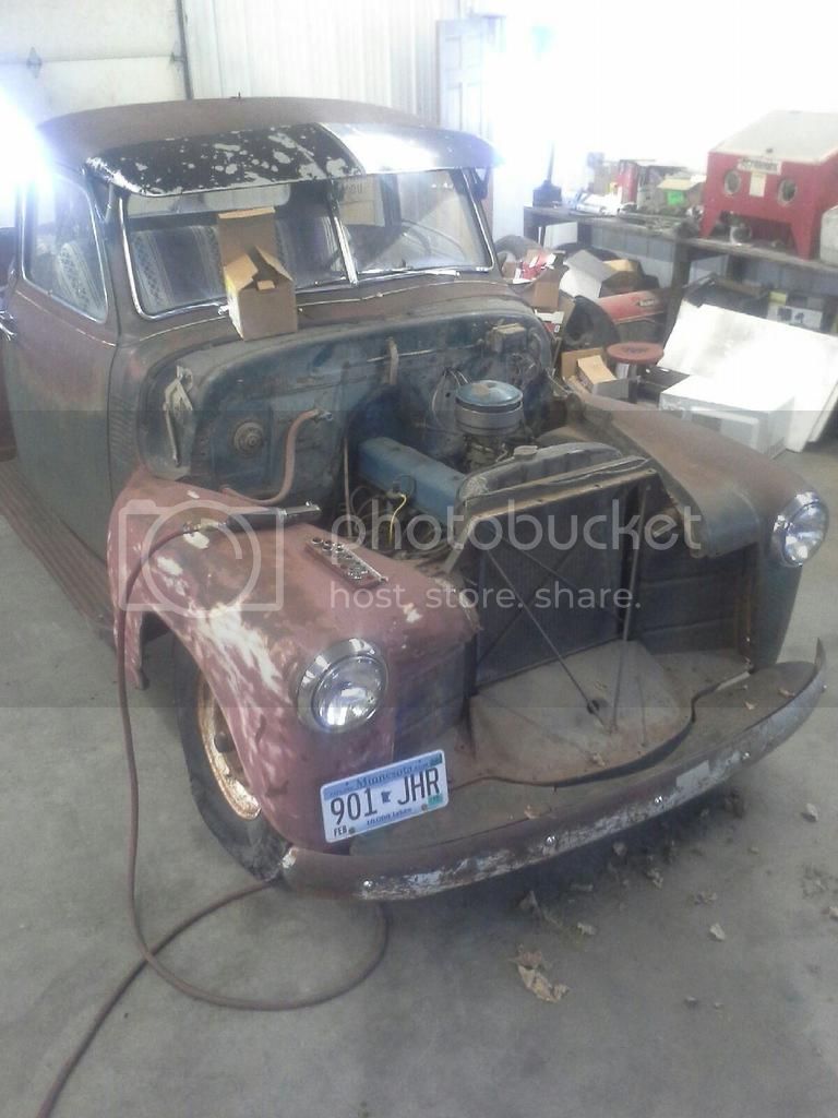

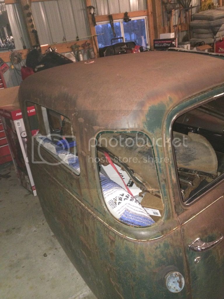

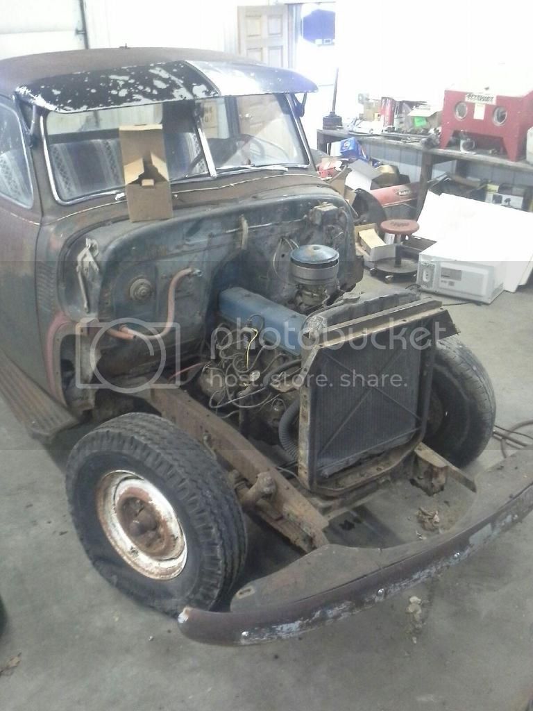

    I had to go up north for a wedding but was able to get in a few hours on my cab. I pulled the windshield and 3 rear windows. One of the corner glass was nice enough to keep but the other was badly scratched. My cab is in better shape than I thought. The floor has the typical rust, needs cab corners, and the passenger cowl is damaged. I was happy to find that my window channels were all solid, I expected the typical rust in the lower windshield corners but was presently surprised. Here are a few pics to accompany the post and I was able to get a picture of the carnage to the original engine. There are holes on both sides of the block but I only took a picture of the big hole.
    Other than that I have just been ordering parts.

    That cab does look pretty good. No rust at all in the front fender mounting flange area.

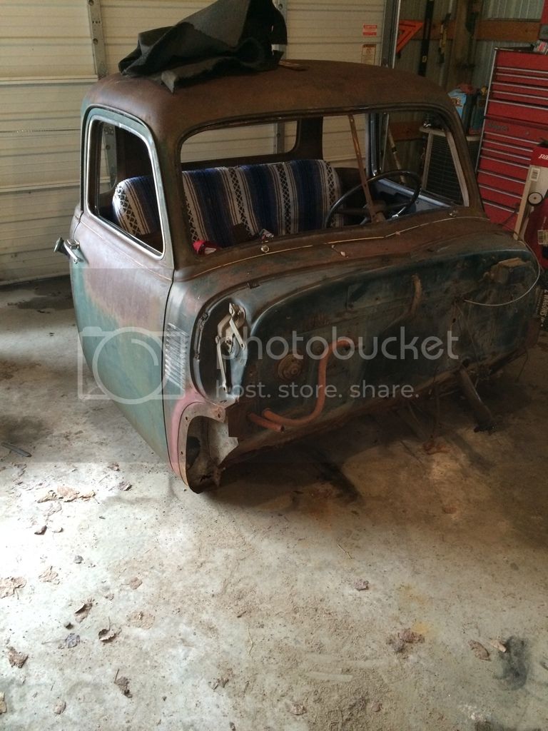

    So I have been really good at slacking on my project. I still have my truck stored at my fathers house 4 hours away because he has alot of tools I need that I don't have. Because of that I don't get alot of time to work on the truck. Once the motor, transmission, and cab are on the finished frame its coming home. I have the frame mostly done, I haven't put in the fuel system yet (sorry Steve still no pump installed, its on the shelf wating for me to do at home). the machine shop that had my motor went out of buisness and the owner said he would just finish it for me on the side. That took over 6 months. Then I took time off to work on it and my grand mother died. The next month I tried again and found that the machine shop had lost a main cap bolt and it was sunday... Well, This weekend I finally got someplace. I think one or two more trips up there and I can bring it home.
    A picture of the cab sitting back on the frame.
    Some engine progress. I wasn't going to cut corners so I got a new cam, new pistons, and new lifters.. Plus alot more. I am going to polish that front cover later when the truck is home. I didn't have the locating dowels so the heads aren't on yet.
