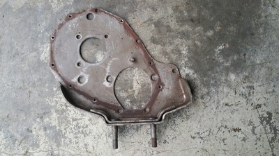

    Looks like what I'm missing is a bracket to go from the bolt holes in the sides, down under the front of the oil pan.
    This picture was lifted from a vendor's website (selling alternator brackets) - I have a call in to them to see if they happen to have a mount bracket available.
    Oddly enough, the motor came with the alternator bracket, but not the front engine mount bracket.
    Any of you GMC guys have a spare, or know someone who might?

    The stock front mount you are looking for is U shaped with a center bolt in the bottom that attaches to a rubber front motor that sits on a cross member. May not match your '51 frame. I'm not positive, but I think this mount would also work.
    It should work with any 228/236/248/256/270/302 GMC as well as some 216/235 Chevy engines and mate up to your frame & front motor mount.
    If this won't do and if you'll guarantee the 302, I'll swap my good running 228 with a stock front mount only charging you my labor costs. :D
    RidesWithYah likes this.

    Thanks Bill,
    I'm really hoping I can scare up one of the U-shaped "saddle" mounts so that I don't have to swap the front plate.
    I don't want to pull the front of the motor apart and pull the cam unless I *really* need to -
    Either way, I'll need a hole or two about 1 7/8" further forward than my Chevy mount to accommodate the longer GMC block.
    Not sure whether I can just drill my existing cross member, or if I'll have to fab up an adapter plate of some kind.
    I also have a crossmember out of a GMC truck, but not sure swapping that in is the best route.
    I would need to drill out the existing rivets and replace with bolts - maybe a couple of spot welds for added rigidity.

    I found a U-shaped mount on another board, so I'm set there.
    Thanks for the offer, though, Bill - much appreciated!
    The mount has a single center bolt to mount to the frame.
    If it is in the same position relative to the block as the Chevy, it will be 1 7/8" further forward than my two stock mounting holes.
    So I will need to figure out how to adapt it, without changing the height of the nose of the motor.
    I'm sure there's a way, just haven't thought about it much yet.
