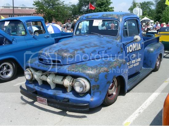

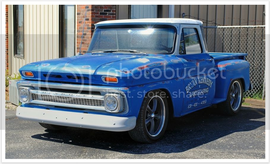

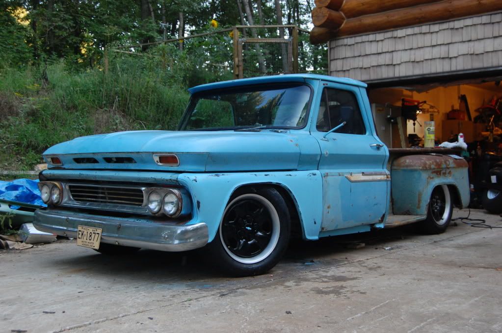

    What you've been doing with you're truck has been leaning me to something similar to these:
    I hope to accomplish it with a little different method.
    I already have all I need for SPI grey epoxy primer.
    I'll take a part down and get it some coats of epoxy on it.
    Then make any necessary repairs.
    Get a few more good coats of grey epoxy, and then two or three of black epoxy.
    Now the truck is preserved and protected.
    Then I'm going to put good ol' enamel - (blue) - quickly over the whole truck.
    I'm not really going to concern myself too much with this coat, because I want it to feel free to wear off wherever it wants.
    I don't know..
    Maybe I'll go a different direction when I get to that point. :D
    I do know that first truck is my ideal.
