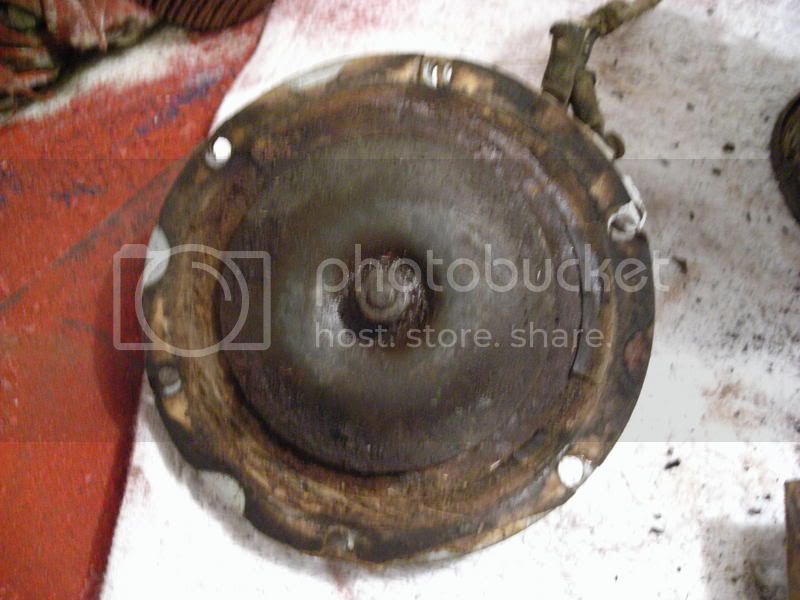

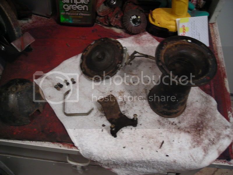

    ok, took apart the horn i have. it wasn't actually on the truck, it was a junkyard find, so i'm not sure if it actually works or not. you guys have any suggestions for me? i don't think my truck had a horn originally, so other than a relay, i'm not sure what sort of stuff is required. thanks!!
    jon
    also... pretty rusty there in the last picture. only on the speaker side, though. would that affect the way it works? should i try to dissasemble any further? and how? i'm kinda stuck. thanks!!

  2. vwnate1
    11,692
    Horn Service Notes
    Stop now and begin to wire brush the diaphram and bell etc.
    When it's all nice and clean , re-paint it gloss black with RustOleum paint , no primer .
    Adjust the horn as follows : connect a 6 volt battery across the terminals in series with a test light , loosen the locknut and slack the points adjuster screw untill the light goes out ~ now _gently_ tighen it until the light just comes back on and hold it there whilst you snug up the locknut .
    Mount the horn firmly in a vise or bolt it to the intake manifold and apply power to one lead and ground the othere ~ it should begin to toot , leaving it connected adjust the points screw to the _loudest_ toot , this is very important .
    Be aware you _cannot_ possibly adjust the horn unless it is -solidly- bolted to a large heavy object .
    Be aware the adjustment screw is very delicate and 2 turns can wreck the horn beyond repair .
    Most of the time I find that cleaning the points and re-adjusting will bring a dead horn back to life .
    Early trucks didn't have horn relays but it's wise to add one .
    Your old 6 volt horn will last forever on 12 volts unless you like to lean on it for long periods .
    I hope this helped , I LOVE horns and drive my son crazy by buying every single $1.00 one I find @ swap meets and prying them off long dead derilict vehicles we find in the desert... :D

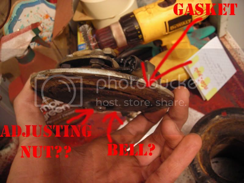

    ok, i'll need a little clarification on what the locknut, points adjuster screw, diaphragm and bell are, if you please. i'll check to see if there is a diagram in the assembly manual book. thanks!!

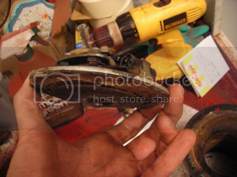

    can i ask why no primer? also, there is a gasket between the cone shaped part and the actual working parts (i guess that's the bell?) just wondering if i can rip it out to clean it better. can a new one be made? i imagine you can't just buy something like that, right? thanks!

    What you're calling the bell is the diaphram . the locknut and adjusting screw is in the middle . some years have a seperate adjuster right on the contact points .
    The gasket is important as it keep water out of the guts , make a new one out of medium thickness gasket paper .
    No primer as it'll make the paint chip off .

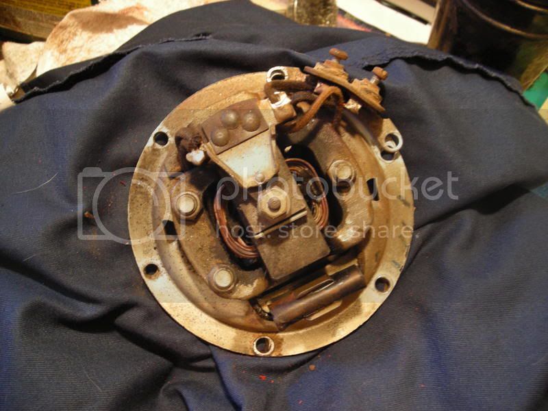

    Look on the backsdie of the horn ~ you've so far not posted pix of the contact ponts , usually cleaning them will return it to service .
    Steve , if possible , remove the cover and look at the points ~ carefully slide some lint free paper (business cards) through the points untill it comes out clean then power it up .

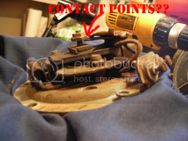

    more pictures
    you guys are awesome!! this is why i love working on my truck. "get the screwdriver!! the BIG ONE!!" ha! ok, so we've got the bell, which is the cone-shaped megaphone thingie, right? and the diaphragm, which is the speaker-looking thing inside the cone, and then the adjusting screw and nut which are right in the middle of the diaphragm, and the contact points which are somewheres on the backside of the diaphragm.
    man, i could have sworn i put some pictures of the back of this horn up here, but i guess not. anyway- here goes-
    i'm guessing this is the contact point you're referring to??
    jon
  12. vwnate1
    11,692
    That's It !
    Yes Jon ~ those are they and you can see the two nuts and screw , adjust those , not the one in the middle of the diaphram .
    You might have to clean the points bit if they don't have continuity ~ test with your test light (NOT a meter !) and if the light lights , try adjusting the points as I wrote above .
    I wrecked a few horns before I learned ow to do this so don't be askeert to try it ~ there's still plenty of old horns out there and most can be fixed .
