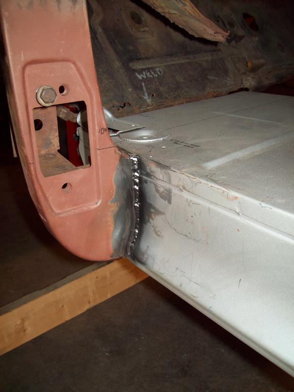

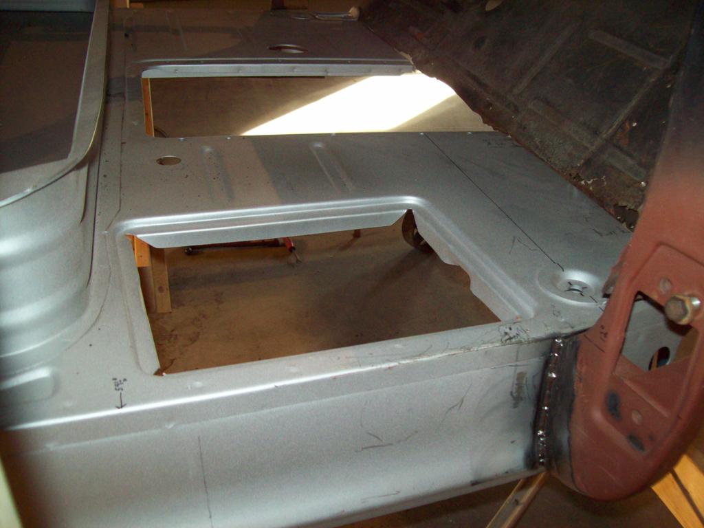

    First picture shows the gap I have between the inner, and the inner to outer panels. The inner to outer is lined up with the hole in the rocker panel. This may be my real issue, as it looks like the door pillar might have been re-welded at some point. In the second picture, you can see that the inner panel matches the curve of the door pillar, but it appears to me like it sits about 3/4'' to high. Does anyone have a close up of where the door pillar meets the rocker so I could check that?

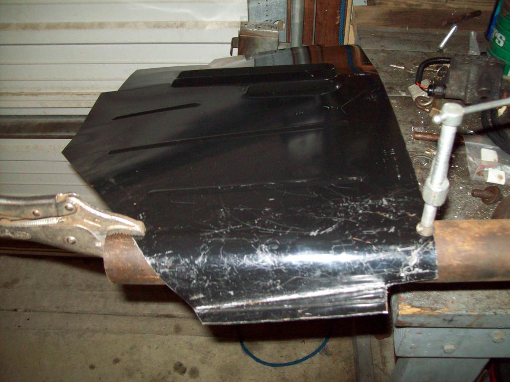

    Rusty Dog, the radious at the hinge pillar should be alot "shallower" than the radious at the toeboard. I had to re-work the "kick" panels quite alot to get them to fit. The only pic I could find to show what I did may help explain some....
    Also, I notice your inner/outer cowl panel is too low as the relief areas are not matching the ribs in the "kick" panel. Mine eventually matched up, but not perfect. The top "rib" just barely fell inside the relief, was almost too high.
    I know, this is about as clear as mud...
    Oh, yeah, the china made "kick" panels are heavier gauge than the originals, believe it or not.

    I see what you did there. I was wondering how the floor was going to line up as the panel was basically straight. You just added another dimension to my issue. Now it is in 3-D format:) top to bottom, inside to outside, and now the floor.
    When you say the inner / outer panel is too low, this is what makes me think my rocker panel is out of place. I have figured out the doors are not original, so it is possible that when they changed the doors that they replaced the door pillars as well. Does anyone know if the inside arch at the bottom should be flush to the floor? I have about a 3/4 " rise from the floor.

    Rusty Dog, the inside arch should radious right to the top of the floor, flush.
    As far as replacing the door pillars, yes, but most likely they may have only replaced the lower 8- 12". You should be able to see the weld seams on the back side.
    Any work on or replacement of door pillars is critical work, and if you think they have been altered, you really need to check dimensions carefully. Eveything has to be right or your doors may not fit correctly. The factory assembly manual avail. from our host gives all the cab welding dimensions.
    DOZX, this would give you your answers also.
    Rusty Dog, I had to pie-cut both inner to outer cowl panels in two places to get them to suit me
