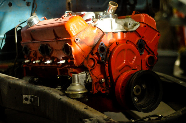

Motor is now out and I have started stripping the leaf springs mounts and my old motor mounts.

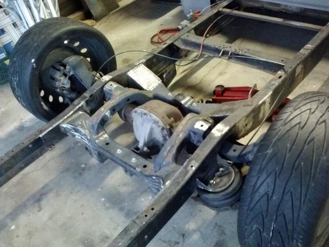

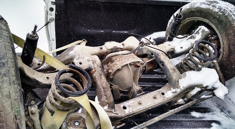

What donor car did the irs come out of looks pretty cool and real cool installed and painted.
between you and Phil your irs and ifs builds are sweet and amazing skills as well
You guys should make your bed floors lift up so the rear of your framework can be seen

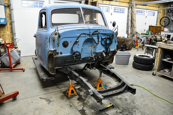

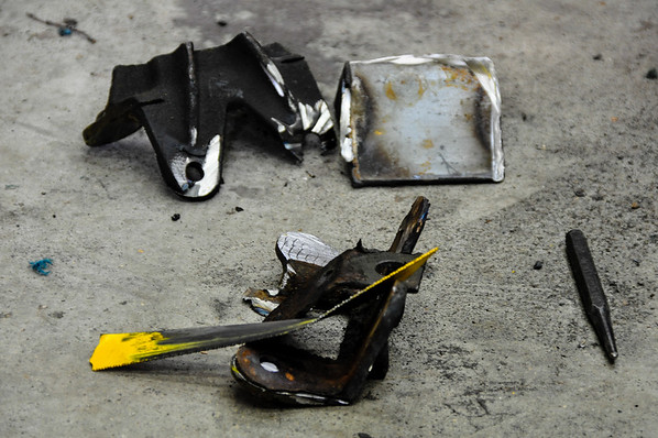

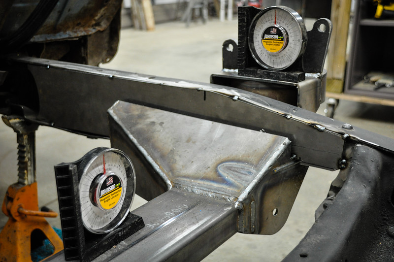

Did get some time in the shop today, but did not get near enough done. The frame was totally stripped. Those rivets are a pain in the ass. Most came out by cutting the head off with a skinny wheel and a punch. Some others required more persuasion.

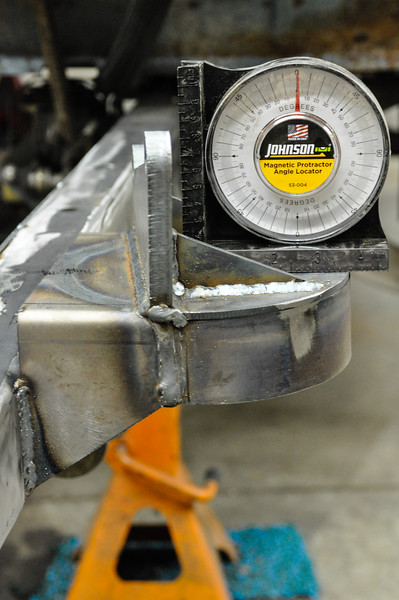

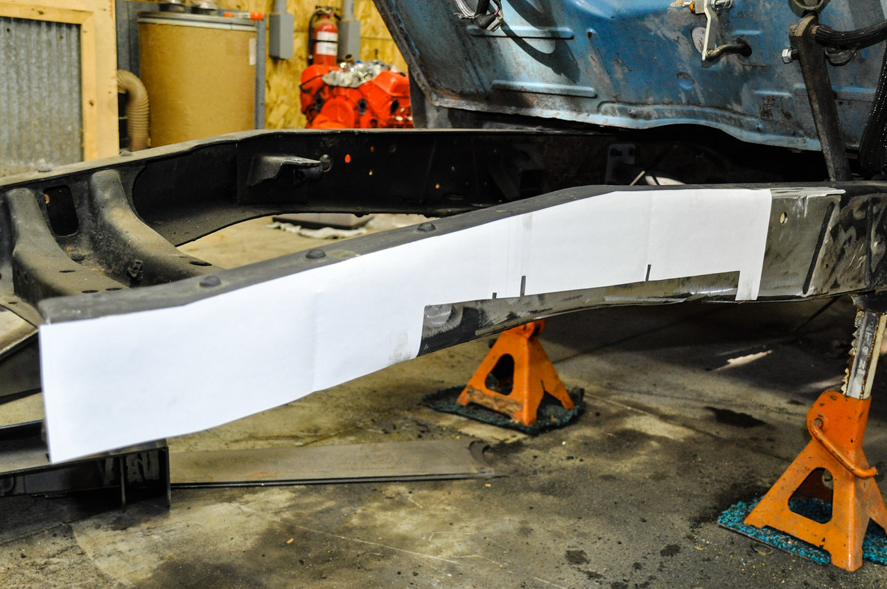

Layout of the 1.5" notch that Scott suggested for the ride height I was looking for.
I did read the instructions....

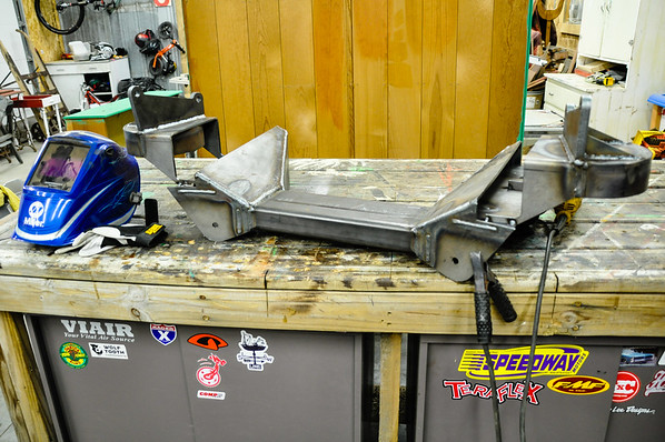

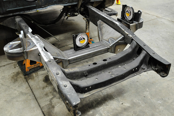

After measuring.....then measuring again, checking the level, then measuring again.....I finally go the cross member tack in.
Should be able to finish up the welding on the top half this weekend if all goes right. I then will mock up the motor and see if I can use the existing transmission cross member, or if that will need to be moved or modified. Hoping I do not have to modify my floor to clear my transmission. One I get that all done the can will come off and I will flip the frame to do the welding underneath.
That is an excellent looking crossmember. Lots of positive caster built in, it appears way more than my Fatman kit. Between the front and rear conversions you've chosen, Henry should handle like a sports car.
I'm guessing you will have to mount the engine a little higher, and therefore, modify your floorboard. I had to, with my "LS" engine/4L60E.
