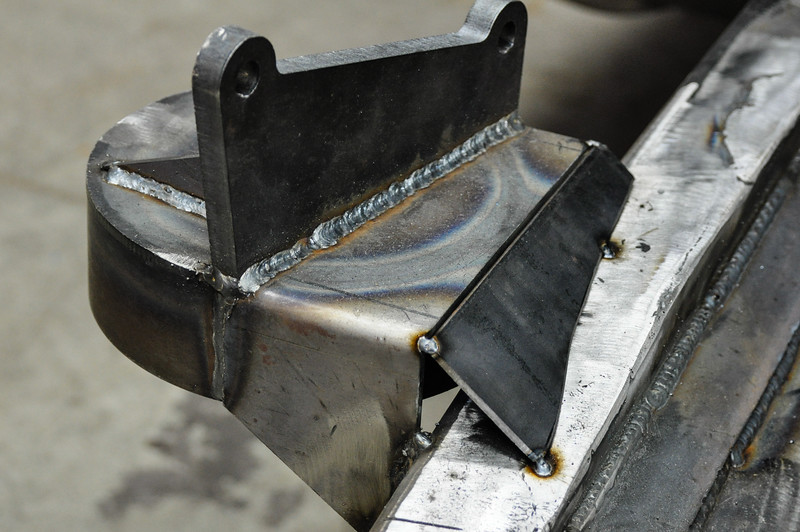

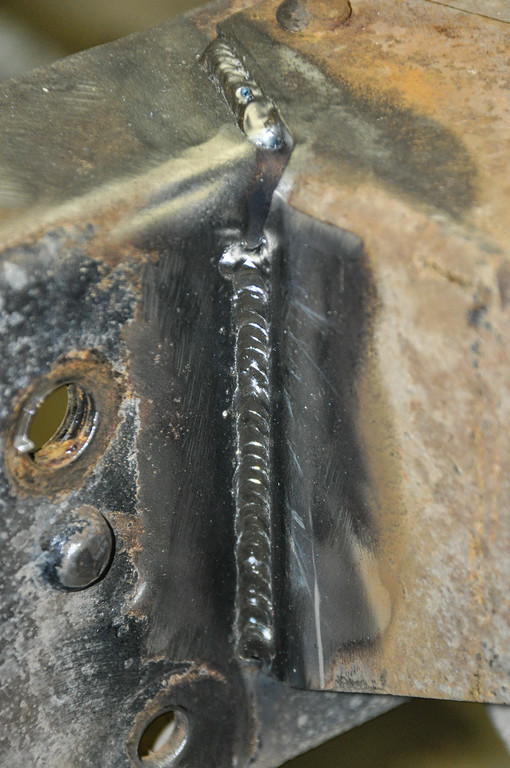

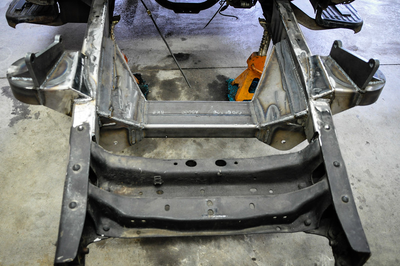

    I had a couple hours available today and was able to button up most of the install cross member today!!
    Next step is to pull off the cab and flip the frame and finish up the welding on the bottom side.

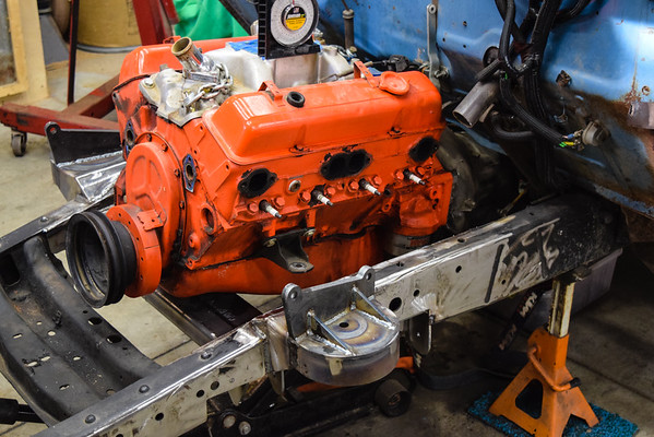

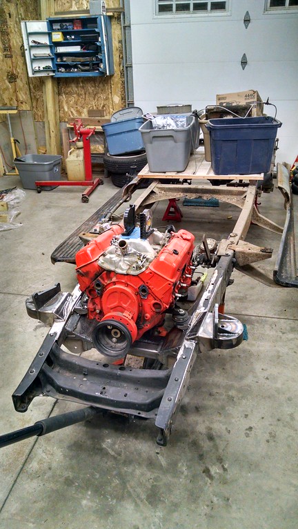

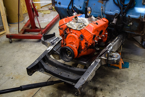

    Stellar day in the shop today. Started out with some welding lesson's for my oldest son Ryder. He showed a ton of interest, so I figured might as well get him comfortable with the machines. Got the hang of it real quick. He welded up a bunch of scrap for the fun of it.

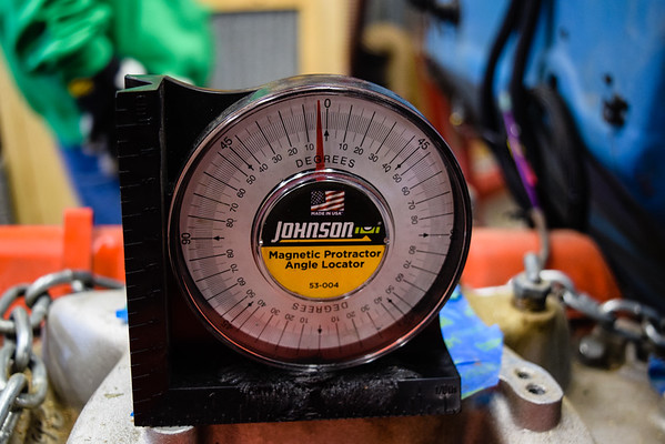

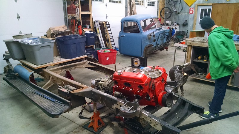

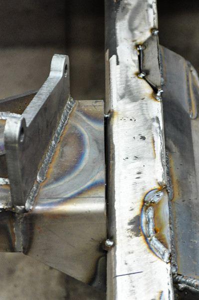

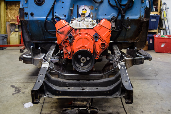

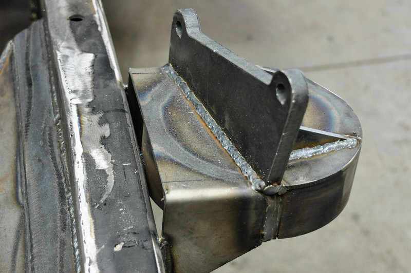

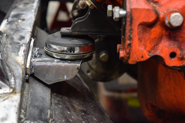

    After that Ryder helped my get the motor back in place so I could figure out what I needed to do for motor mounts. Sure if a lot easier placing that motor and tranny with an extra set of hands.
    I used a set of Chassis Engineering Motor Mounts when I originally installed the SBC. I was hoping to reuse them.
    Engine Mounting Kit, 1958-up SB Chevy into 1940-1954 Chevy & GMC 1/2 Ton Pick-up
    I was concerned about the placement of the motor above the cross member. Sure looked like the motor would be placed higher and I was nervous about having to modify the floor of the cab to make room for the transmission. Once we got the motor and tranny in place It looked a lot better.
    I modified the motor mounts and motor placement is about 1/4" higher than it was before. The intake is sitting at about 3-4 degrees without the full weight of the motor on the mounts. I think the full weight of the motor on the mounts will get me within the 2-3 degree spec. If it does not work, all it will take is a small spacer between the transmission and the cross member to get where I need to be.
    The next step is the pull the motor again and final weld the motor mounts. After that the cab will get pulled and I will start on install the rear IRS.

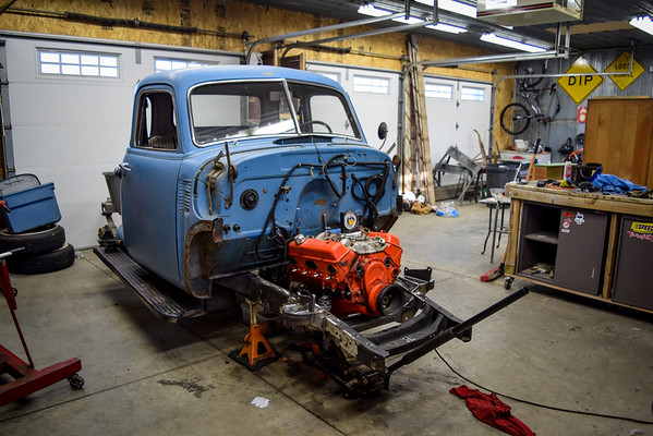

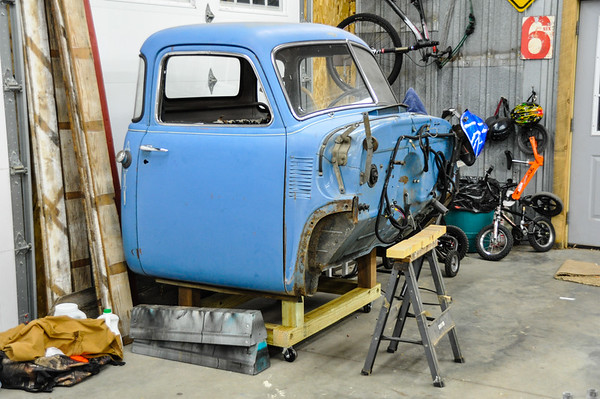

    Had a spare 30 minutes tonight before supper tonight......Just enough time to finish pulling the cab.
  6. Guest5979
    Guest5979 Guest
    Feb 18, 2007
    821
    That's how I took my cab off with the cherry picker by myself wiggles around a lot
    Mine kept on trying to do a nose dive

    Spent a couple hours in the shop tonight with both my boys. A little added help is always nice and it gets them out of their mom's hair so that is a bonus.
    We build a cart for the cab and tucked it away for later.

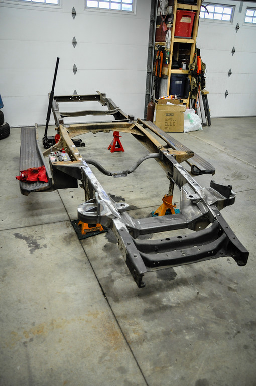

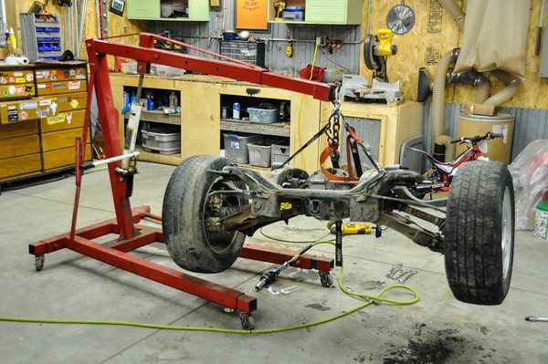

    Spent the last day of 2015 in the garage. A local guy building a truck bought my rear end and suspension so I spent a good part of today cutting that all off the truck. 6 skinny wheels and a couple sawzall blades later it is ready for him to pickup!!
    After that I button up a couple easy welds on the cross member install that I could not get to with the cap in place.

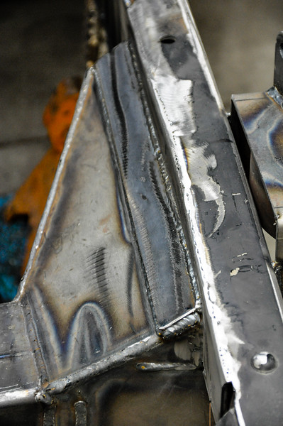

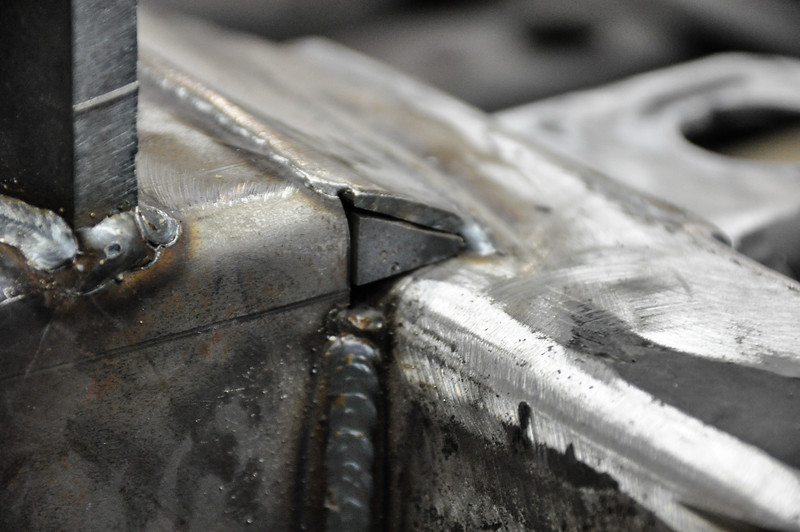

    I had decided to weld all the cross members and cab mounts in place even though the rivets seem tight. I also started welding shut some holes in the frame.
    After that a thorough clean up so I can start out the new year right.
    I am dreading wire wheeling this frame before paint.....but I am too damn cheap to pay to have it sand blasted.......

    Nothing huge accomplished the last couple days. I kind of butchered the relief for the rack and pinion, so I worked last night to close that up neatly. Use some 4" pipe and some 1/8" flat plate. 4" holesaw was also used......damn I need a Plasma Cutter.
    I drug the frame outside today and cleaned up all the loose rust and buildup on it. It is almost ready for paint.

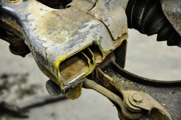

    Tonight I drug my Thunderbird IRS into the shop and started getting it ready for install.

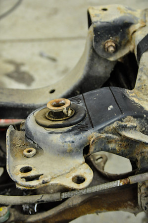

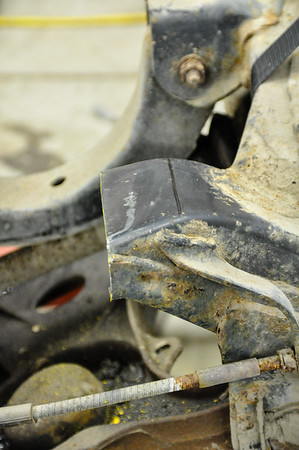

    The front mounts were trimmed off and will be boxed in.
    Inside to inside on my boxed frame is 31". I trimmed the back mounts on the IRS to 31".
